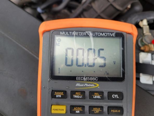

If you have a DVOM, you can test the diodes in your vehicles alternator without removing the alternator from the car.
Set up DVOM for 0-20vDC (preferred) or auto range feature--connect black lead to ground, red lead to the large "red" wire at the back of the alternator (best) or battery positive.
Start engine (run about 1500 RPM) and monitor charging voltage-- should be in 13.5-15.5 vDC range --turn the head lights on (load on charging system)--voltage should drop quickly and then return very, very close to the voltage before placing the load on the charging system. (verifies proper operation of voltage regulator in charging system/alternator)
To test the diodes---run engine at 1500 RPM, no load on engine (lead set up as stated above)
Turn function dial on DVOM to AC volts-the DVOM should read in the 0.03 to 0.10 vAC range. (load off) (See photo as an example). It may take 30 seconds to a couple of minutes for the AC reading to “settle down”, especially if using the ‘auto ranging’ feature of your DVOM.
The reading displayed is the alternator “ripple” voltage. Look for stable/steady readings.
Test with a “load on” as described above. Allow another 30 seconds to couple of minutes for reading/s to settle down. The DVOM reading should increase as higher “load” on alternator.
Naturally, if the battery is low on charge the alternator ‘ripple’ voltage will increase as the alternator is under load.
If the alternator has defective diode/s—AC voltage will be much higher than this reading and never “settle down” (jumping very low to very high—load or no load)
For “practice” would suggest testing on a known “good vehicle” to verify settings and results on your DVOM as each operates slightly different.
