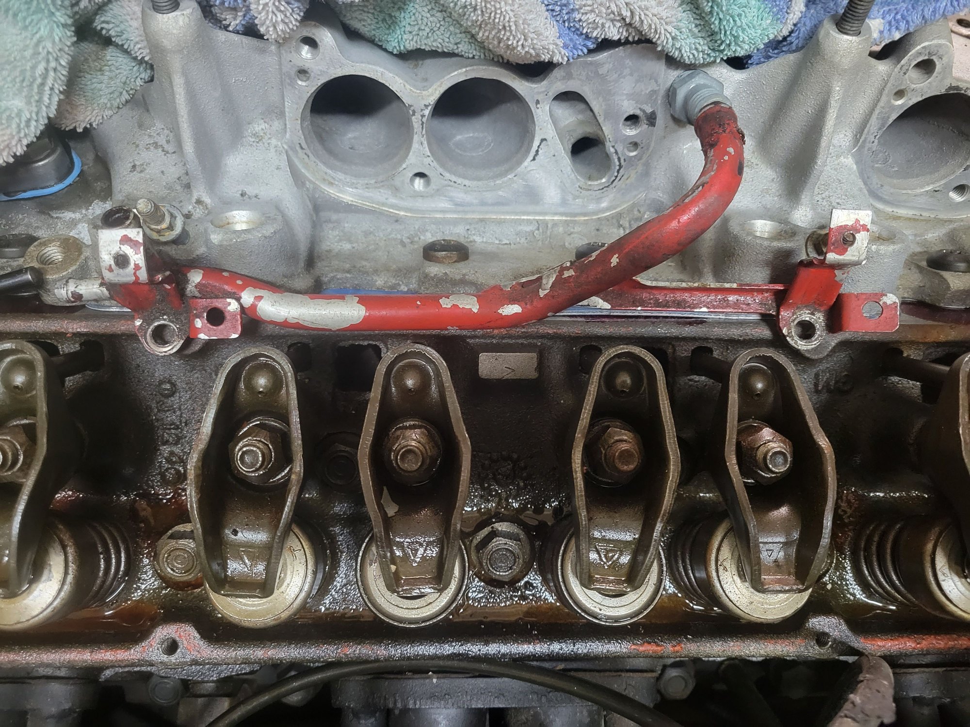

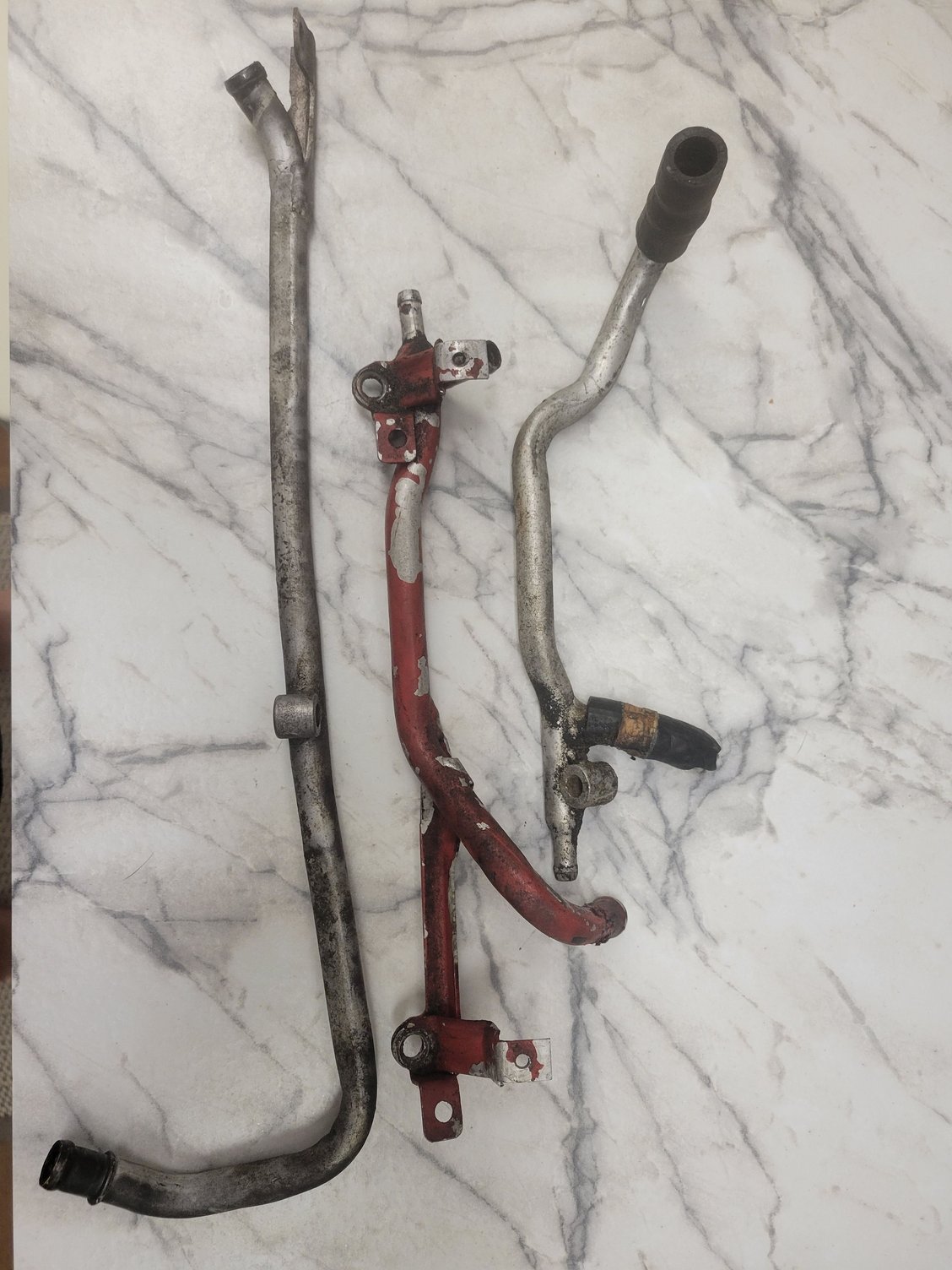

So I looked at some engine pictures on the net of early L98 engines and it looks like the valve cover venting goes to the intake but I dont see any ports.
I do have some piping I pulled off some cars over the years and I believe they came off a 85 (below) or 86. Maybe some of you can recognize which side of the engine these pipes go. I assume they are pcv venting piping.

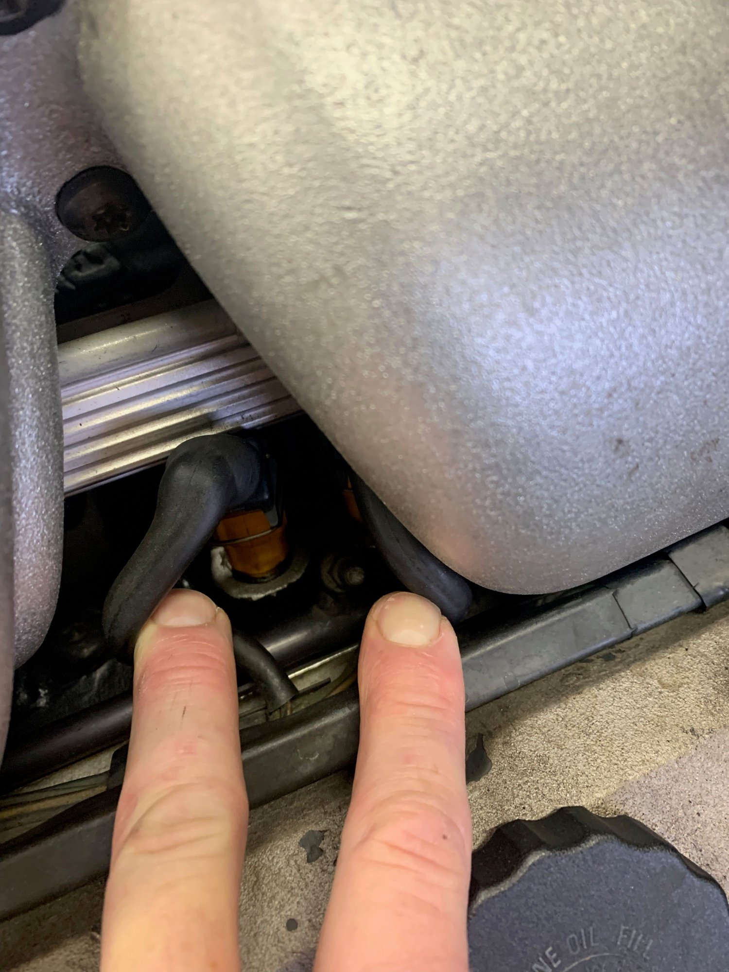

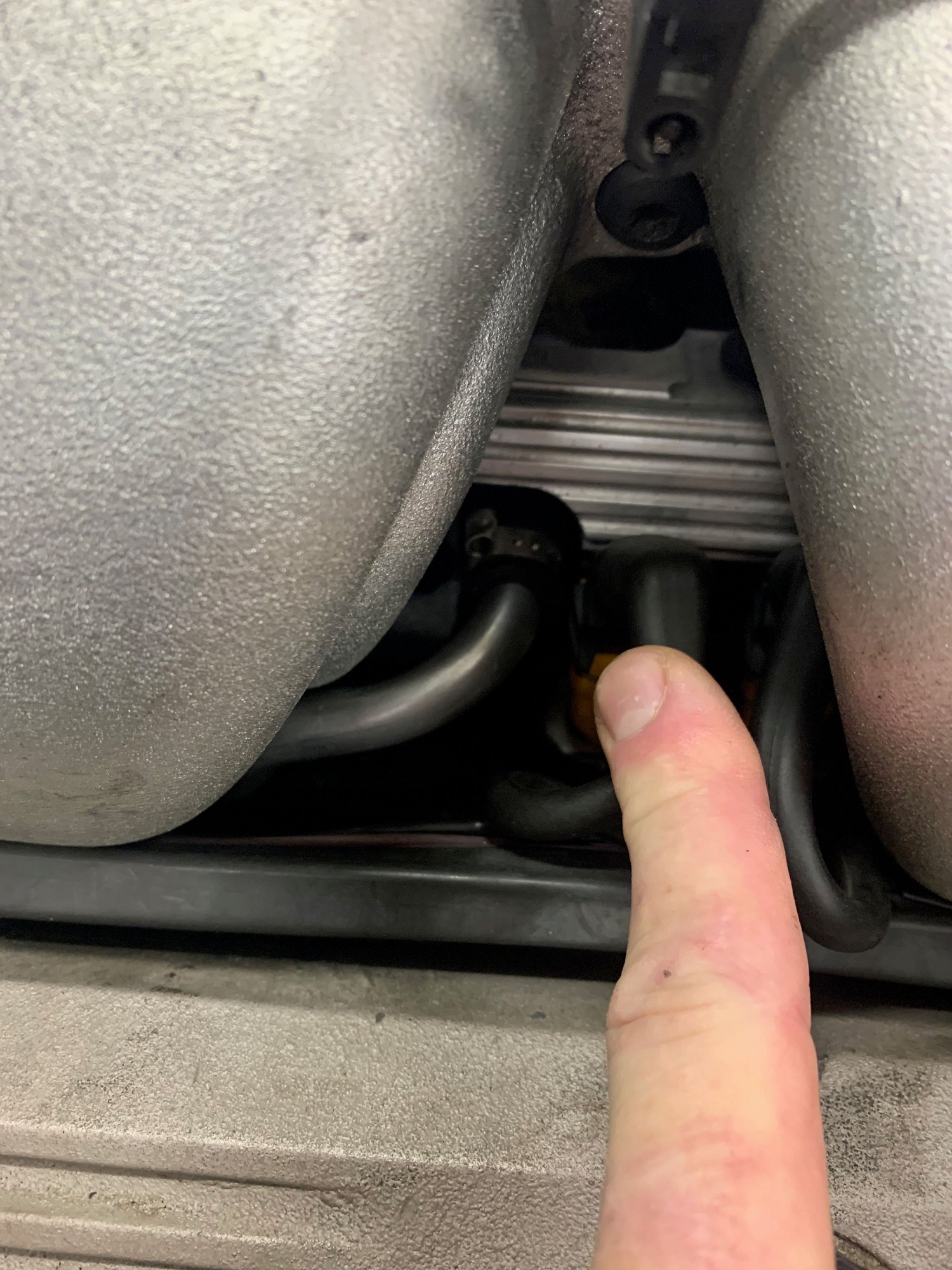

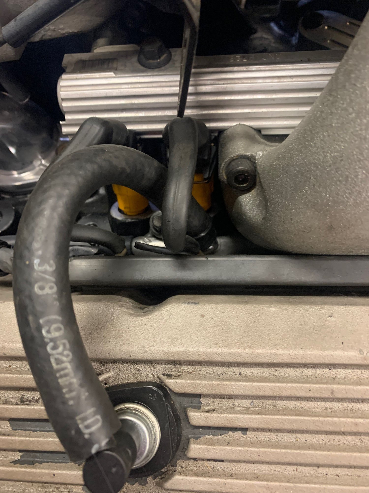

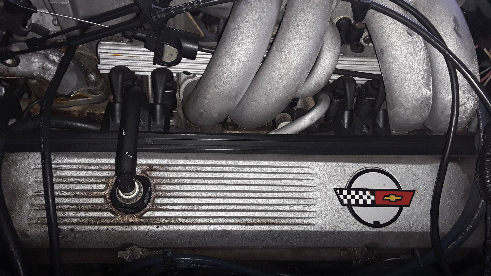

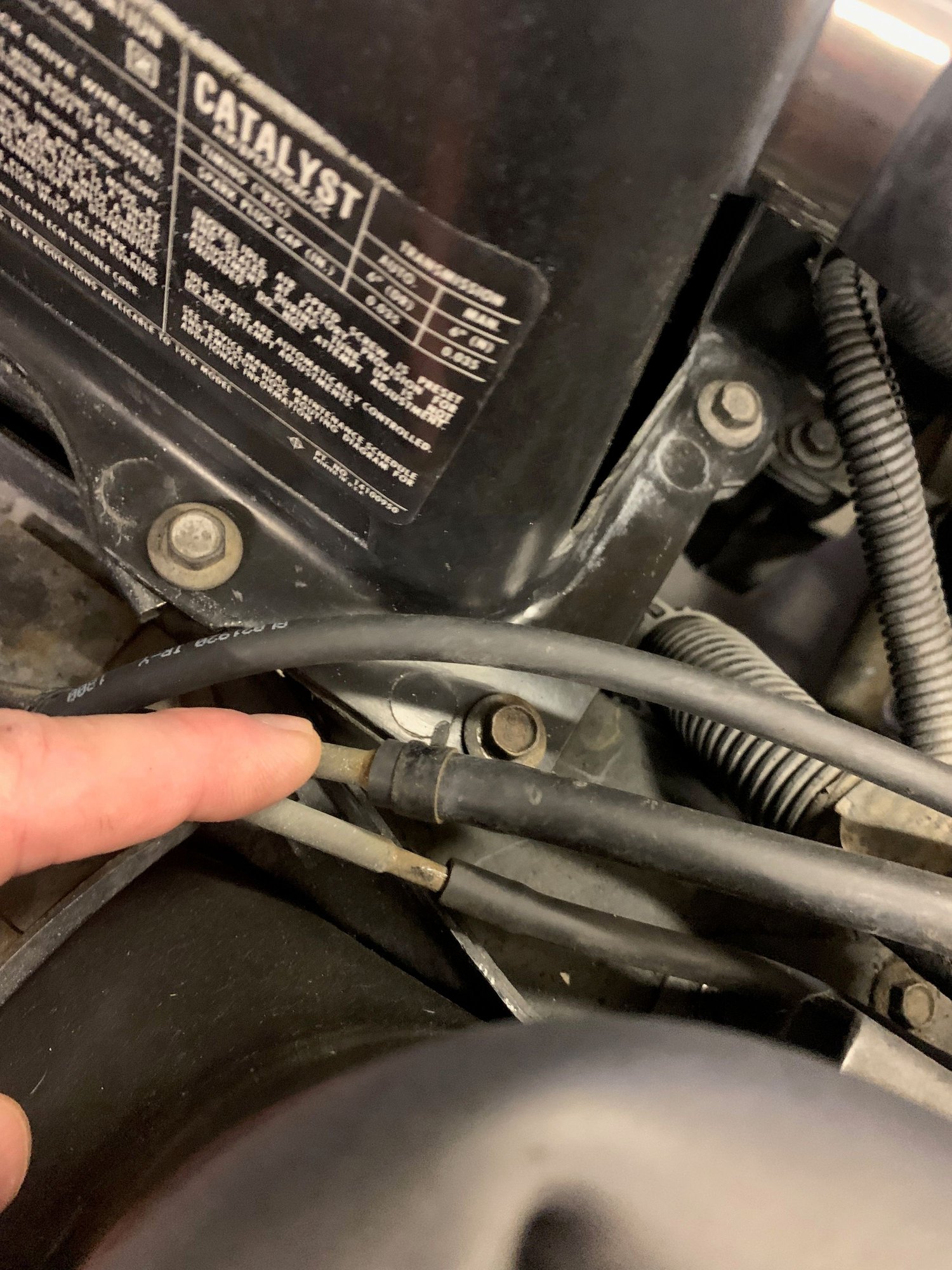

I checked the FSM and it was no help. Here's some pics of my 85. I think some of the piping you have is what you need. Here they are.
Passenger side. I'm not sure exactly where it connects under the Throttle plate or if it goes to the AIR pump system.
This one is of the driver's side looking toward the cowl.
Driver's side. The PVC hose connects to a "T" and goes left to the evaporator canister and right to somewhere under the plenum.
HTH,
Joe K

In the first pic of the passenger side is that a metal pipe between two rubber elbows?
Old Jan 2, 2023 | 06:22 AM
Joe K's Avatar
Joe K
Joined: Jun 2018
Posts: 657
Likes: 239
From: Louisville, Ky
2022 C4 of the Year Finalist - Unmodified
Finalist 2020 C4 of the Year - Unmodified
C4 of Year Finalist (appearance mods) 2019
Yes.

dieselgeek's Avatar
dieselgeek
Joined: Dec 2020
Posts: 71
Likes: 19
From: CNY
In the picture with the three pipes (red in the middle) the outer two are used on my 86. the long one on the left is from the v/c to the throttle body. The shorter one on the right is on the drivers side. The hose on top goes to a big port on the intake, the broken hose goes to the pcv valve and the nipple on the bottom goes to the purge canister.
Old Jan 2, 2023 | 12:50 PM
johnfin's Avatar
johnfin
Joined: Jun 2012
Posts: 1,391
Likes: 73
Default piping

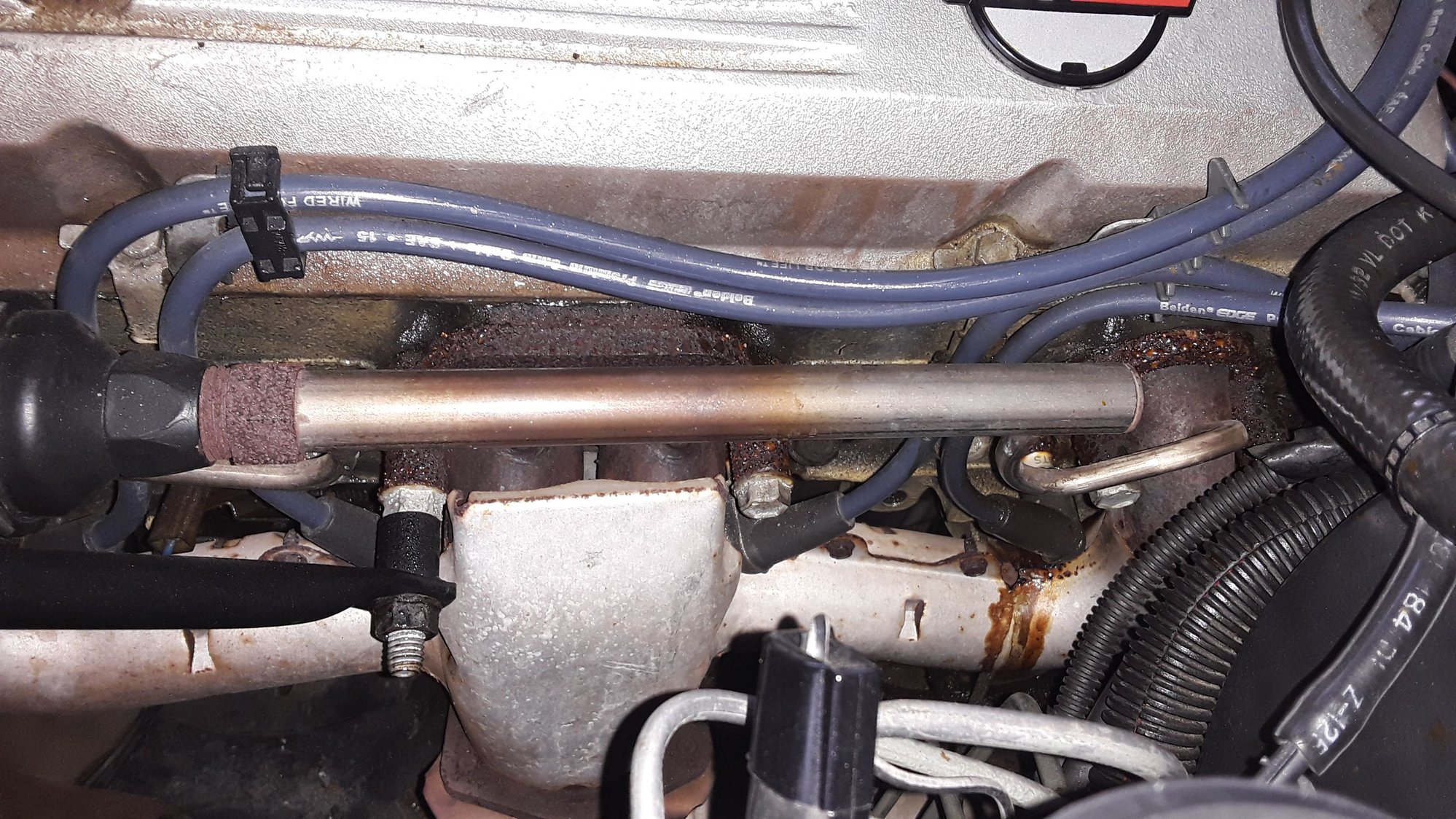

Looks like the red one is from an 85. Matched up to the intake AND has provisions for the harness cover. The other 2 I believe I removed from an 86 and verified from dieselgeek. Now I need to look for 1985 passenger side piping harness cover. I do have 86 harness covers but they are different, more C shaped not flat like the 85.
I think the studs that are coming out of my 86 manifold shown in the picture are for the 86 piping.

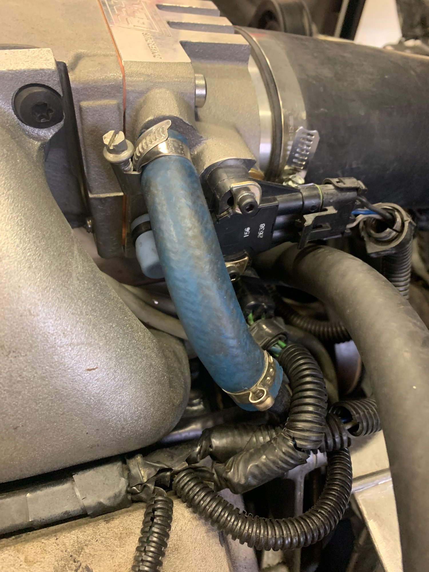

dieselgeek's Avatar
dieselgeek
Joined: Dec 2020
Posts: 71
Likes: 19
From: CNY

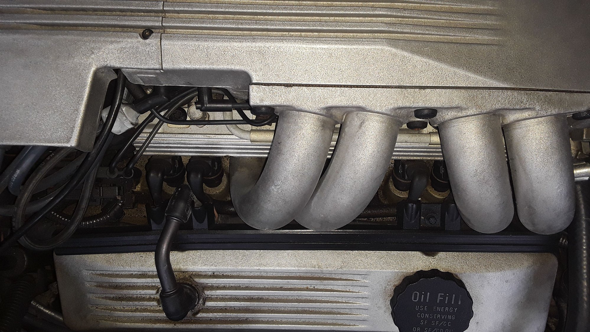

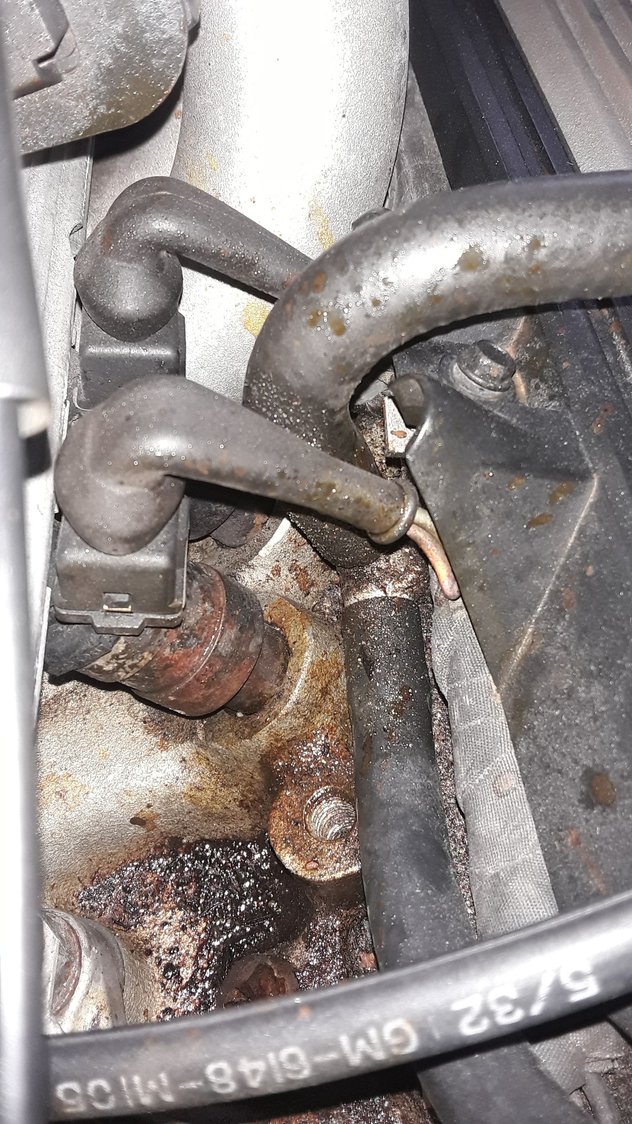

Here are some pics of my 86 piping.
Pass side v/c to pipe
Pass side pipe to t/b
Pass side pipe mount
Drive side pipe to intake
Drive side mount
PCV to pipe
Pipe end nipple hose to evap.

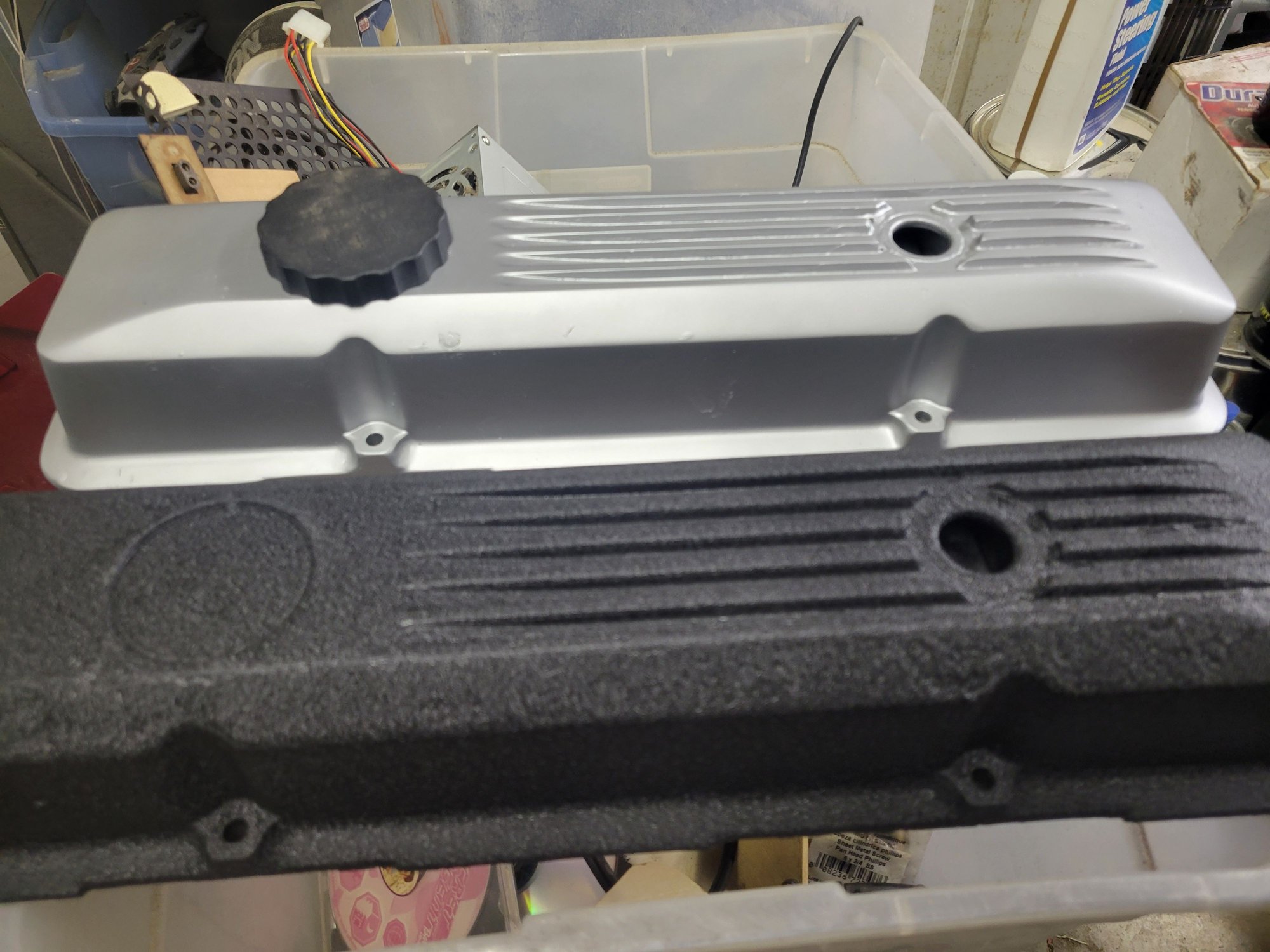

Thanks for the great pics guys. I think i have all the parts sorted out. The plug wire retainers i got from an 84 in the yard for $4. Saw a set on ebay for. $124. Same with the valve covers, bought 2 sets in the yard for $10 pr pair. Rough but i blasted them and put spruce nickel on one pair and wrinkle on the other set. Good enough for a driver and beats the $299 i saw for a set. Ebay valve cover prices are unreal.

dieselgeek's Avatar
dieselgeek
Joined: Dec 2020
Posts: 71
Likes: 19
From: CNY
Valve covers look great. I need to do my valve covers as you can see. I have the paint and a new emblem, just need some time...and motivation!
