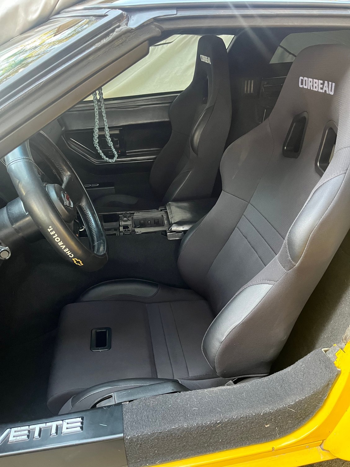

Just ordered a pair with the C4 seat frames. Does anyone have experience with these in an early C4? Wondering how much of a pain install will be.
Also looking for a harness bar and 5 or 6 pt harness.

Very painful, I have them.
You will have to swap the underneath parts from drivers to passenger side on the install, the documentation does not state it, or didn't when I bought mine. But others on the forum will say the same thing.
You will have a difficult time getting all 4 nuts on the floor studs, especially the front-inner bolt, which you can barely get on once its down and in place.

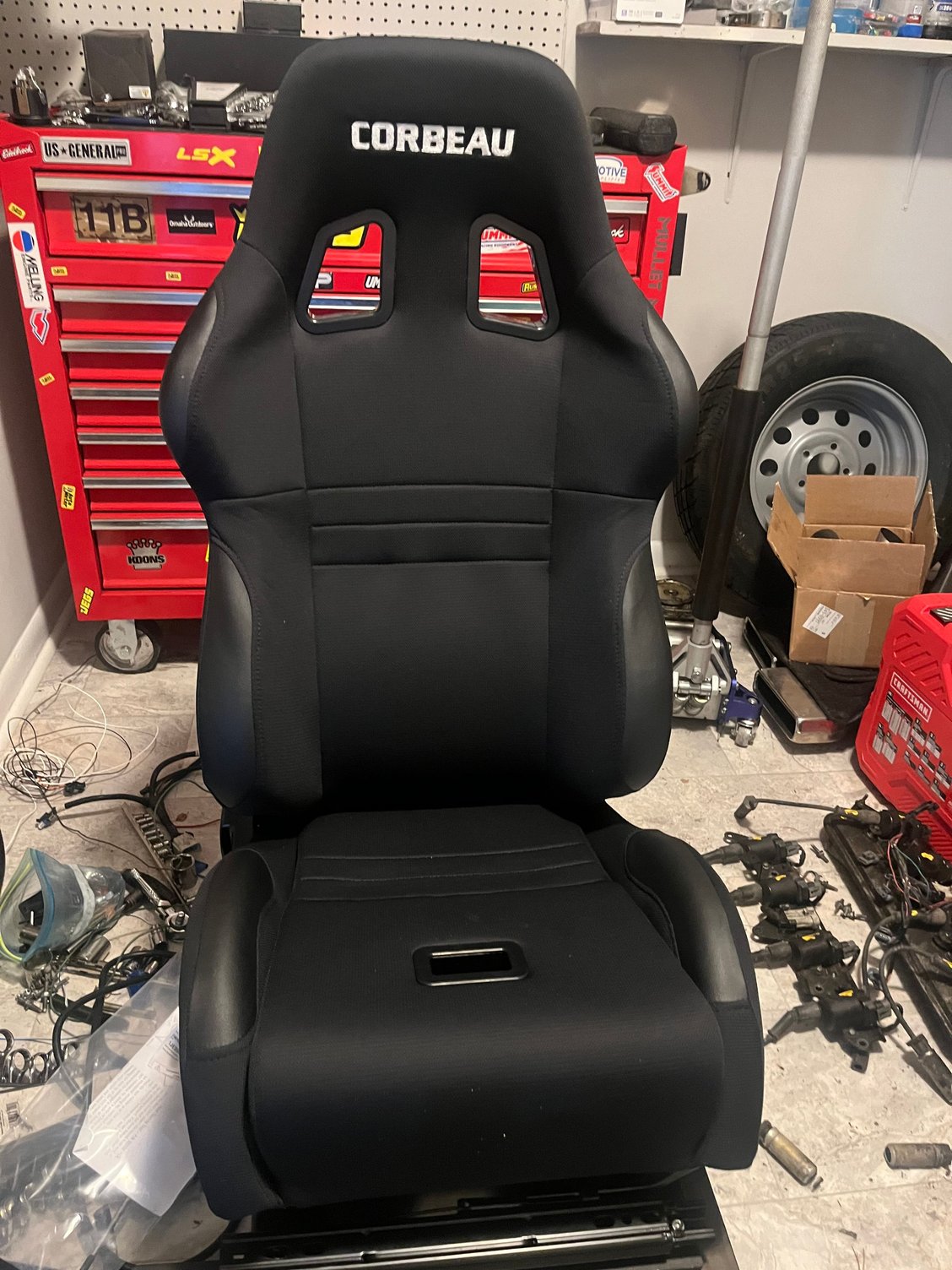

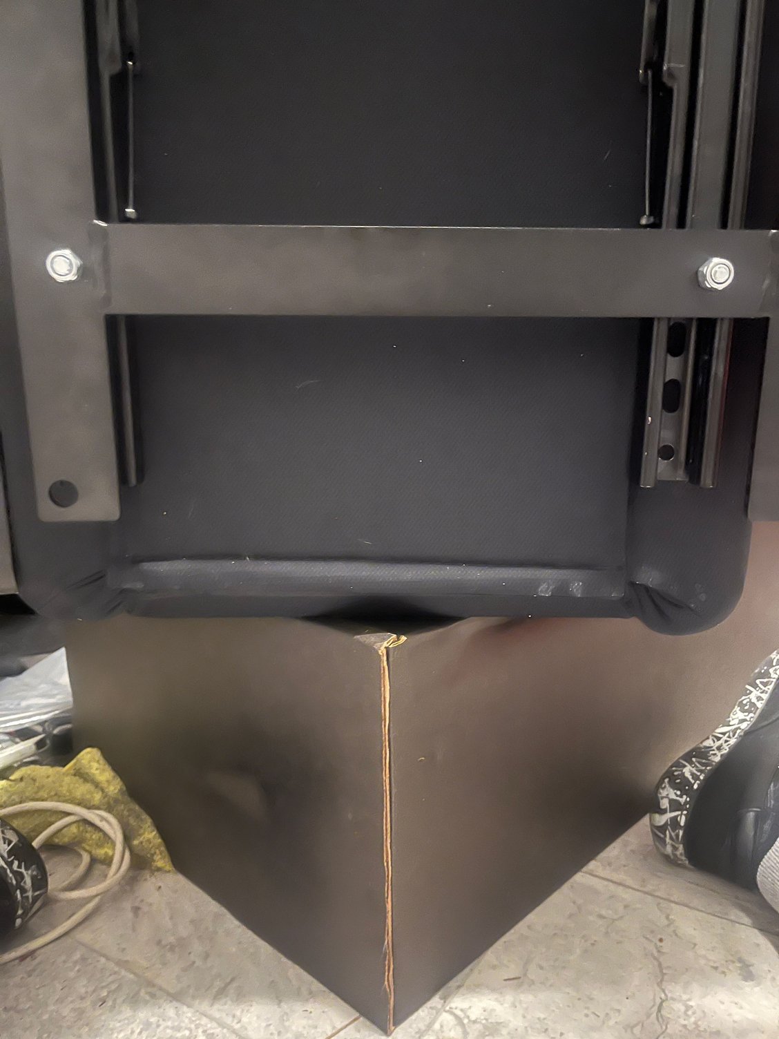

Instructions are terrible. By switch sides is each seat staying with its corresponding frame and just putting the drivers in the pass side and Vice versa?
also can’t figure out how to mount the damn frame to the bottom of seat. Instructions say to slide the bracket fwd put the 2 bolts in the top hole and then slide bracket to rear but one of the bolt holes on the rear is covered By the seat bracket itself.

Bracket slid to rear to install rear bolts but on the left there’s no way to get the bolt in. Wtf 🤷‍♂️

what’s the deal with the last rear bolt and the bracket covering the bolt hole? This can’t be right.
I’ve got the drivers side on d/s bracket Vice versa for the pass seat but the p/s holes are a ways off from the factory studs.

Just read through a bunch of forum threads on these seats and apparently you have to remove the bracket from the slider to get the other rear bolt in. Also the pass side bracket doesn’t even line up with the floor studs 🤷‍♂️

Yes that is why you flip the sides, otherwise nothing lines up right. I remember I had to slide the seat all the way forward and force the rear holes onto the studs, then all back to get the outer stud, and then impossible to get the front inner bolt on the stud with the seat attached. I wish I could be more help, I've simply forgotten. I've rarely cussed my car like I did that day.

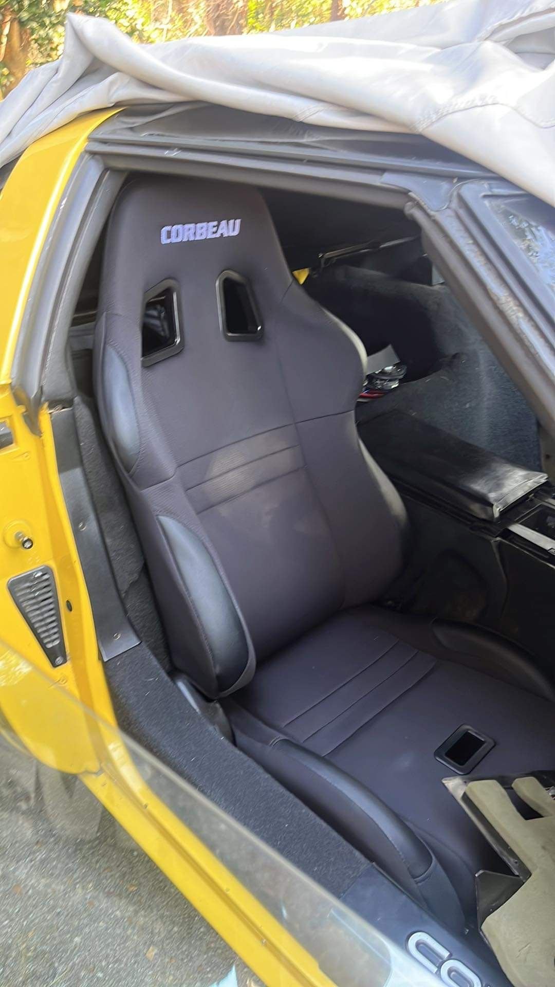

Update:alright so apparently to get the 4th bolt in you have to separate the bracket from the slider.
Also they must have made a change cause the sides DO NOT have to be switched. The outter front bolt to seat stud is still nearly impossible to get to. I got all 4 tightened on the pass side but the outer front on the d/s side I was only able to thread on a few times by hand-there’s no way to fit even a short wrench in.
