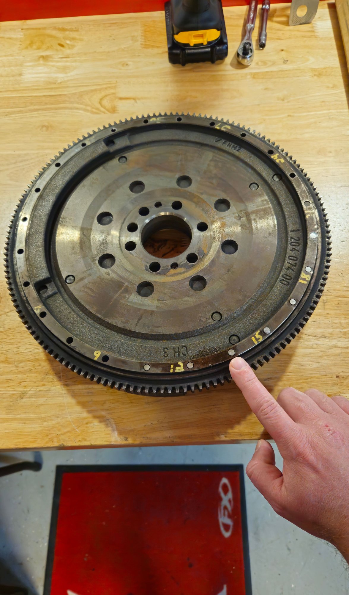

The time has come to replace the clutch again on my 94'. Last time I reused the DMF with a replacement kit from Carolina Clutch. This time around I think I would like to explore converting to a single mass flywheel. I am aware of the added noise and the need of a sprung hub disc, but I am curious about the match balancing. Carolina Clutch recommends match balancing the new billet steel single mass flywheel to the old OEM dual mass flywheel. I am in the Tampa, FL area and cannot for the life of me line up a competent machine shop to do this service. They all stare at me with a question mark on their forehead or crickets on the phone. I am curious as to how many of you have converted to a single mass flywheel and never had the new flywheel balanced?
Thanks,
Patrick
P.S. - I would prefer not to go with the RAM push style conversion, I would like to stick with the conventional/stock setup with the external slave cylinder.

I believe I have around 7 holes filled with weights.

I never had any balancing done to my original DMF. It was the same way last time when I did the clutch job in 2012, and its the same way today.
