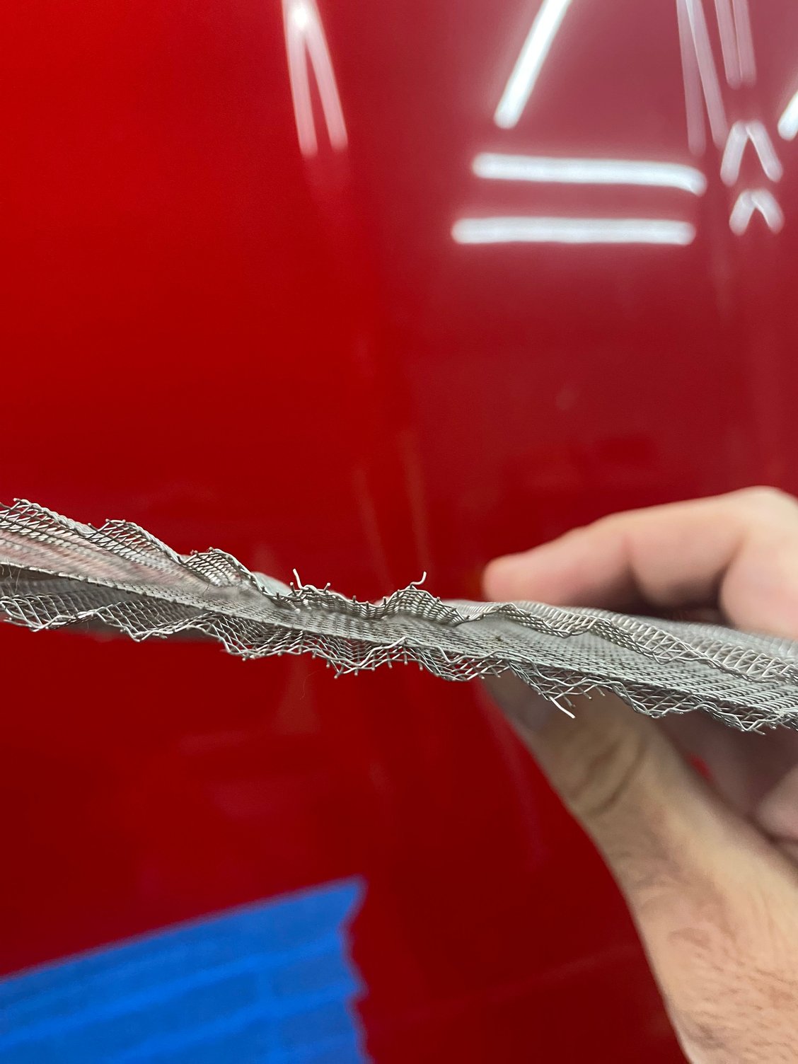

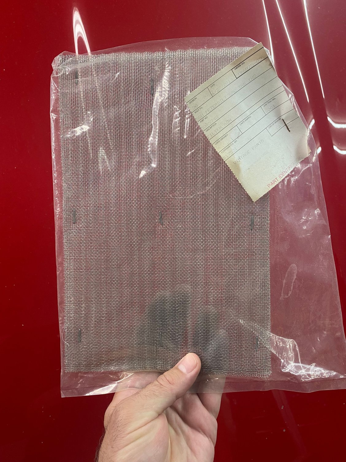

Originally Posted by ChumpVette
It’s not cloth. It’s a 3 part wire mesh screen.
The wire cloth in the picture is called a de-mister. It traps any moisture that happens to blow off the Evaporator. Usually placed on the leaving air side of the Evap.
