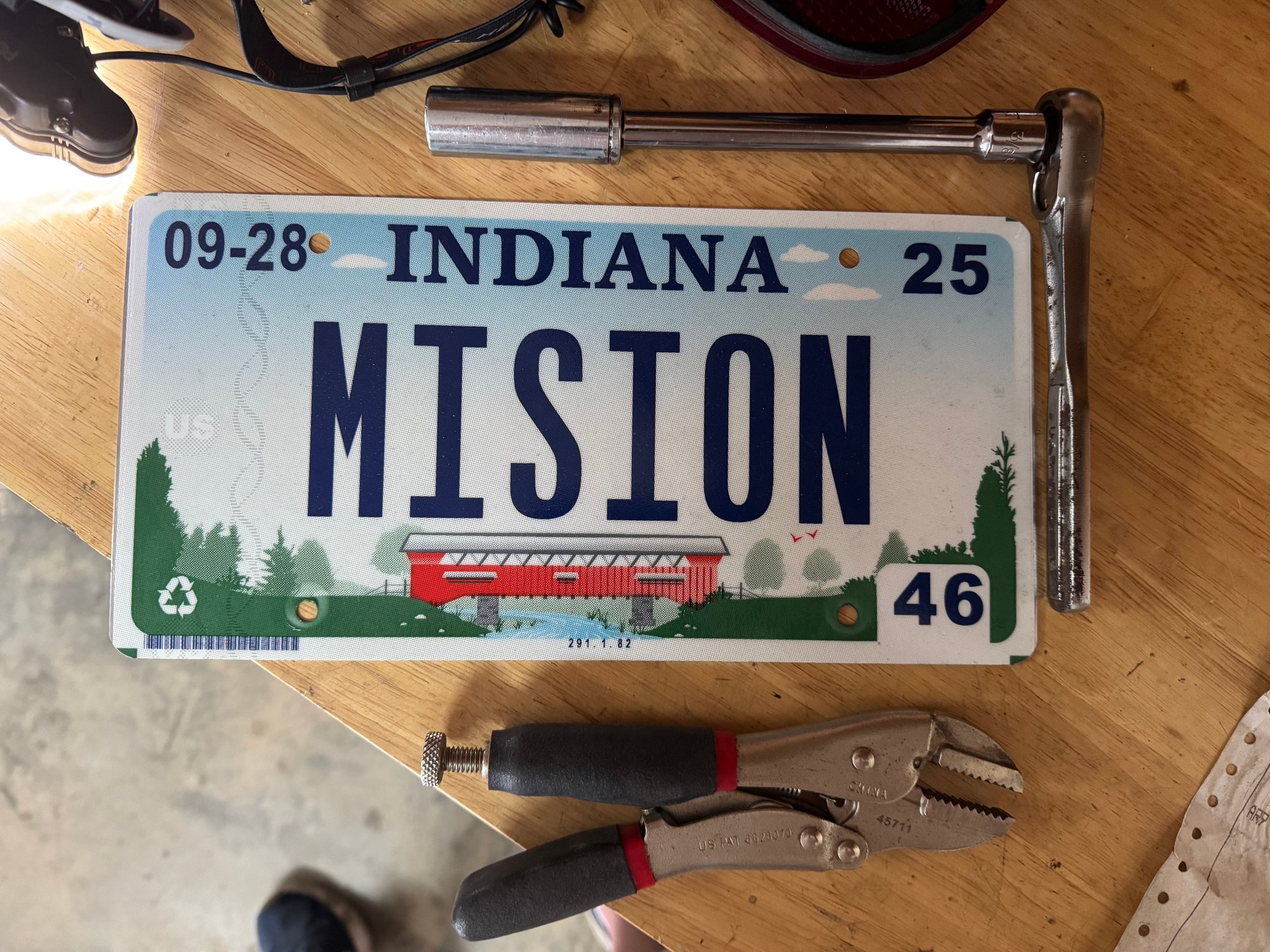

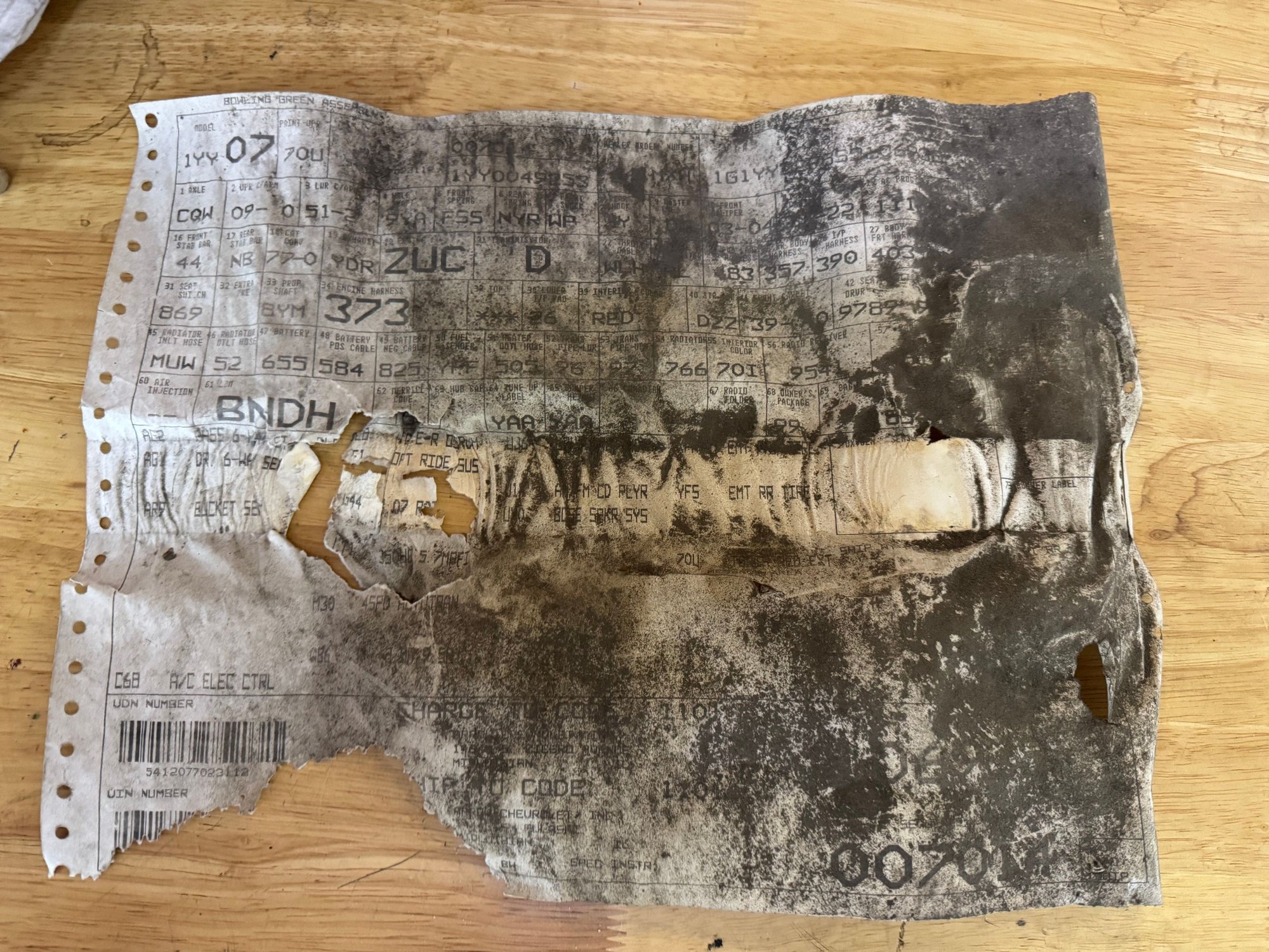

Thanks for all your help guys. Especially @RPO Joe . Got the build sheet out this afternoon. Biggest issue is making sure the tank strap doesn’t twist. I used a pair of vise grips to hold the strap in place. Also used a 6 inch extension to loosen the 15 mm bolt. The car’s vin does match the build sheet. Haha. Also the order was put in on Oct 27th of 1994 at 5:41AM which means it came off the line 7-10 days afterwards. It was delivered to Midlothian, Illinois to Arrow Chevrolet.
Did you clean and lube the strap threads first like I suggested?
I'll modify my tips to include using Vice-Grips to prevent the strap from twisting while backing off the nut, and using an extension with the 15-mm socket.
Thanks for following up with photos of the extraction. Well done.
