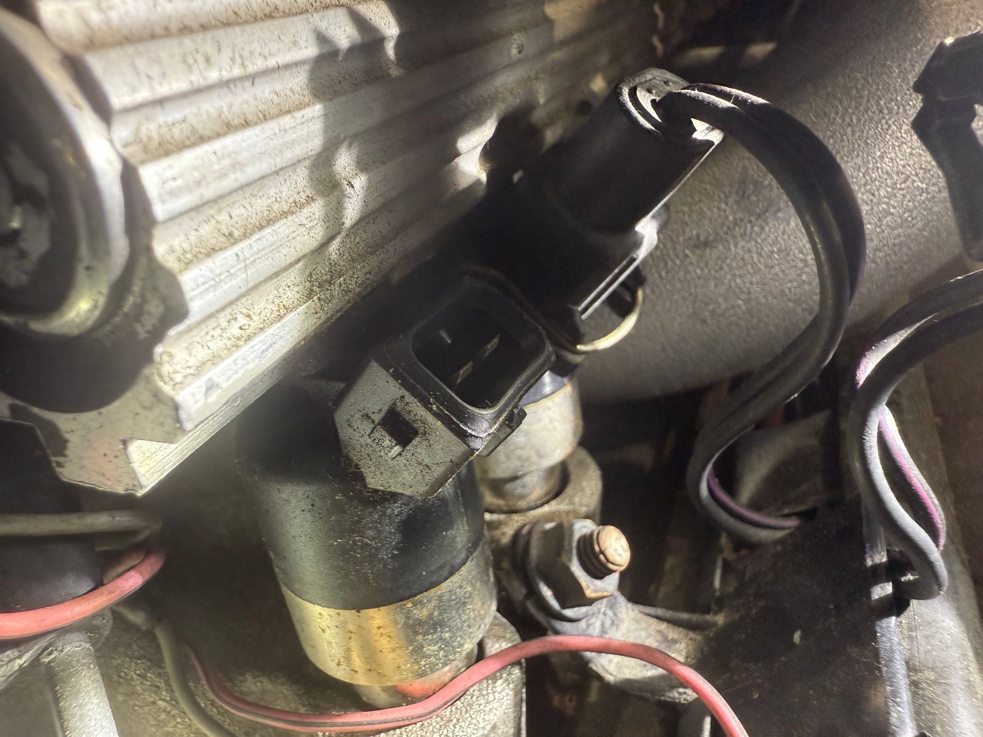

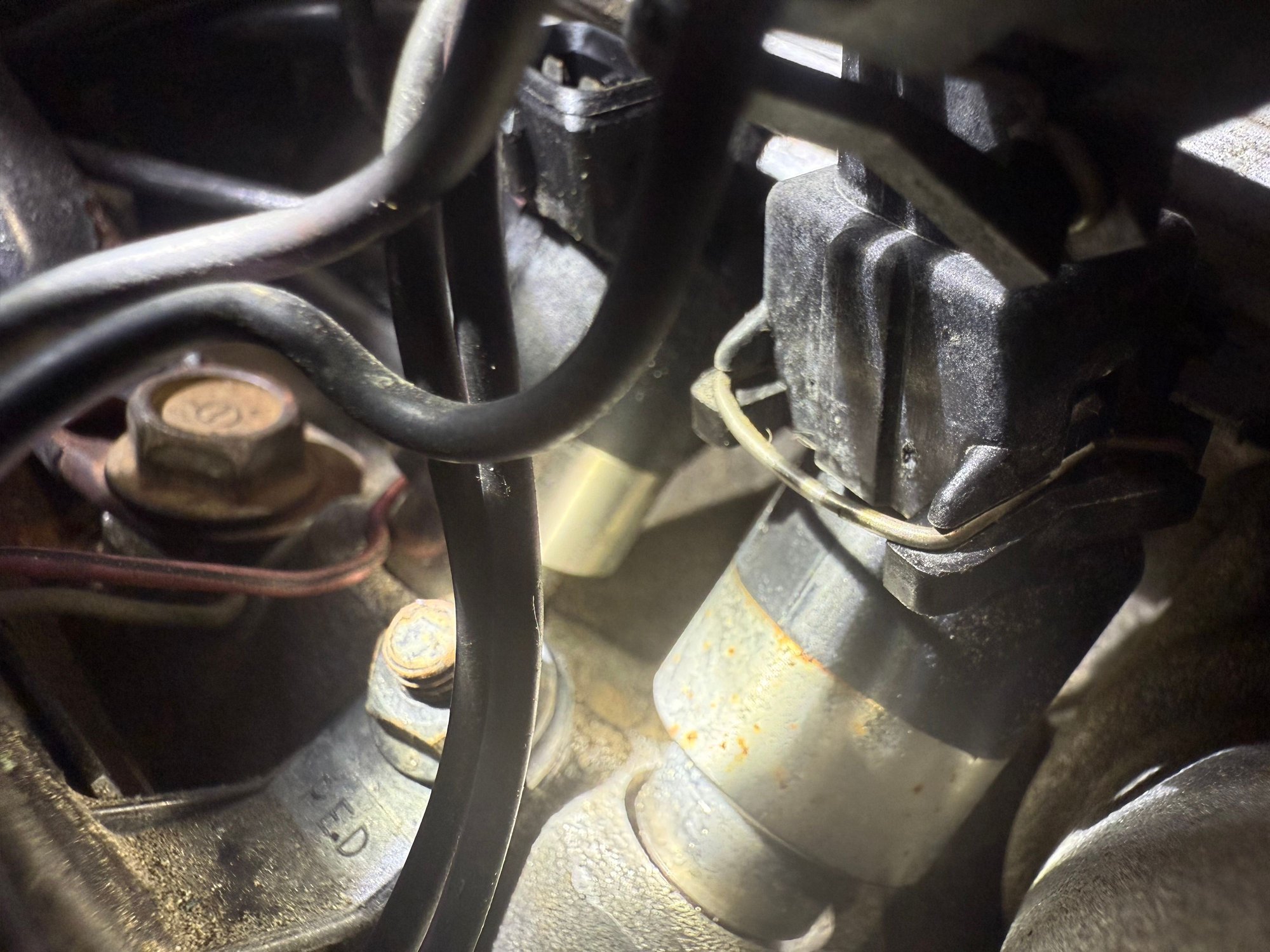

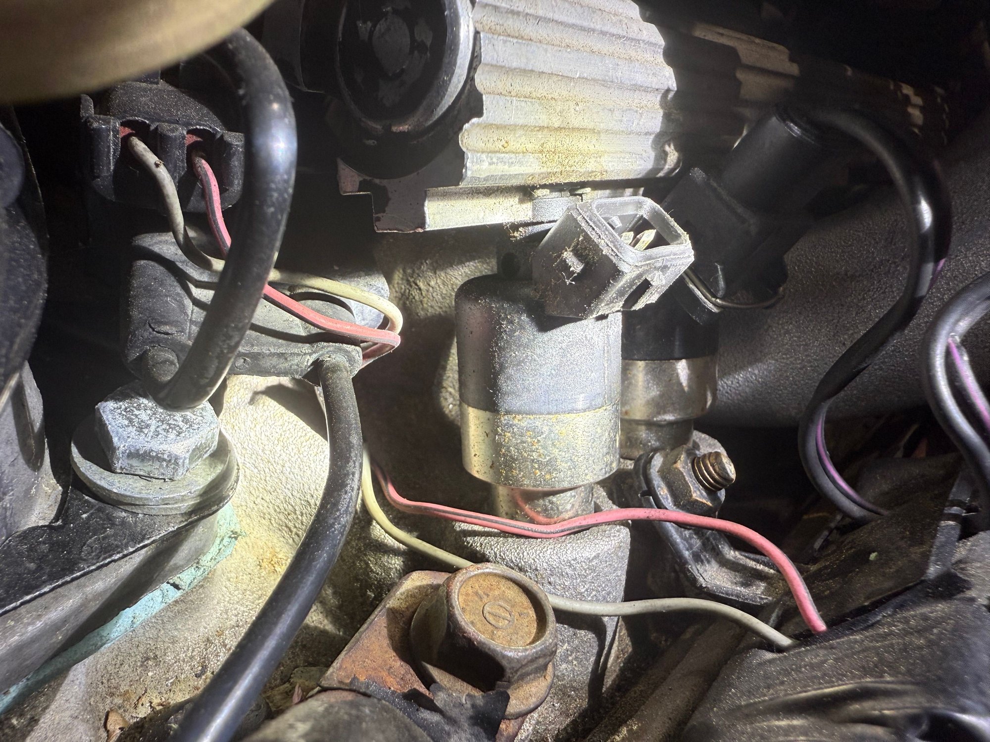

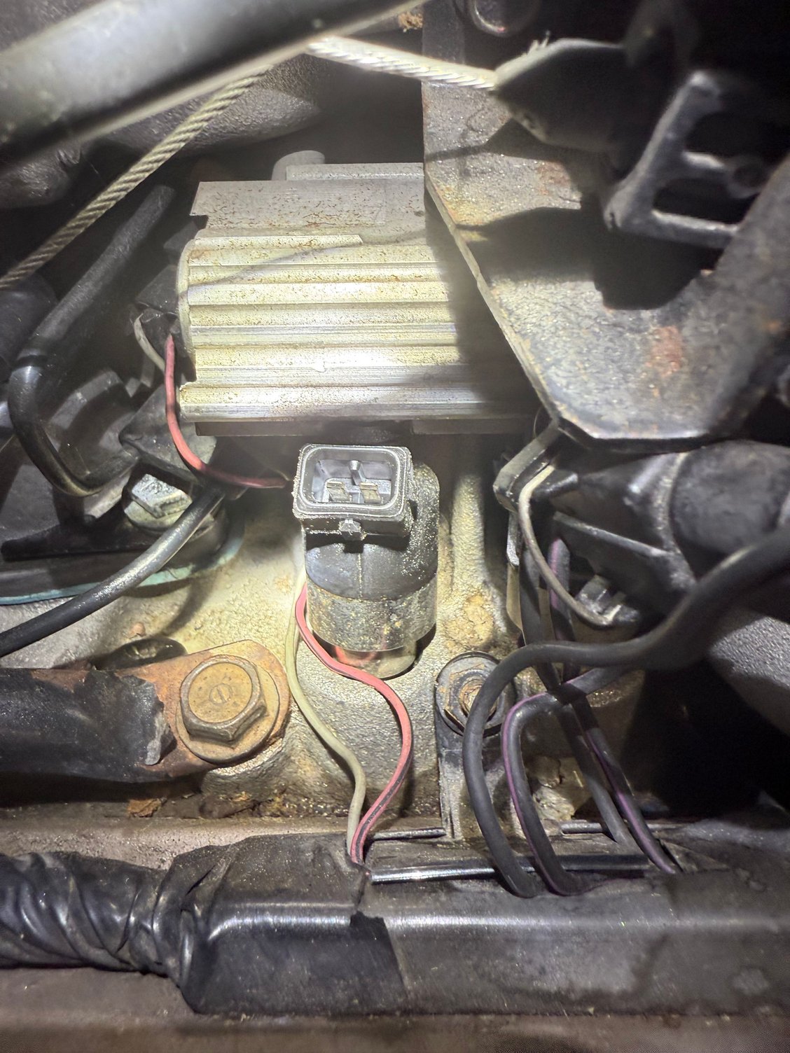

First thing is to ID the fuel injectors-look for a number on the body of them. Figure out what the flow rate is vs whats programmed.

There are zero marking on the fuel injectors , what else can I do ?

Rochester knockoffs. Rochesters were grey on the bottom half.
Last edited by spaceweasel; Jul 4, 2025 at 04:30 AM. Reason: Rochester knockoffs. Rochester was grey on the bottom half.
