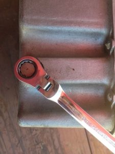

Oil Pan Drain Plug (14 mm Box wrench).....38 ft-lbs (5/8-18 Thread)
The Oil Drain Plug is a Helicoil insert which is installed to reduce wear and tear on an Aluminum Thread.
A 14 mm open end flex head Ratchet works perfectly on Oil Drain Plug.

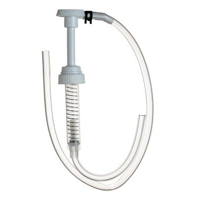

Always use a Fluid Pump when adding fluid to the Differential or Transmission.
