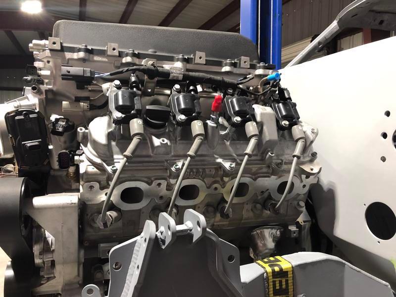

Remember Rod Dewild here are some shots of a 69 Camaro he is building with a 800 hp lt5 crate motor and sequential shift 6 speed.
1000 hp with a pully change.
Tyler
