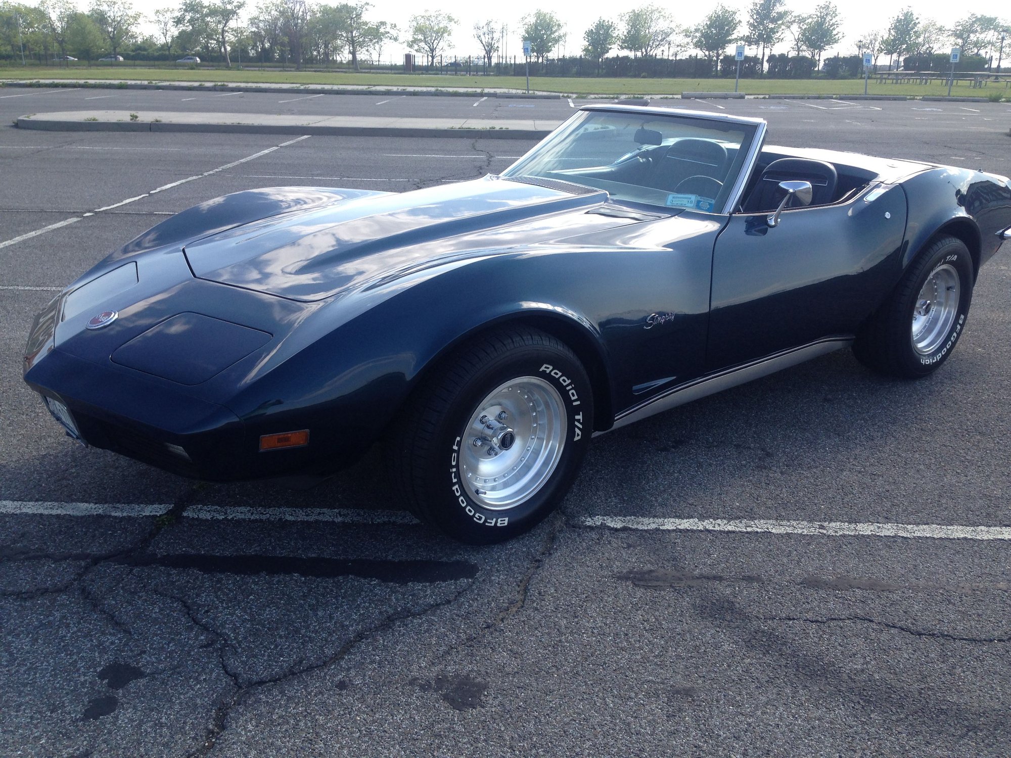

I agree about your thoughts on your mid year..I have a 73 convertible I have owned for 16 years now......There just different animals than the LT-5......Saw a 69 with a 91 corvette engine for sale on the forum.....Now, if it had an LT-5 in it, that would be something...
