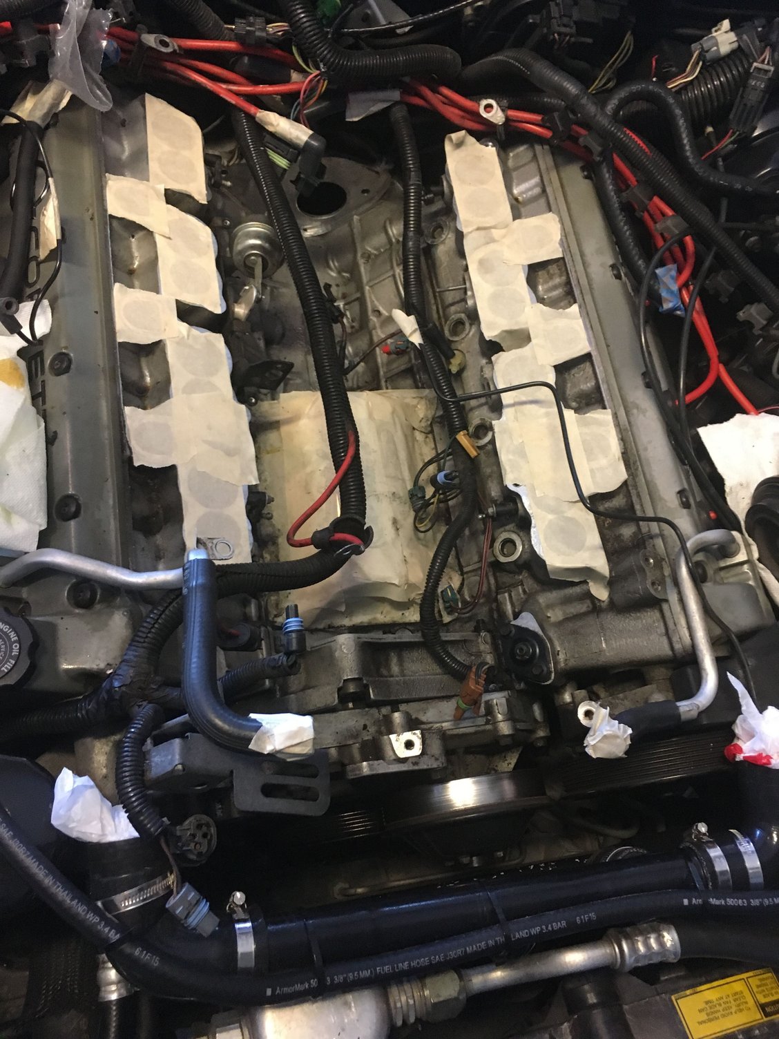

It was the water pump. I finished draining the coolant and got the same fizzle. from the same area again while draining. I had a shitty day with it today..because I'm an idiot. I depressurized the fuel rail at the schrader valve, however because the car has been sitting for over a week, the pressure in the tank just pushed gas all over me and the back of the engine bay when I pulled the feed and return lines out of it. So after my attempt at a Darwin award, I spent a good chunk of time cleaning up my stupidity. The silver lining in the debacle of removing the fuel rails was I found out the fuel feed line's O ring was pretty much toast, so Jerry is getting more of my money. Happily, I might add, I'm glad Jerry and a handful of other guys actually keep an inventory to service these great Vettes. So the injectors were IN THERE as far as trying to remove them attached to the rails as an assembly, so the clips were removed and the rails were just pulled off the injectors. And, again, I'm glad I dug into here because whoever replaced the fuel injectors got all the clips into the injectors on the passenger side, but none of these clips were securing the entire driver side rail.
Injector housings are off and everything is taped up. Spent half the day cleaning up gas because. Well, we've bottomed out at this point, now it's just clean clean clean and get it all back together with new gaskets and parts. Glad I dug in here. I also found out my secondary linkage is still a thing after talking with Marc. Per his email response for my chip info:

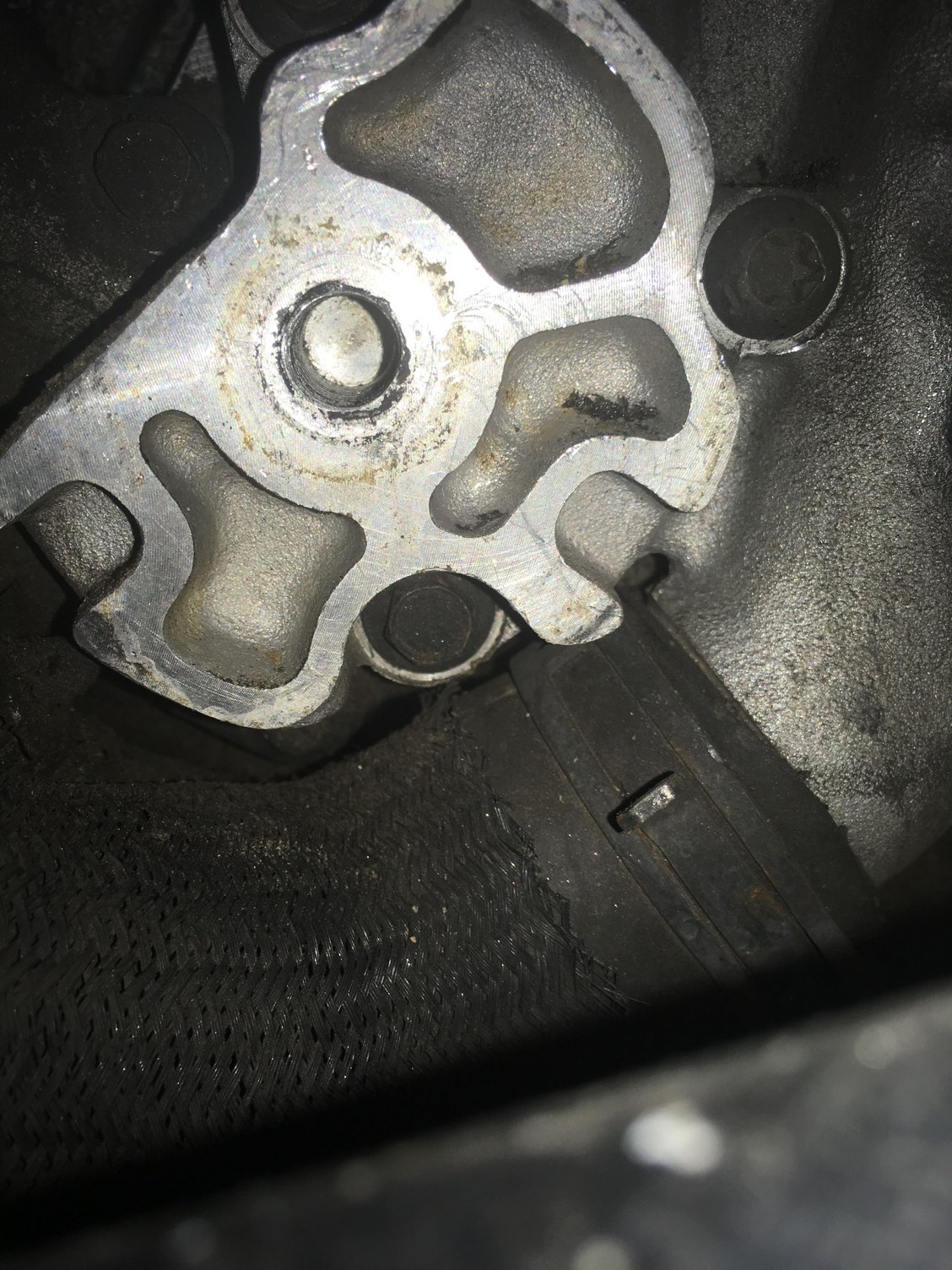

ALSO, I need someone to verify the below pic correct orientation for the belt tensioner. When I found my tensioner riding the crank pulley, it was installed this way with the machined notch on the back of the pulley fitted into the 8 O'clock notch. In this position, it was pointing at the water pump and the tensioner pulley riding the crank pulley. If I rotate this to the notch that is at 4 O'clock, the pulley is pointing pretty much up where it should be in the manuals and diagram in the engine bay. The belt is a brownish color version which I'm guessing is a replacement. Am I correct in that the notch on the pulley tensioner should be in the notch on the right?

Thanks for the info, Ccmano. That's the goal eventually. I'm an idiot on the secondary butterflies: I just took needle nose pliers and held them while turned them to fully open, then tightened the retaining nut. It's all back together and running. Breather box was torqued to 7.5 lbs which seems like very little but Marc verified. I was not a fan of double checking all the vacuum lines before lowering plenum back on. Unfortunately, I can't drive it because the new Dayco pulley I put on the tensioner shredded within a minute of the car just warming up with the new coolant. I don't know what the hell is going on with this thing. The tensioner literally wants to force itself right onto the crank pulley. I can pull it up by hand a bit but need a ratchet to get it to full retract upwards. Only other option at this point is send it to Marc for a rebuild. I sent him pics of it and he didn't dispute it being an LT5 tensioner.
Are they SUPPOSED to ride the crank if no belt is on at all? Is this what happens when they are shot? Sorry, just frustrated. After the crap I found in there and the gas fumes for days and finally getting it back together I was really looking forward to driving it. Belt on it is an 80.5. I got a Gates 80.2 and it won't go on but I'll give it another try. I just don't see how that little difference will make up for a tensioner trying to point at the crank. The only other thing I can think of is there's a "pin hole stop 6mm" listed on the belt routing diagram. I don't know if that means there's supposed to be something machined in the block that stops the tensioner from travelling too far down but I didn't see it mentioned in the FSM or supplement.
Guys, I'm definitely stumped on this one. She's off the road for a while longer.

Here’s mine with an 80.5 inch belt and with and 80 inch belt. I believe Haibeck recommends the 80 inch.
