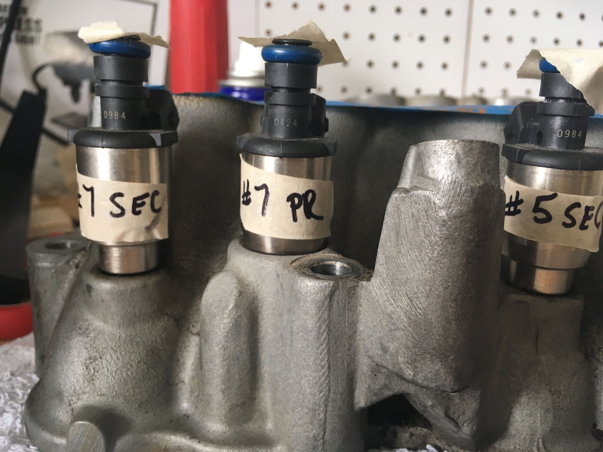

Hey guys, it's been a bit but I finally got out to do some probing with the multimeter. I work at the speed of slow on these issues, the turtle is my spirit animal. I'm not too sure I'm doing this right, as Marc's walkthrough states resistance should be 12.1 ohms +/- .1 at 70 degrees F temp. So I had my instrument set to 200 Omega, I probed the pins in connector A off the ECM with one of the probes touching the fuse contact closes to the front of the car from INJ 1 fuse cavity. Then I pulled the secondary relays and probed them in conjunction with their respective contacts on connector A. Here are my results on a nice toasty 95 degree day in the garage. The car has not been started in a few days:
Primary injector and connector ID with readout
#1 A1 - 17 ohms
#2 A7 - 17 ohms
#3 A18 - 16.9 ohms
#4 A13 - 17 ohms
#5 A3 - 16.7 ohms
#6 A8 - 16.7 ohms
#7 A2 - 16.8 ohms
#8 A12 - 16.9 ohms
Secondary Relays
#1 - A on relay 1 - 16.7 ohms
#2 - G on relay 2 - 16.8 ohms
#3 - G on relay 1 - 16.8 ohms
#4 - F on relay 1 - 16.9 ohms
#5 - B on relay 2 - 16.8 ohms
#6 - A on relay 2 - 16.8 ohms
#7 - F on relay 2 - 16.8 ohms
#8 - B on relay 1 - 16.8 ohms
I was going to take it out for a drive tomorrow to get it up to operating temp to have the condition begin and park it to probe all the connections again while hot but.....what did I do wrong on this because I'm way off from the 12.1 ohm resistance per Marc's guide. 200 is as low as it goes on ohms, and bumping up to 2K just moves the decimal place and I still get the same readouts above.

When OEM Injectors go bad the resistance drops. They go from 12 ohms down to 8 and lower. Somethings not right with your readings. Are you sure you have OEM injectors? Do you have a photo of when you had the plenum off that shows the injectors that you can post. I can identify from there.
I still don’t think the injectors are the problem from the way you described it. It almost sounds like an issue when it transfers into closed loop mode or when the secondary fuel pump shuts down after cold start.
H

These aren't the original injectors. 3rd owner replaced them (at least his for sale ad said so anyway) Have a look. They have a three hole discharge. I replaced the fuel pumps a few weeks ago with the EP381 pumps and a new fuel filter. I was hoping it was a fuel filter problem or pump problem, but on closer observation, it's definitely a thing after 10-15 minutes of driving and warming the car up. I'll keep checking the trouble shoot charts.
1985 Corvette is offline

As you say, those are not original, they appear to be FIC’s. Resistance will be completely different. Considering how close all your readings are I don’t see a problem here. Again, highly unlikely this is an Injector Issue. I forgot, did you check for codes? I still want to know the fuel pressure when hot.
H
