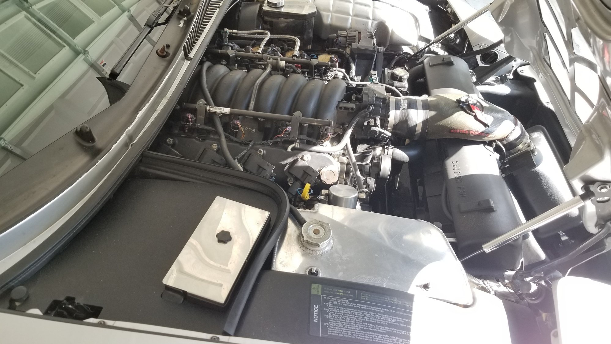

How long have you had yours? I put this on my car in 2009 or 2010, it's been awhile. This picture is several years old and things have changed under the hood since then, but you can see the difference in the neck. Mine looks just like what is on the website.

That's a VERY tidy engine bay! Cleaner than the OUTSIDE of a lot of cars. Where did you hide your Coil Packs?

Thanks! I'll post some updated pics later, I cleaned it up even more and hid some of the plumbing and wiring. The coil packs are next to the battery, you can see the bracket I made out of aluminum and sprayed black. I have a cover that encloses that compartment and you can't see them at all. The drivers side are hidden inside the fender, which you do not have to take off to access them.
Anxious to see some of the pics. Especially the ones in the fender area - a lot of horror stories about mounting them there. Also interested in the battery cover - my car doesn't have one. Are they an OEM item?
