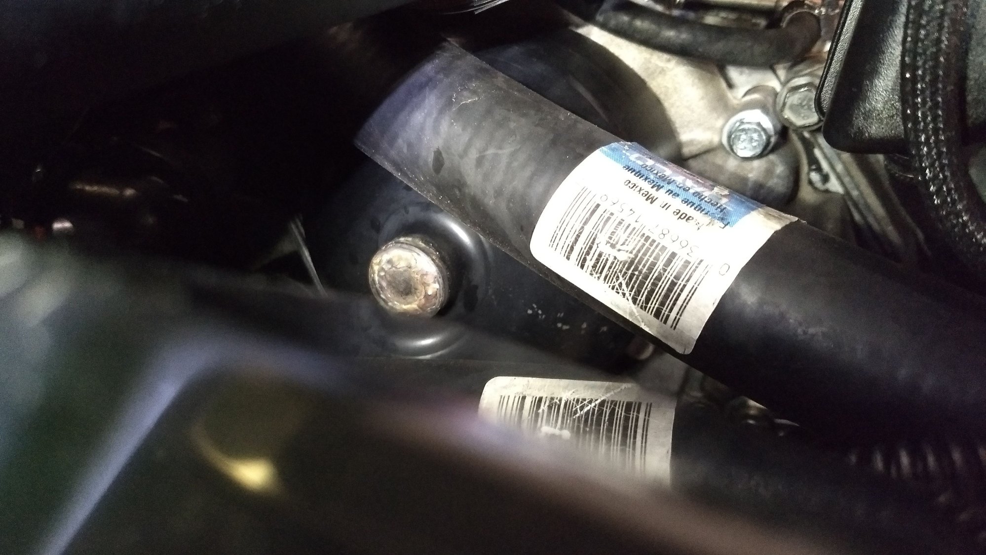

Good time to make sure you ditch the stock PS pulley and get the snout on the water pump welded. Extra insurance Also get the blower cam, you are minutes away from installing one if you already have to do the balancer.

Sure, the stock C5 power steering pulley is a hard plastic and can break apart leaving you SOL. The C6 PS pulley is $30 and is a great replacement. My picture shows the Turn 1 pulley.
For extra insurance you can have the snout of the water pump welded so it doesn't come off due to belt pressure.
