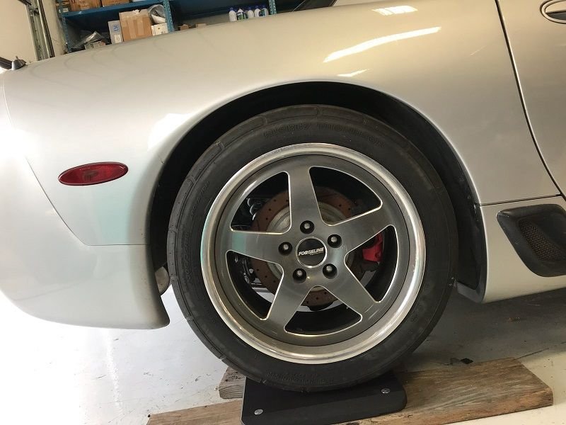

C6z cradle, diff, Tubular control arms to get them centered. Bret saw how my control arms worked out and decided to improve them. When I was at his shop the other night, he had at least one control done. The tubular stuff will require coilovers though.

Who makes the tubular control arms? Brett?
will they clear an inner bead lock?

Yes, Brett makes them and I want them in my life.
Not sure on the bead lock but I'm gonna text him and I'll follow up.

Bret was working on my car and we ordered mine from another company but then learned that they will not clear all 15" wheels. So Bret decided to make his own that will clear 15" wheels much better. I know he has at least one done and maybe a set by now. No doubt that his design will clear 15" wheels better than mine do but no idea about inner bead locks or if it was something he considered in his design. You will have to shoot him a PM about it.

I know he has a set of double bead locked 15" weld's sitting over there so if the current design won't clear then it shouldn't be a problem for him to make small tweaks to accomodate
