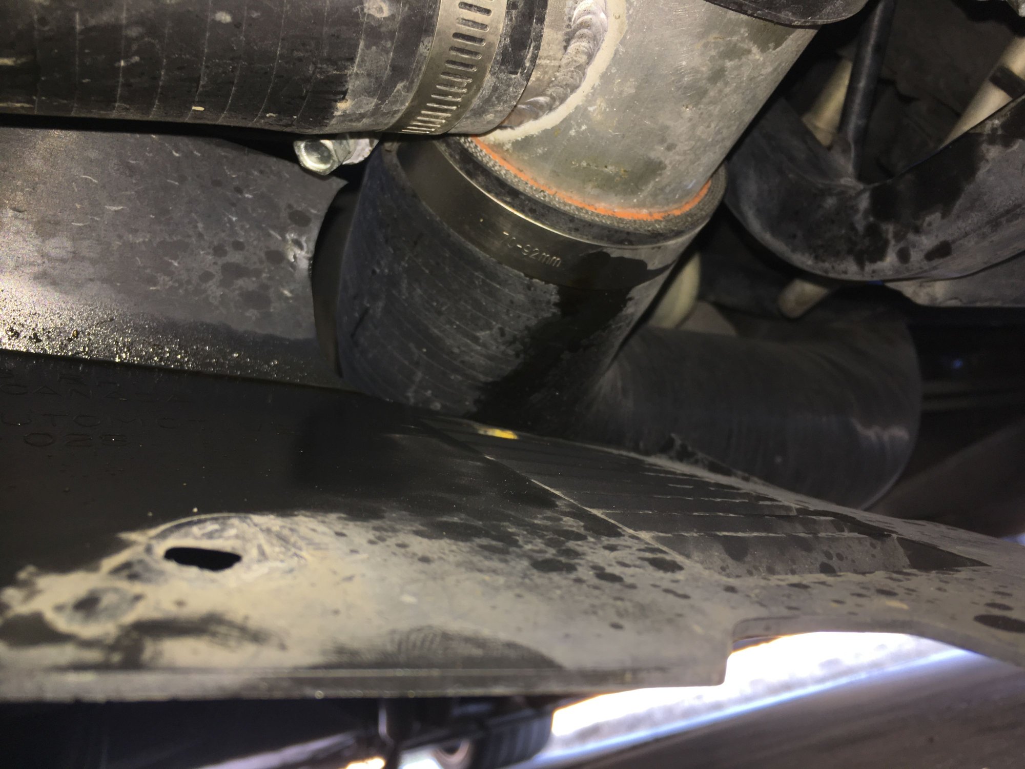

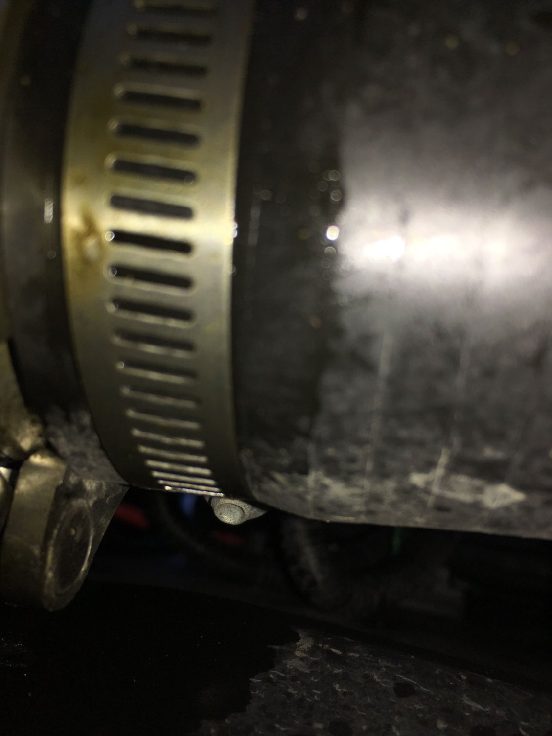

For the oil leak, I attached some pictures. Is this just blow-by coming out the BOV? The shop could have overfilled it, I don't know for sure. Do I just drain and fill the thing like normal? I was a bit confused by the hose attached to the oil fill reservoir, do I just remove the hose to fill it or do I fill it at a new location? How many quarts? If not blow by, what else could it be? Thanks for the input
If that amount of oil is coming out of the blow off valve it's probably bad news... I would guess cracked piston, leading to excessive blowby which is pushing a lot of oil thru the PCV system.
Start the engine, remove the oil fill cap... there should be a slight vacuum. If there is positive pressure coming out, that's a sure sign you have the above scenario. Compression check next either way.
If you can easily pull the air intake or a charge pipe off, you can see if there is oil in them as well.

Sounded like he has the standard AA kit option, hose from the oill fill cap to the air intake filter.
More pics would definitely be helpful to maybe ID anything that looks amiss
What would you like pictures of? Let me know and I will try and get them. Also, when you say start the engine and remove the oil fill cap, do you mean disconnect the hose from where the oil fill cap used to be?

just take the cap out completely as if you were adding oil and get pics of how the pcv setup is routed... it could be poor crankcase ventilation but that is quite a bit of oil to be pushed out, a compression check is probably in order
