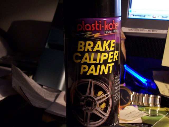

I used this. Did about 7 (light to medium) coats, 10-15 minutes in between (depending on humidity/heat). Cals look powder coated and haven't had issues yet. Just do it. You can always redue or touch up. I was nervous at first too, but sometime you gotta say WTF. Good luck!
