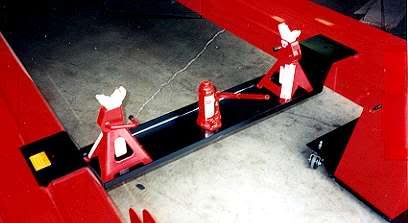

So, even thogh I have one I have not done this yet,I was wondering how you go about lifting it.
I mean I knew you used a bottle jack and stands, but I am not sure if there is enough room for all three item on the bridge.
What do you use in conjunction with the bottlejack,to span the ribs on the crossmember(as stated in manuals),and still have enough room to settle it down on the stands..
Again, I haven't attempted this yet, but it seems it may be just a bit tight under there
Any thoughts or better detailed pics on this subject?

There is plenty of room.
Use a solid block of wood to span the ribs on the crossmember. You will need a bottle jack that is on the shorter side to allow for clearance when you lower it down on the stands.
I'll search for some better pics. I didn't want to add this in my response to 69's thread because I didn't want it to taken wrong. Using 2 centerlift bridges is great but you do not have to have 2 to lift it at both ends. I use the centerlift bridge for the front and I use a floor jack (30" high lift model) with a block of wood in the rear and lift it just high enough to get a custom made block placed on the ramps under the rear pucks and lower it down on the pucks. This also leaves you clearance underneath in the rear.

Pics from their website...

More pics...
I don't like to go this high, just high enough to get the tires a few inches off the ramp and then slide blocks underneath the pucks.
