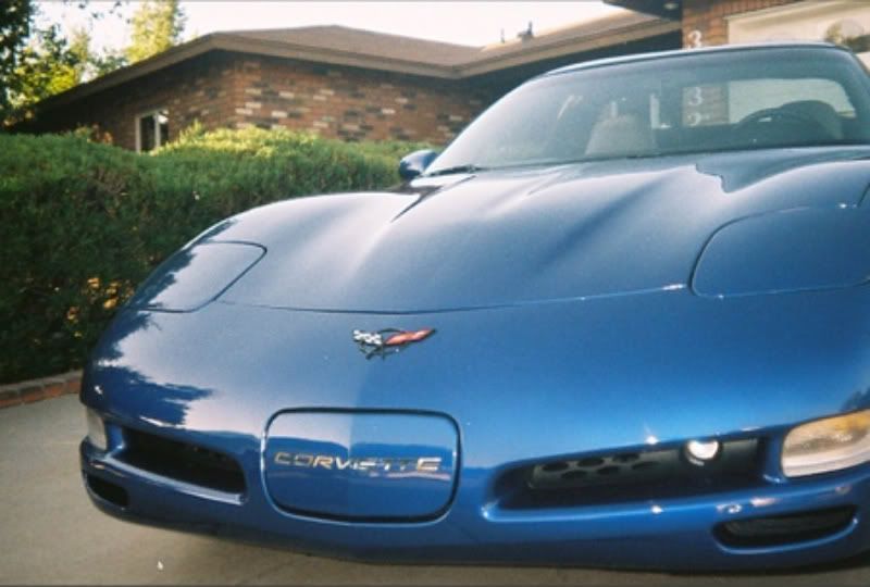

I did it about 2 years ago. I made a cardboard template, laid out the holes(1 1/4"), drilled out one side, flipped the template over and did the other side. Cleaned up the holes with a razor knife.

Can't post a pick but all I did was get out a 1 inch wood bore bit and my drill. Located only a single hole in the inside most corner of the fog light shroud. Didn't feel any need for a bunch of holes as when you're literally forcing air into the shroud area as you're driving one hole is about as good as a bunch plus it is very unobtrusive visually.
