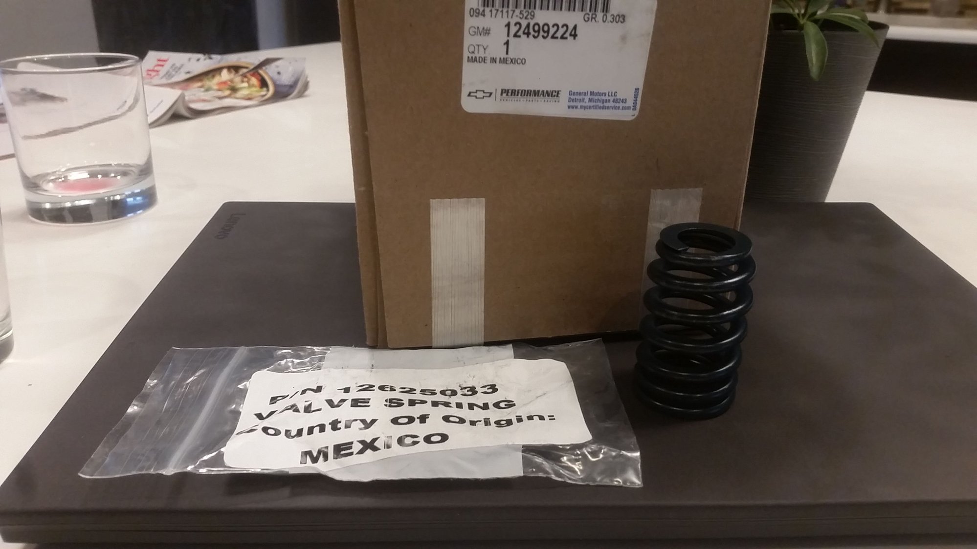

Hi all- so my valve springs came in the mail today from Summit Racing and I had 3 questions:
a) They are the correct part number, however are a dark navy blue rather than the bright blue I've seen many pictures of. Has anyone ordered valve springs recently and had theirs in the same color? I'm seeing at least one example online where they are dark navy instead of bright blue:
Amazon Amazon
b) The paint is chipped/worn off on all the valve springs, as you can see in the photo above. Is this something to worry about?
c) Has anyone used the FelPro SS71039 Valve Stem Seals?
It says direct replacement for factory and both Summit and Amazon state it fits a 2002 Z06, but just curious if anyone has personally used them and if they are a direct replacement for factory seals.
They are less than half the cost of OEM seals and FelPro is a trusted brand, so I ordered them, but just wanted to double check.

I ordered my springs from Summit and they may have been a little brighter than that, I can't remember. If the part number is correct then you should be fine.

Part number is more important than color.
Paint wear is normal from shipping/manufacturing. Keep them oiled up so no corrosion starts.

Yeah, I was just being paranoid on whether a) maybe these were used and returned, since the bags aren't sealed. or b) they changed how they manufacture them, which could mean a gamble on the quality.
I would simply install them and have fun. We could second guess a lot of stuff but then we'd never drive the car.

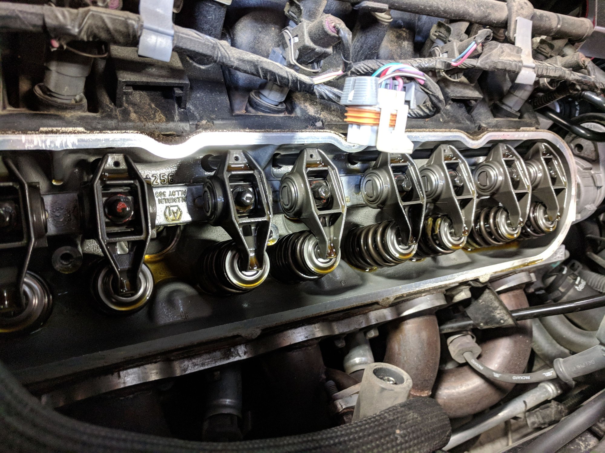

Need some help fellas. Picked up a mint 2002 Z06 with very low miles (7K). It had all the paperwork from mile 5 through 200 miles ago so am confident with the history and maintenance. The only two outstanding was the lockout and the spring issue. Fast forward, the paperwork showed the lockout was handled so now it's just the spring .
I took it to a world class place that specializes in Corvettes near me to have it 1) looked at top to bottom and 2) see if we can figure out if the springs had been replaced .
I've scoured this thread and don't see my exact issue. My springs were all metal with a yellow stripe. Can anyone verify is these are stock or aftermarket?
If they are stock I have a decision to make. Replace them now or, what I'm thinking, replace them as part of my Cam install (since they'll need to be replaced anyway).
Anyone know if I'm driving a time bomb based on this picture?
Kaboom or Nah?
To ***Build Date/VIN Analysis of LS6 Valve Spring Failures***
Kaboom or Nah?
Clearly looks to me that your springs have been replaced. I have the exact same car and my springs were completely yellow. I also posted here late last fall detailing my swap-out.
My thing is how can I be 200% sure? I can see they aren't solid yellow but did they go to this type of spring at any point for the 02's.

It sounds like you won't have peace of mind unless you swap them out, so I vote you just go ahead and do that.
