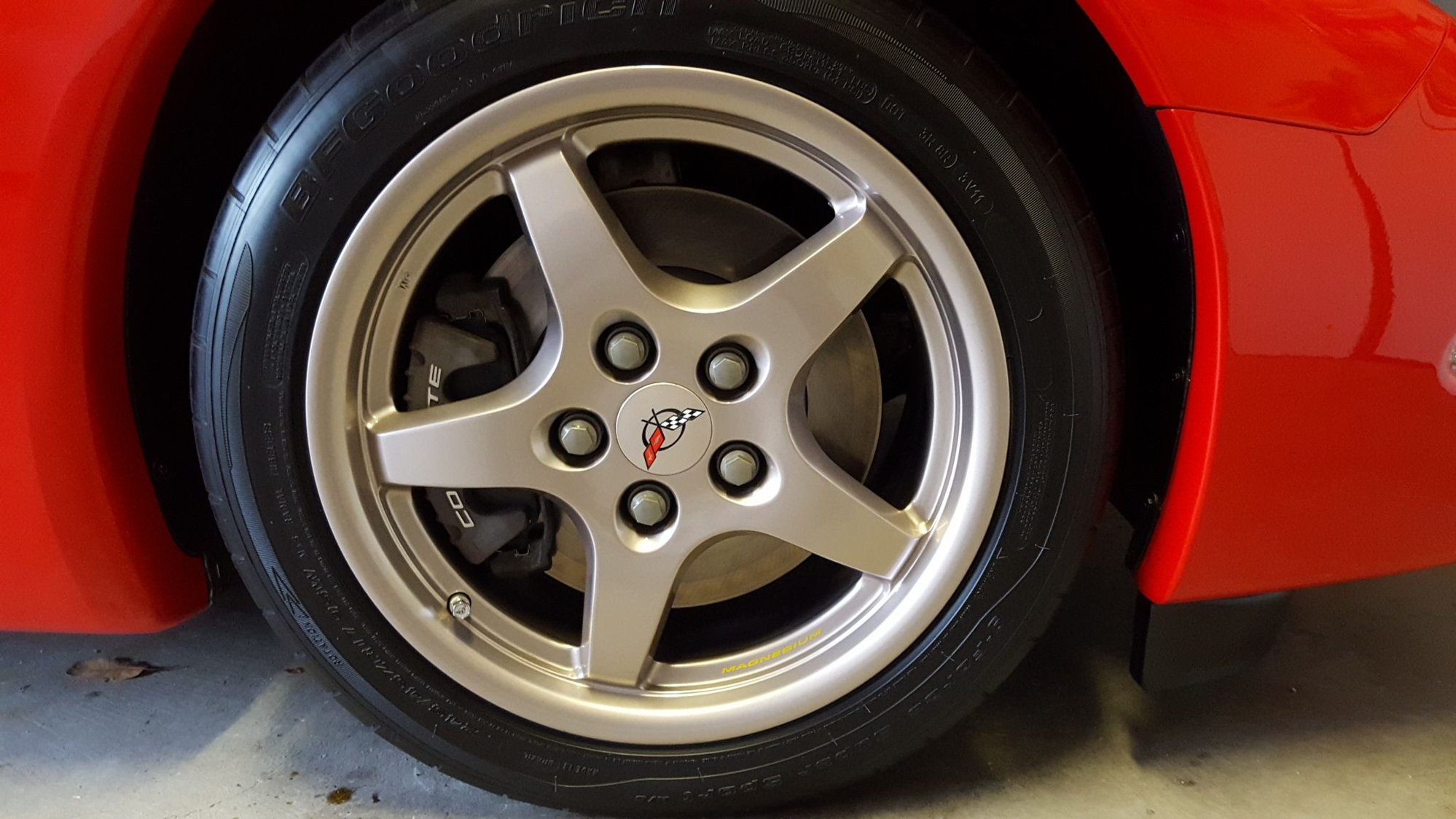

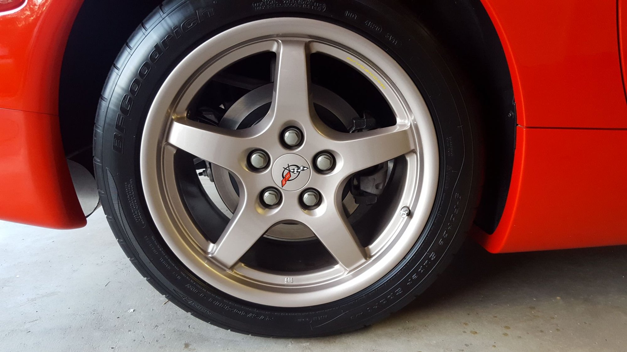

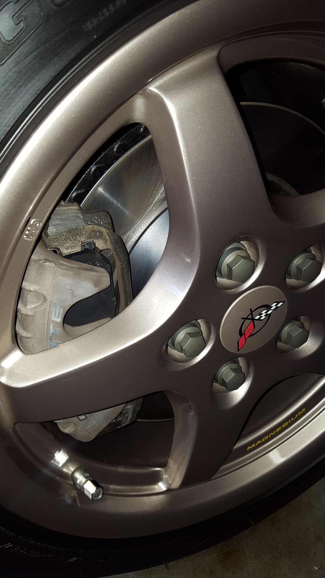

I am not sure which direction you might have chosen to go, but I thought I would follow up and post some pictures of my brake job with Centric Premium Rotors and Power Stop Z23 Pads.
