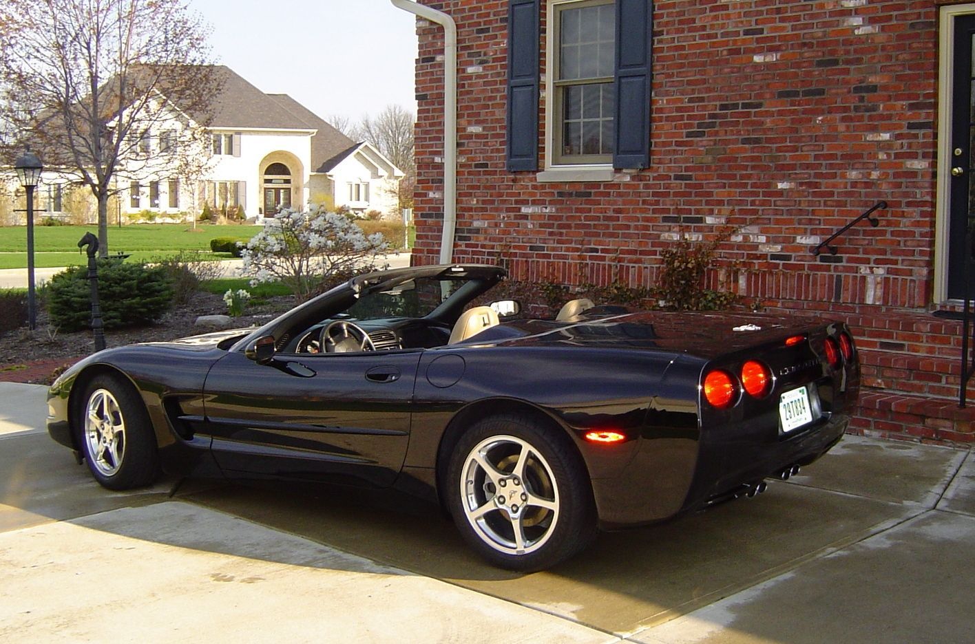

Check out my 03 black convertible with 49K mi. in the for sale section. Perfect car.
