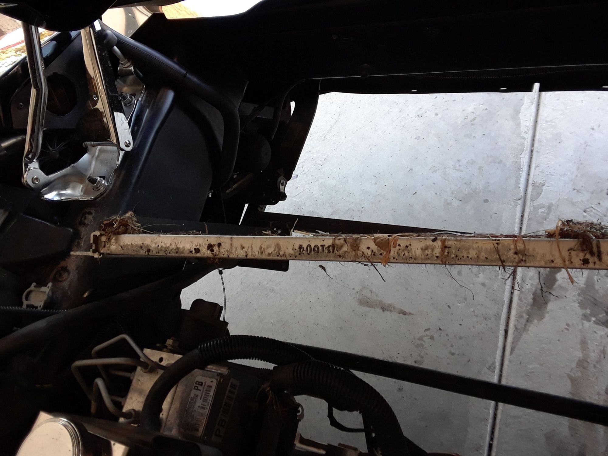

Fan assembly and radiator removal.
I disconnected the fans, and all wiring looms attached, then removed the fan assembly first. After, I lifted the AC condenser off the support tabs of the stock radiator - where I am pointing. Then, removed the radiator after disconnecting all hoses and automatic transmission lines.
-Side by side comparison of the old fan assembly and the new.
-Nice junk and crud build-up on the stock radiator...plus a side-by-side with the new radiator. *I think the new one looks better. Thoughts?

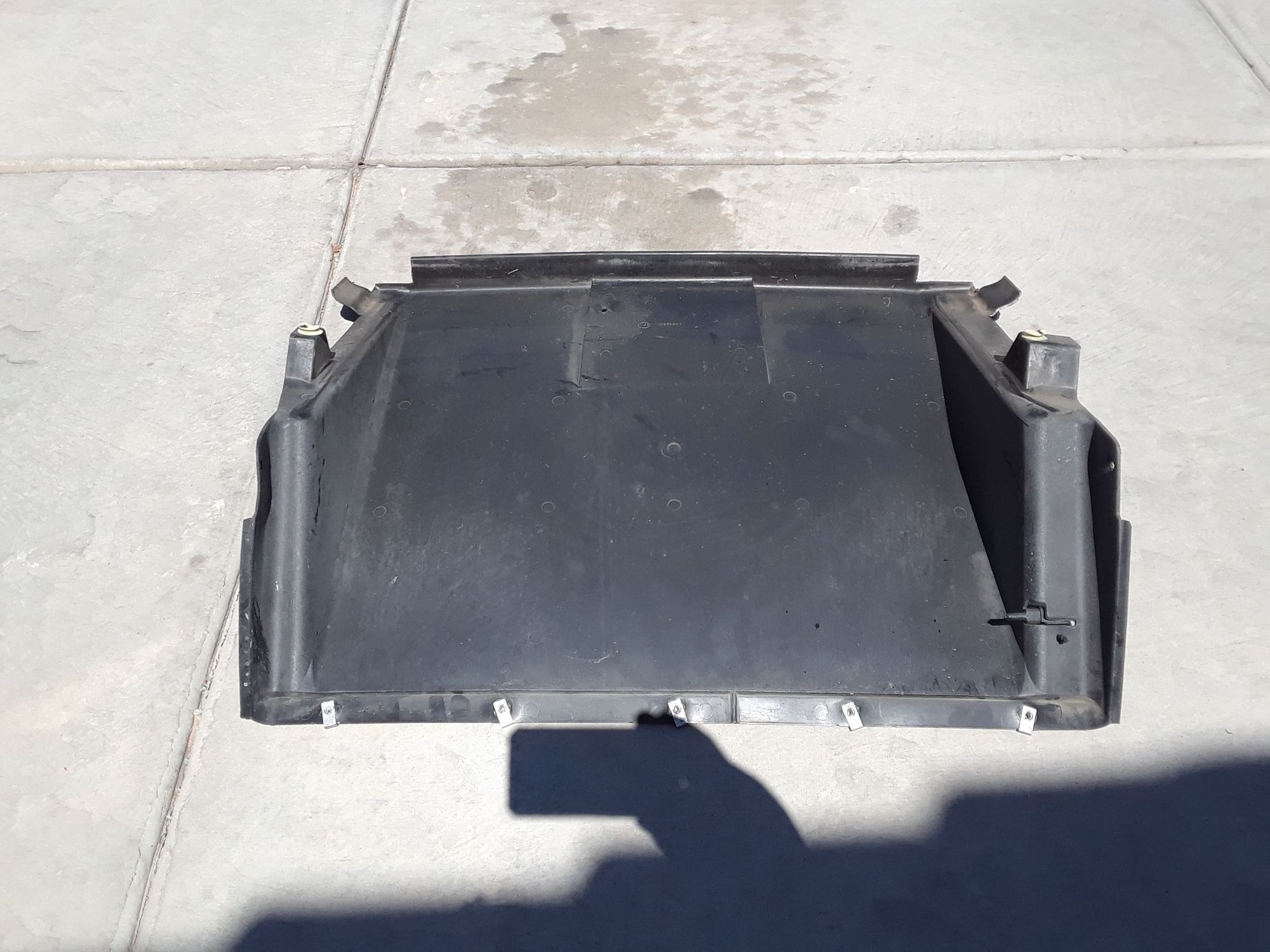

Default Parts - off.
Don't forget to take off the old radiator bushing off the bottom right of the stock radiator, and put it on the new.
I also took the whole radiator shroud off for better access to the AC condenser.
*A lot of trash in the condenser.

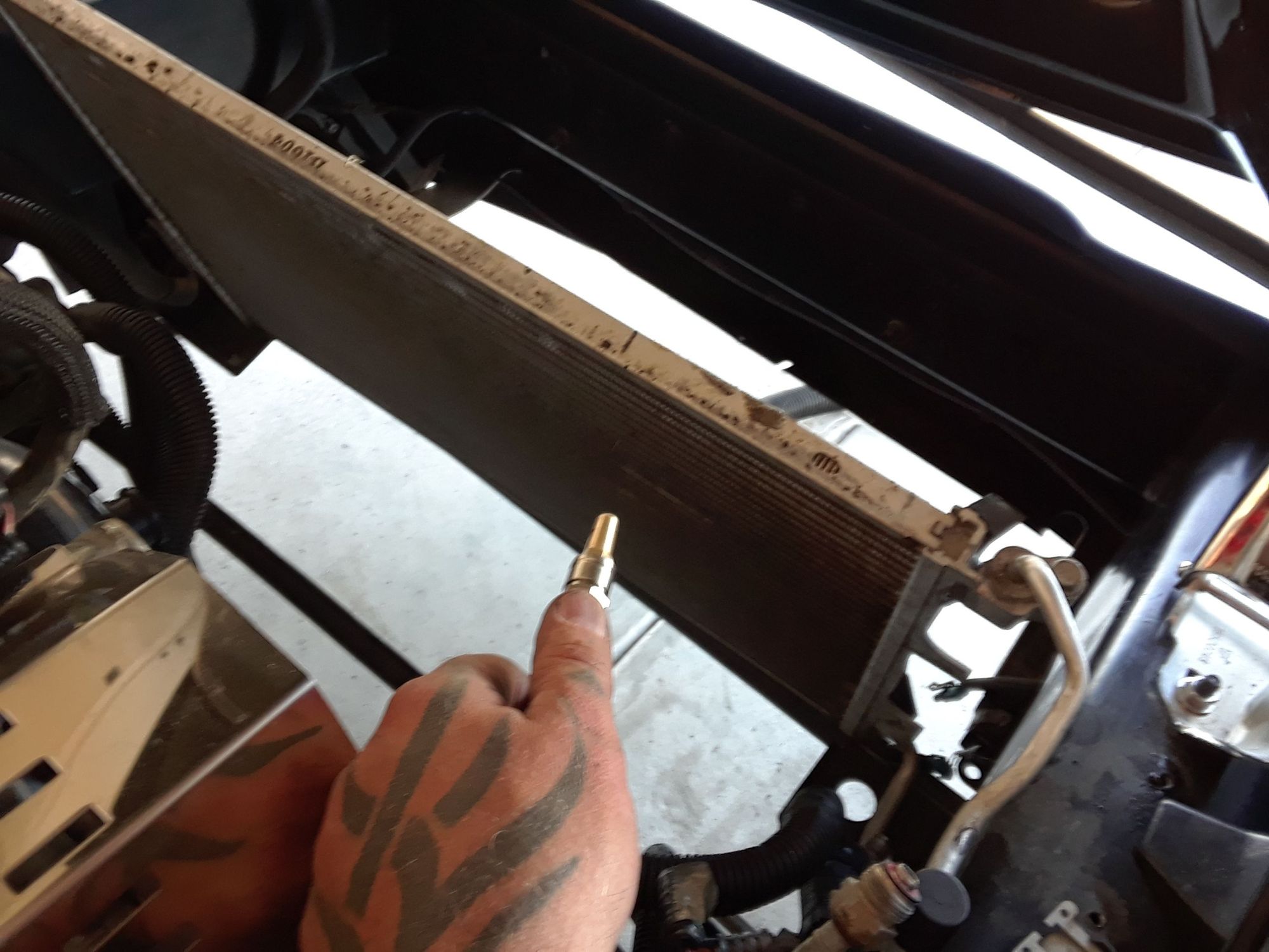

Default AC Condensor....chaulk-full-o-nuts!
You can really see now, all the junkity packed into the condenser. Had I known it was going to be this bad, I would have bought a new one too!
I started by using my shop-vac to vacuum out as much of the trash from the front. Then, powered-up the air compressor and back-blew he grunge out, row by row. did that about ten times through. After I did the same thing with high-pressure water about 6 times. Then blew it out again, followed by water...wash, rinse, repeat.
After about an hour and a half, I think I got out everything that will come out. My whole driveway was coated in dust, pebbles, grass, twigs, hair and gremlins.
IrishViking505 is offline   Reply With Quote

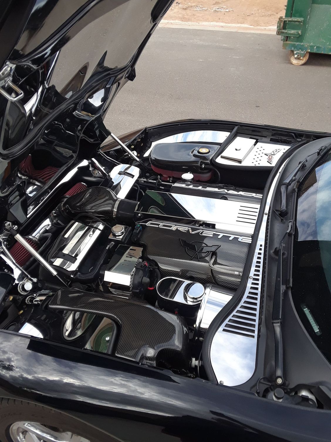

Default All new silicone hoses...
All new silicone hoses installed + the cool-it installed (as an emergency back-up, if needed).
Put all the showy stuff back on and drove it around town and on the freeway for a few hours after I was done. Never went above 208 degrees!
MISSION ACCOMPLISHED!
