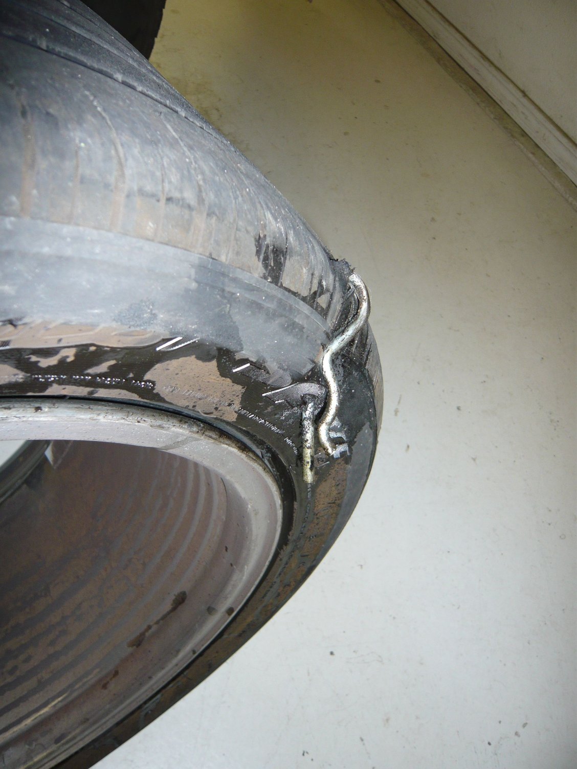

That said, I am glad I was only 1/4 mile from home when this happened to the rear tire of my 2001 C5:
Two cans od Fix-A-Flat got me there, but just barely.
