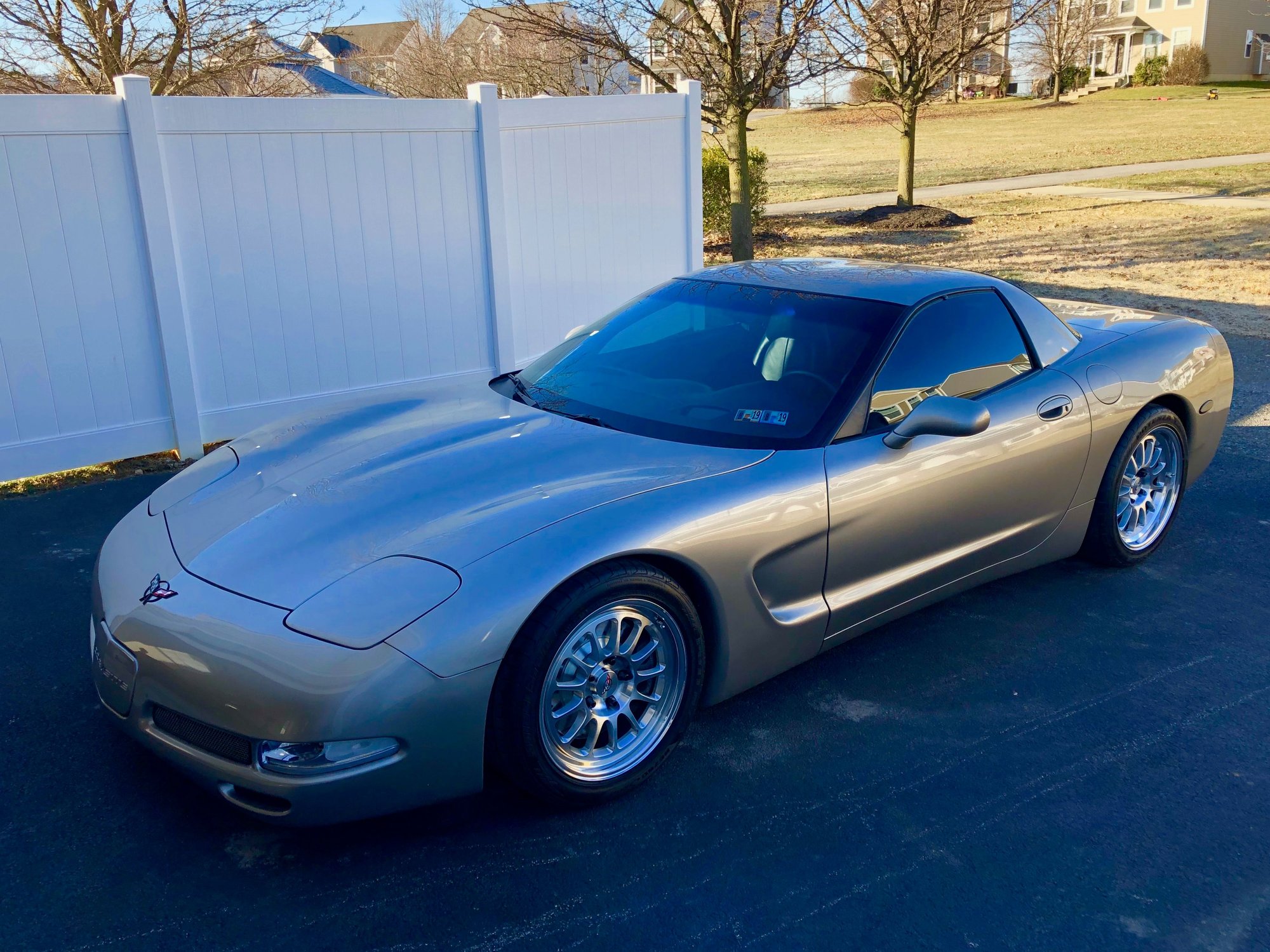

Wheel Make: FIKSE
Wheel Model: Profil 13
Front Size: 17x9.5
Front Offset or Backspace: +44mm
Rear Size: 18x10.5
Rear Offset or Backspace: +48mm
Front Tire Size: 265/40R17
Rear Tire Size: 305/35R18
Suspension mods: Stock, Lowered on stock or aftermarket bolts, or coilovers: Z51 Suspension, Bilstein Sport/B8, Lowered 2. C6 front bolts all the way down, 6.5 extended rear bolts.
Problems or Issues, such as clearance/rubbing problems: None at all

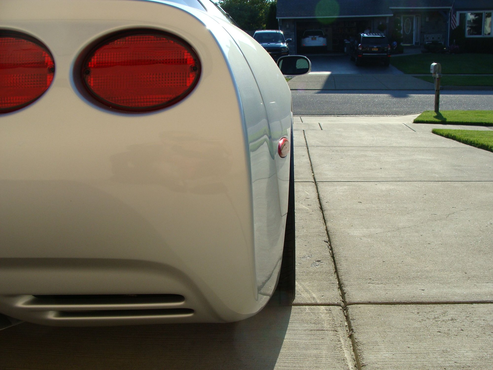

Wheel Make: CCW
Wheel Model: SP 16a
Front Size: 19" x 9.5" with 1" lip
Front Offset and Backspace: +52 with 7.30" backspace
Rear Size: 19" x 11" with 2" lip
Rear Offset and Backspace: + 64 with 8.15" backspace
Front Tire Size: 265/30/19 Michelin Pilot Super Sports
Rear Tire Size: 305/30/19 Michelin Pilot Super Sports
Suspension Mods: None - stock ride height.
Problems or Issues: None - tires do not stick out past bodywork
Misc. Comments: Great package just a lot of work to keep the wheels clean - designed for big brake package but I like to run my stock wheels as well so probably not

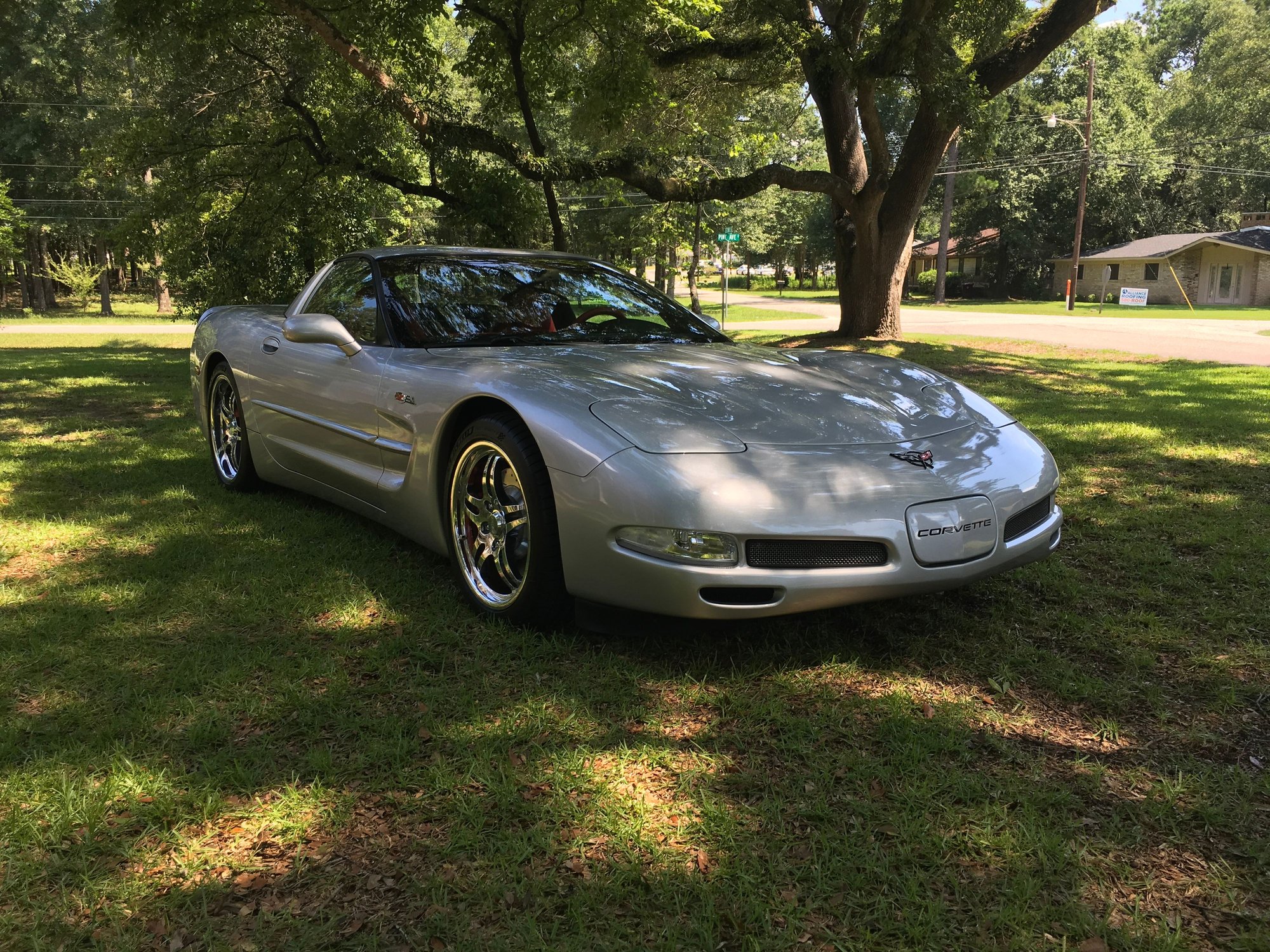

Wheel Make: CCW
Wheel Model: 505A
Front Size: 18” x 8.5”
Front Offset: ET 48mm
Rear Size: 19” x 10”
Rear Offset: ET 68mm
Front Tire Size: 245/40/18
Rear Tire Size: 285/35/19
Suspension Mods: C6Z06 shocks; lowered ~ 3/4” on stock bolts.
Problems/Issues: None.

Wheel Make: CCW
Wheel Model: SP500 Gloss Black
Front Wheel Size: 19x9.5 - 1" Lip
Front Offset or Backspace: +48 BS 7.125"
Rear Wheel Size: 20x12.5 - 3.5" Lip
Rear Offset or Backspace: +35 BS 8.125"
Front Tire Size: 275/30/19
Rear Tire Size: 345/25/20
Suspension mods: Aldan coilovers
Problems or Issues, such as clearance/rubbing problems: N/A
Misc.Comments: Setup for C6 Z06 brakes F+R and 2" flared rear quarters.
P.S. I added functional all GM parts, Z06 rear brake ducts, in place without issues.
