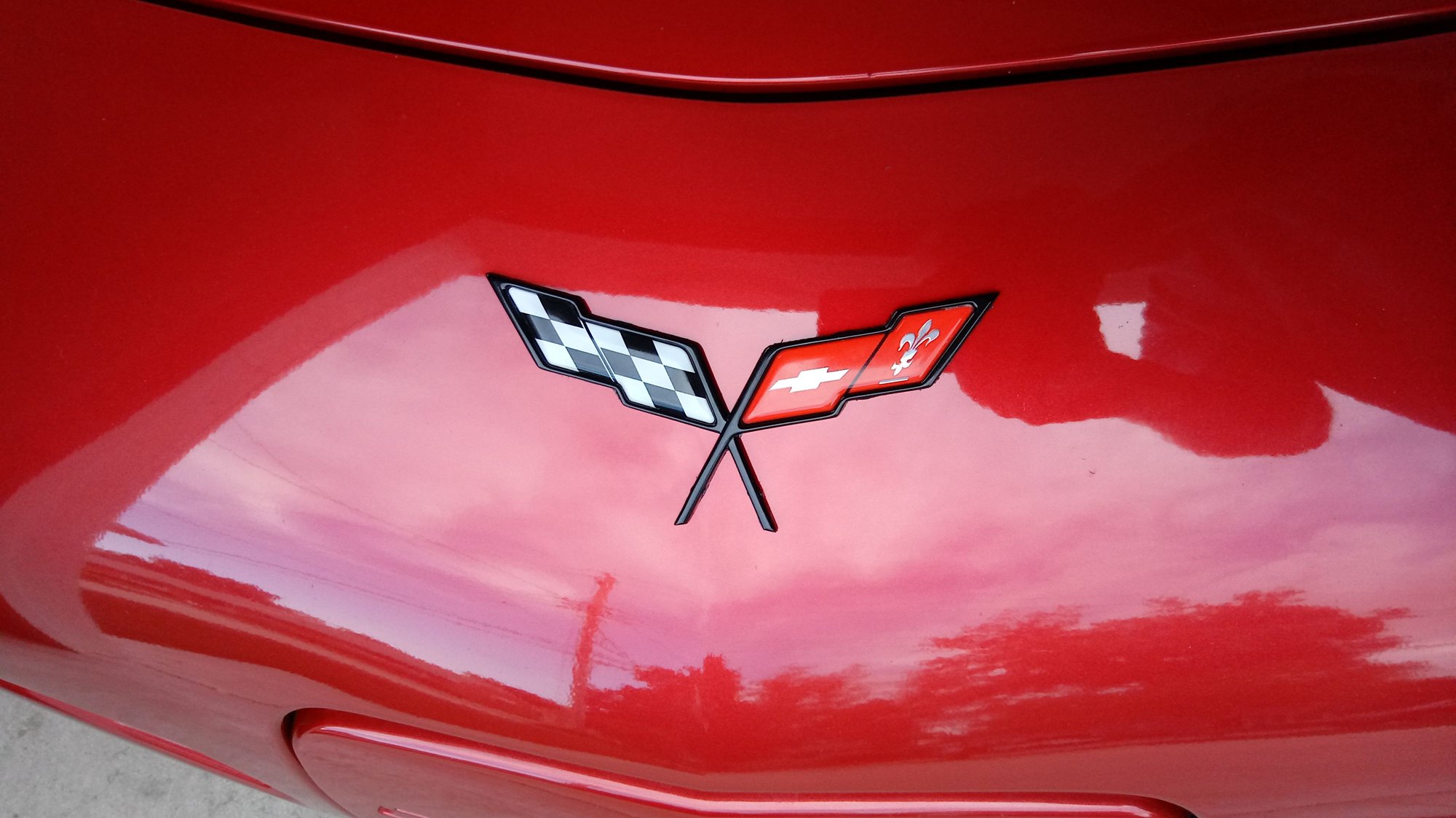

I reused my old one. Cleaned it up, removed the circle and added 3m tape. Looks good to me...

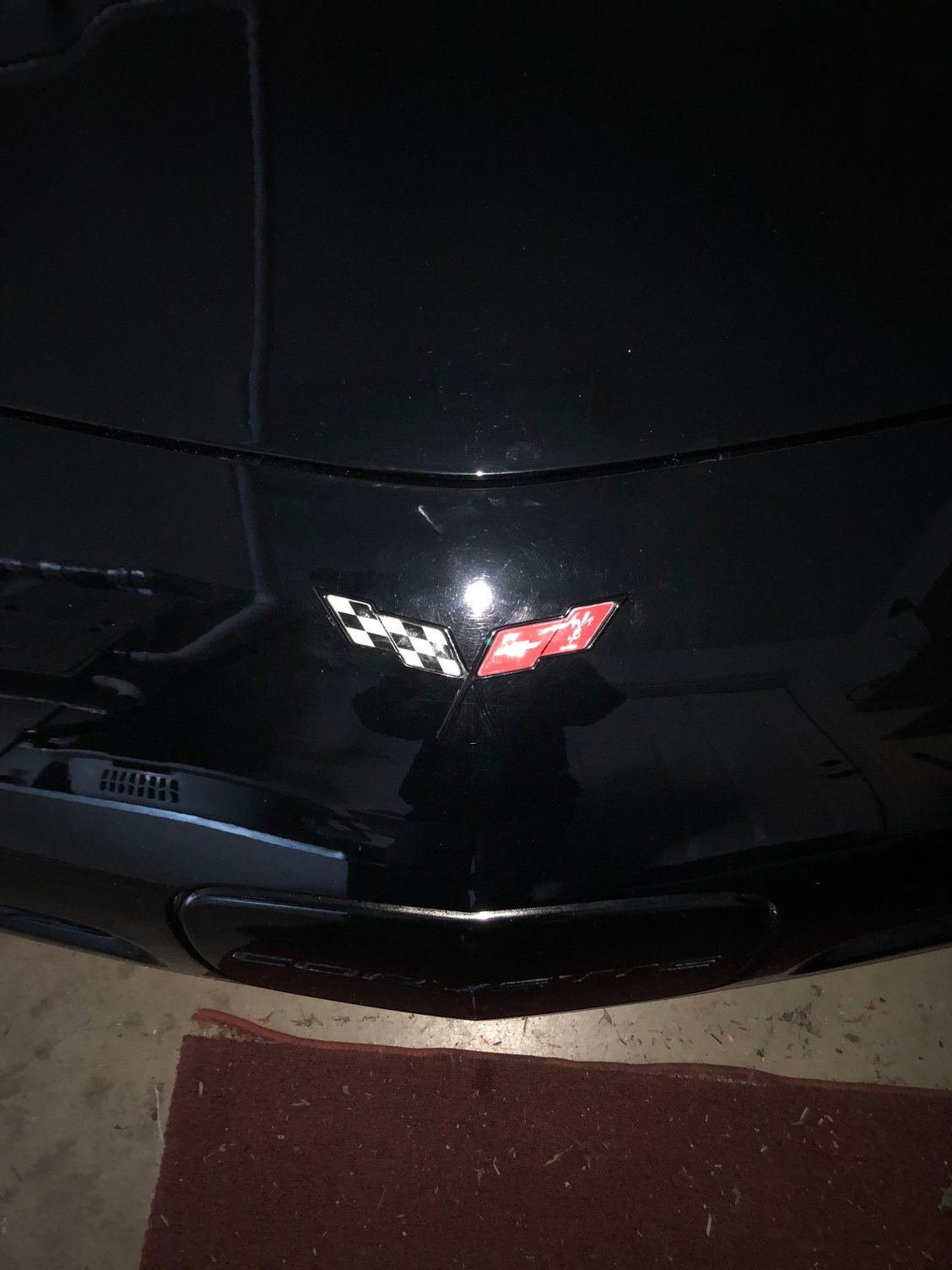

I'm puttin away my toothbrush on that front emblem........took it off, threaded the pins with a 12-24 die, now it is removable with machine nuts underneath.
