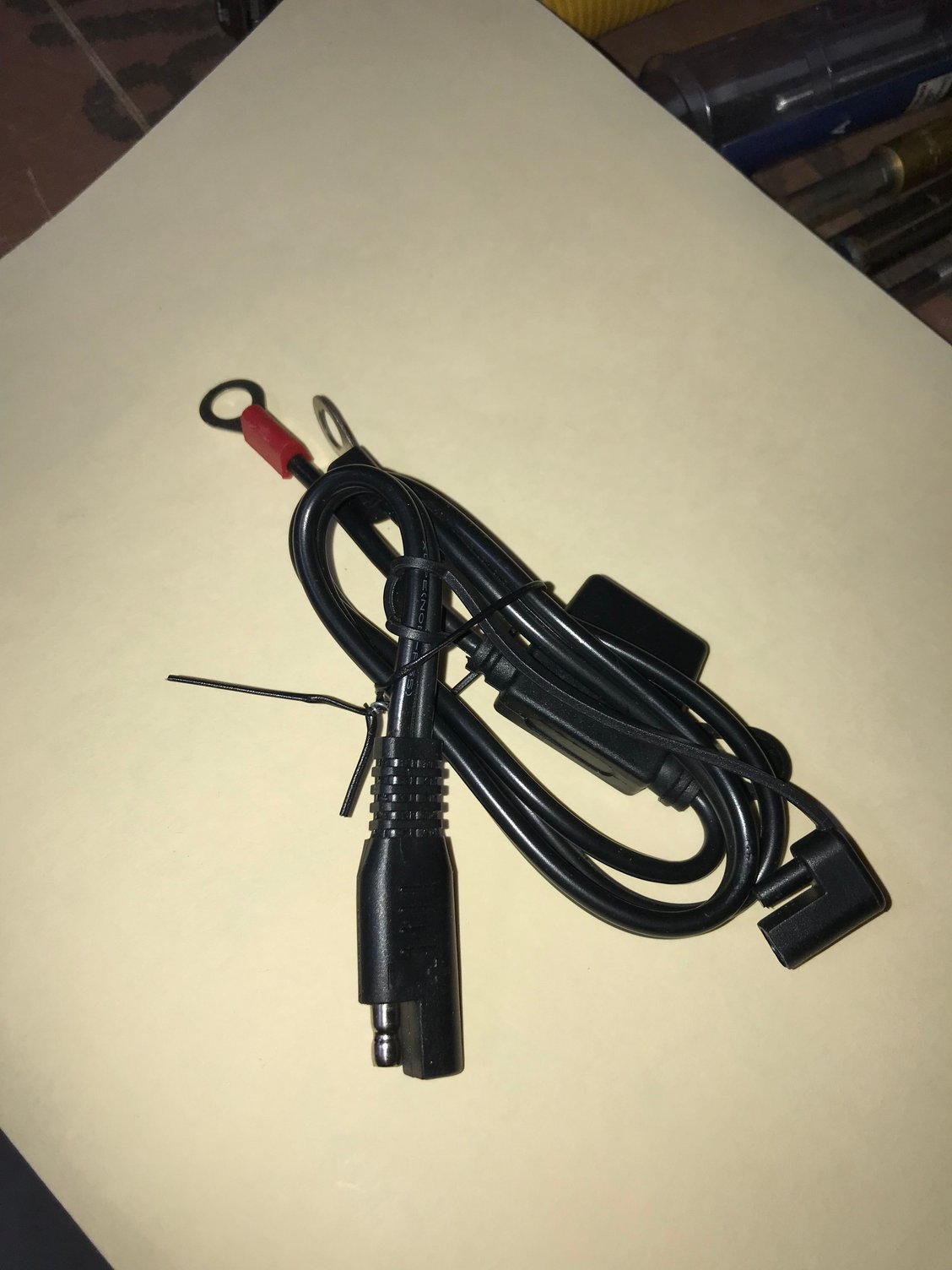

OK, I'll be the dummy to ask: What is the SAE connector? Is it the plug type connector at the bottom center
this pic?
Old Nov 11, 2021 | 06:14 AM
frodo84's Avatar
frodo84
Uneducated autodidact
Joined: Feb 2001
Posts: 5,413
Likes: 252
From: West of the Sabine, Texas
this pic?
Yes, that's it.
