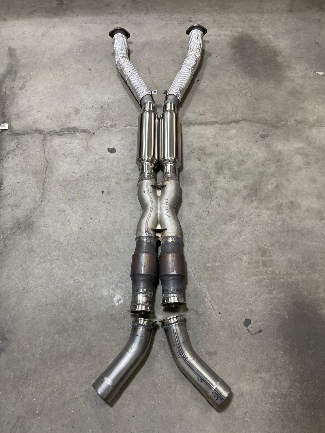

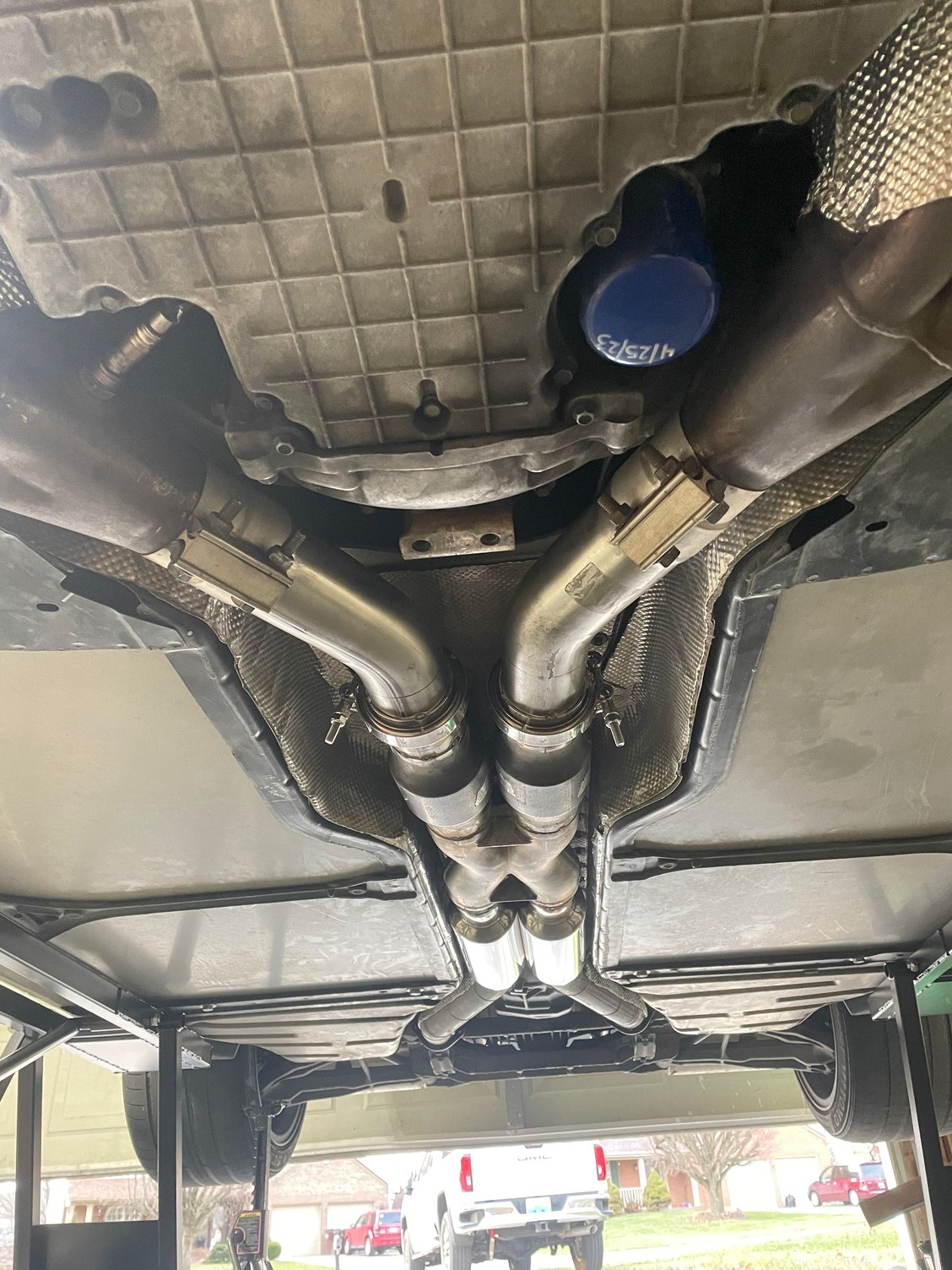

I have BTR stage 2 cam, LT's, catted X pipe with 12" resonators built in and Corsa Sport.
IMO best exhaust I have ever had....and I'd had 8 different combos on my car. Corsa Sport can still be loud/overbearing. First 6 mo-1year is fine but the cold startups and over 3k it still can be loud....however no drone. To give it a more touring feel I added 2 12" resonators in the midpipe. Still no drone but gave a nice deep tone but still can hear the Corsa in it.
Damn near silent on the highway.

There is no drone with Corsa. HOWEVER, the level of sound inside the car CAN BE loud at some times. Normal driving and pulling RPM's through 2000-2200, the exhaust can open up so coming home late at night or early morning cold starts it is loud. No getting around it unless you short shift a lot and nothing you can do with cold start idle. Above 3000 RPM it can get ear piercing loud. FWIW, it took me about a year to get "fed up" and wanted resonators.
I added resonators to kick down the rasp and lean more toward a "touring exhaust" that works well 95%+ of the time. I do admit, idling into a parking lot etc I do miss the louder "pre resonator sound" that would turn a lot of heads, but that is a low percentage of time I'm doing that.
I'm a LITTLE tempted to swap out the two 12" resonators for some 4-6" ones to give back a little more tone of the Corsa. The way I have it now, it is damn near silent on the highway and road/tire noise is noticeable louder. Makes for a great cruising car with the wife. I don't care much for a very loud exhaust as that just screams "look at me" and when your bar is louder than your bite I just shake my head. People liking BB Bullets or Corsa Extreme just confuses me. It might be cool for a week, but living with it hell no.
