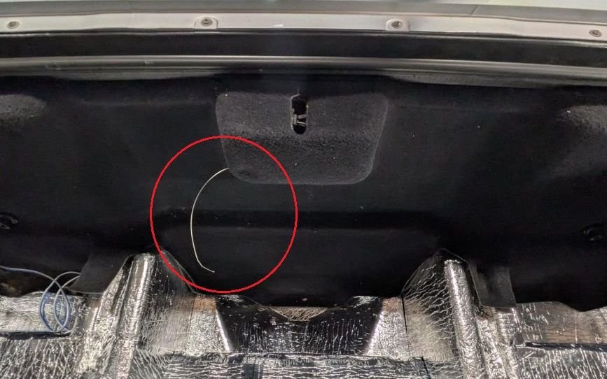

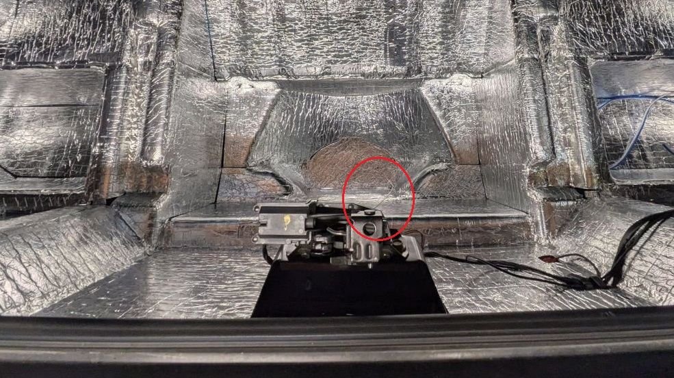

The trunk latch release cable hangs down toward the bottom-front of the mechanism. To access it you'll likely have to pull the carpet out from the back wall (the top of the carpet is also tucked a bit underneath the lip below the trunk weatherstrip), and after pulling it toward the front of the car you'll be able to find/feel for the cable.
Just the other day I snapped a photo from my sound insulation project where you can kinda see the cable:
Also I poked a small hole through the carpet to bring out the release cable (though afterwards I mostly tucked it back in to the carpet). This shows another view of the cable's location:

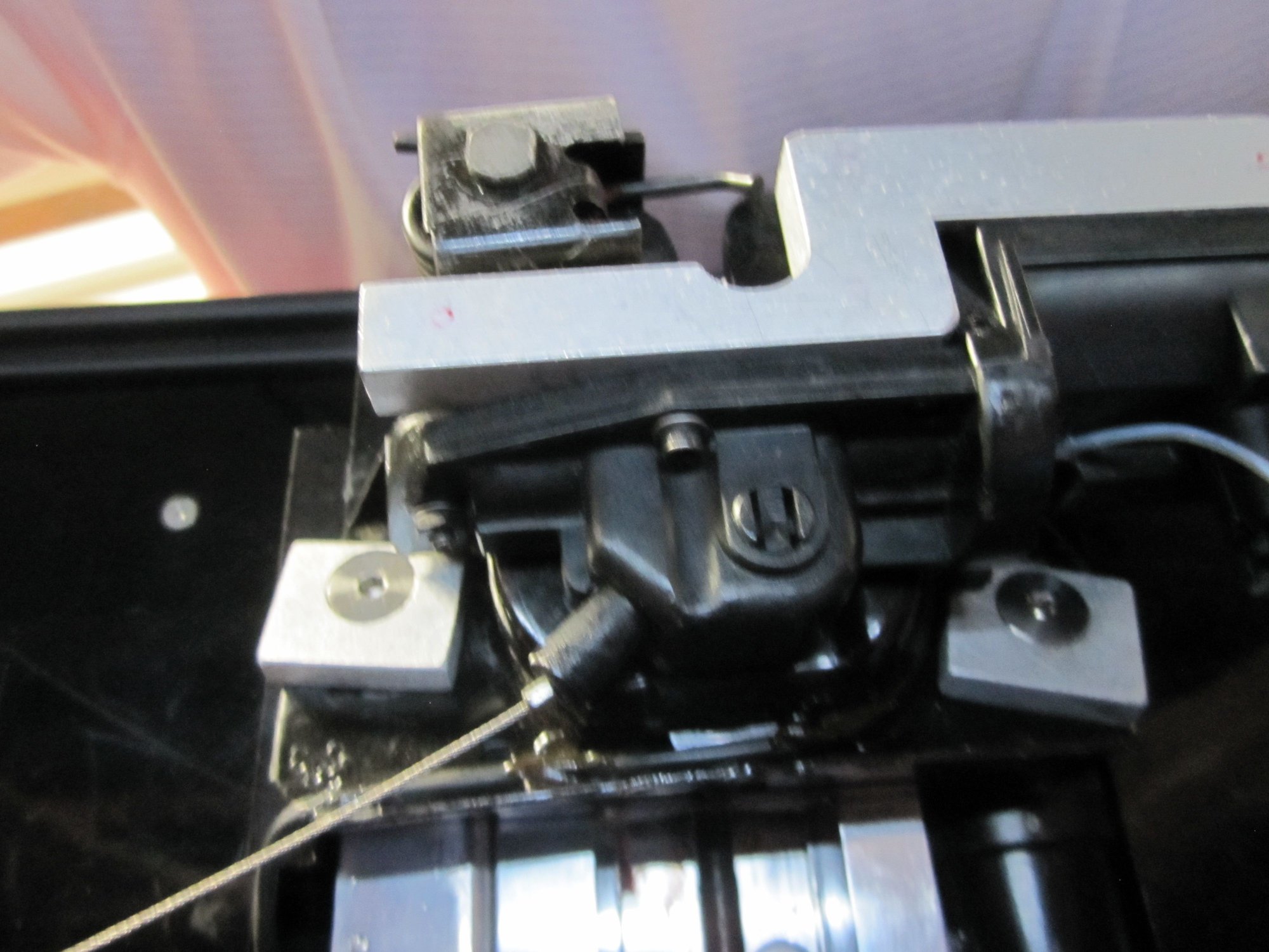

There's supposed to be a thin metal cable that exits the center latch from the passenger side, about 15" long measured from the latch. Here's a picture of the latch facing the rear of the car. You can slso use a screwdriver to release the latch in that black slotted spot in the center of the picture. Disregard the bright aluminum parts in the picture, I added them for a trunk pull down.

The small but strong spring at the top of the latch (see photo above) is what does the heavy lifting when the latch solenoid is energized. If that's ok check the latch opening to trunk lid staple alignment, if they are off too much it will cause binding which increases the force the spring has to overcome. The two latch fasteners are where this alignment is done. Also, the latch internal parts need to move freely and not bind up from old grease or dirt.
