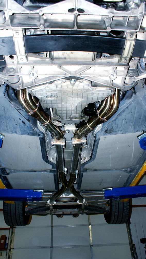

Below: Drivers Header Underside Clearence (I know my ground strap is hangin, I gotta lengthin it to reach the frame. It somehow got cut.
Below: Passenger Header Underside Clearence
Went and put her on the lift today to take some underside pics and show some close clearence areas on the passenger side.
