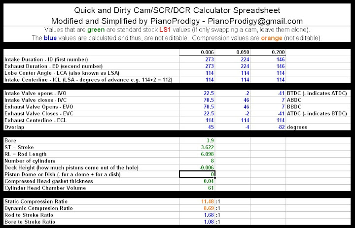

Ok so here is what I figured out with a DCR calculator and the cam specs:
What do you guys think?
Now I just need to figure out if there will be any PTV issues.

Looks like you're planning on using Cometic gaskets@ .040. I would back off that CR a bit for 91 oct. and use GM MLS @ .054-60 compressed. They're alot cheaper, too.

I would keep the gaskets and not mill quite as much.

So staying with .04 and 62cc=
For 91 octane, that should work very well.

what Y2Kvert4me said
the .041 gasket will prevent knock better than the GM .053 gasket.
62cc minimum chamber. the shop can cc your head now and tell you what
you are starting with. adjust the chamber cc as needed.
8.58 DCR is great with a good tune you will have a nice setup
