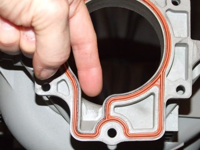

Sounds like the way you shaped a part of the TB housing may be your problem then. You may have a lip near the blades transition exit away from the TB housing (where it starts to open away from the body of the TB).
Look for any sharp edges that could create a whistle....I have never had any whistling issues with any of the 90mm stuff.
Only the FAST 78 due to a sharp edge in the entrance of the manifold directly behind the TB as shown here (this pic shows the problem area after I radiused it with a grinder to eliminate the whistle completely). It was an extremely sharp 90' corner as delivered from FAST but this issue isnt applicable to any of the larger FAST intakes....only the 78mm version.
