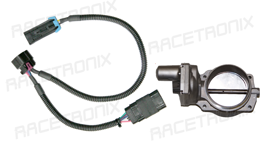

The only caveat I would offer is in regard to that particular Caspers harness adapter. Look closely at the end view of the flat, six cavity connector and you'll see 2 open holes. That connector uses a silicone weather resistent grommet just like all the other Weatherpack/Metri-Pak connectors so leaving those 2 unused cavities open to atmosphere (water/moisture/dust and possible corrosion) makes no sense whatsoever.
I can't understand why Casper's does that, when all it takes is two "filler plugs" or a small glob (technical term) of silicone squeezed into them to seal the connector as the design intended in the first place.
Racetronix on the other hand doesn't cheap out and actually plugs those two unused holes (you can see them in their picture between the blue wire and the pink wire where they exit the connector body) and on top of that, the Racetronix harness is $5.00 cheaper in price than Casper's.
http://www.racetronix.biz/itemdesc.a...2DTBAH&eq=&Tp=

Originally Posted by LoneStarFRC
Good info Mark and a sweet deal too.
