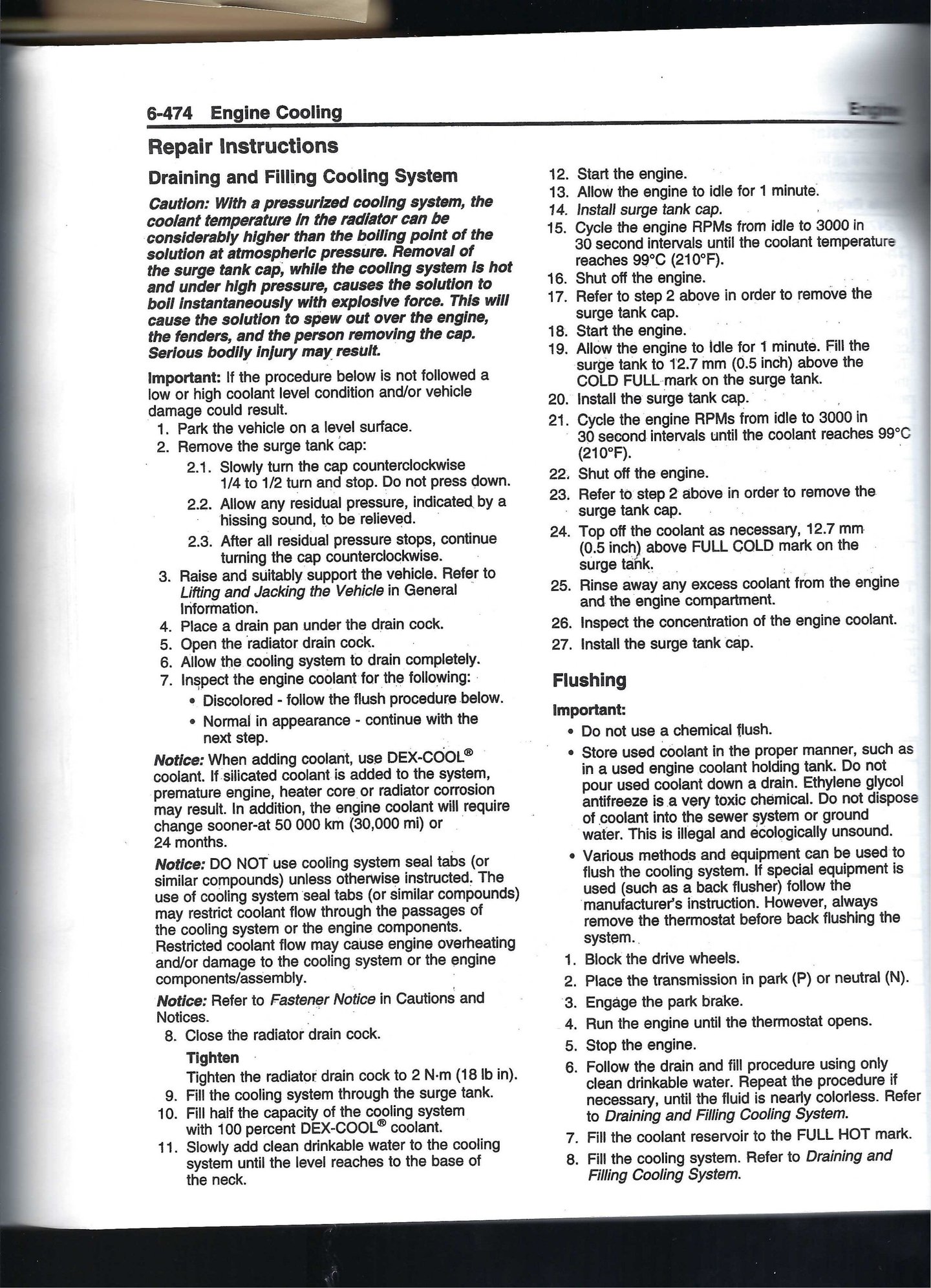

Any time you drain or otherwise open the cooling system you must perform the Factory Service Manual air purge procedure. Otherwise there will be air in the heads and overheating.
