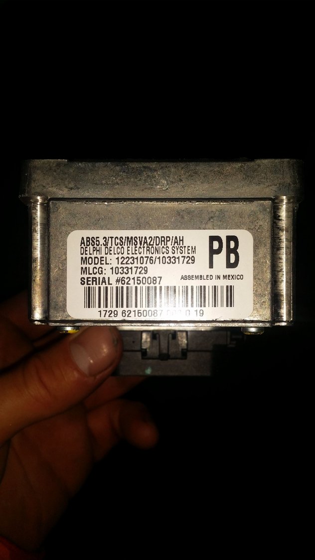

I posted this thread in the Z06 threads but no help. Now I'm hoping reaching out to all C5 owners I will find someone who's been in this situation. I can not separate the module from the pump assembly.
I am afraid of breaking the pump assembly and or the module so I can't use it again after it is fixed.
This is as far apart as I can get it. I have been prying on it with a screwdriver going from side to side. However it's about done moving. I am bending the pump assembly a bit much and I am afraid that I am just doing this wrong. Please advise.

I have this from ebay to replace it and then I will repair the one coming off the car for future use.
