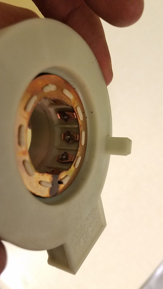

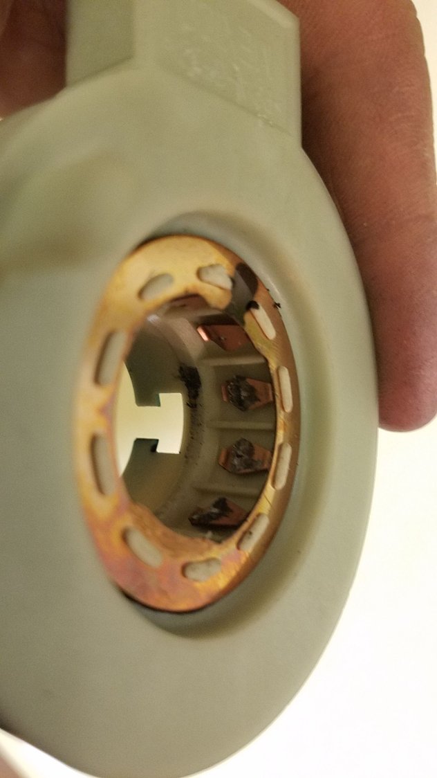

I just finished replacing the swps. Not too bad of a job, took about 2.5 hours. I didn't pull the whole column off, just out enough to slide the old off and the new on. I can see why I was having issues.
I didn't drive it yet but started it up and let it run a little. Turned the wheel several times lock to lock and then several fast. No codes. Cycled act handle and TCS on and off.

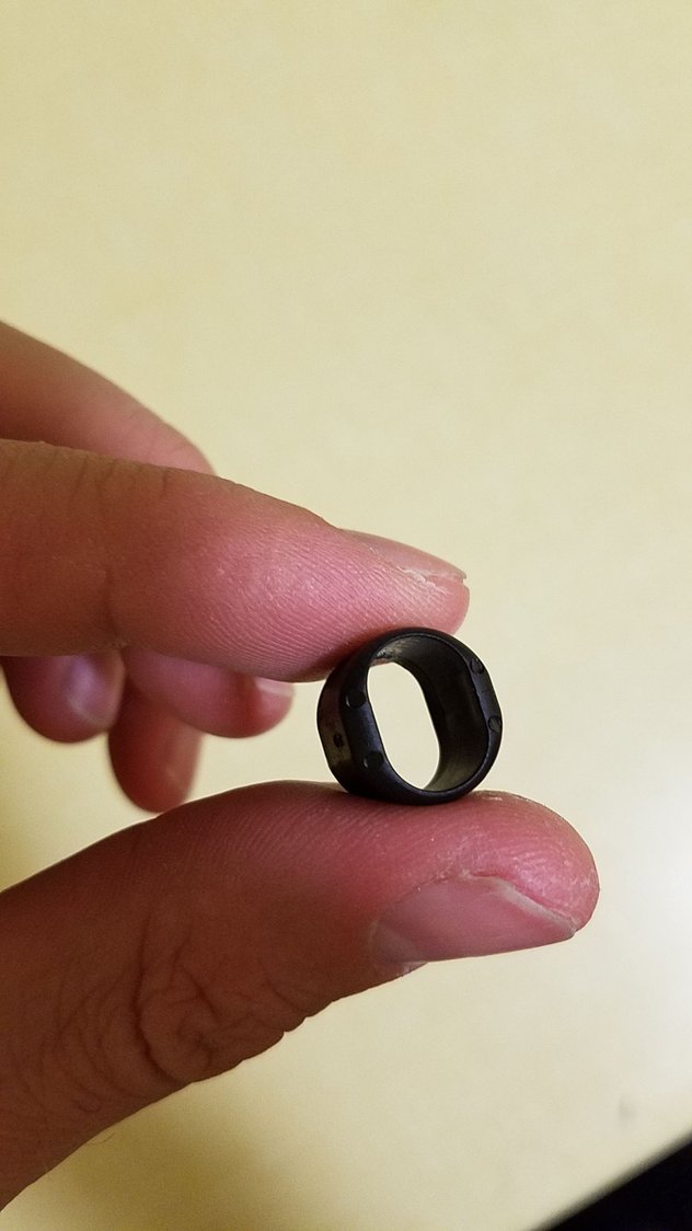

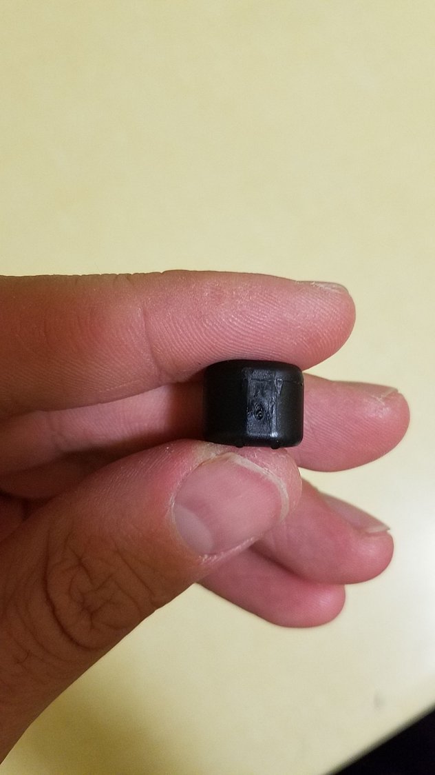

During the removal of the column, this fell from somewhere. Plastic.
Can't be too important. Right??
Anyway, thanks for pointing me in the right direction! I'll update with success or failure.
