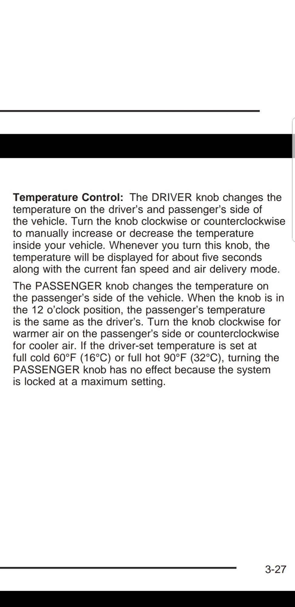

my 2000 convertible has been in the local Chevrolet dealership for the last 30 days to fix the A/C. They replaced the compressor and one of the ac tubes. They cannot figure out how to make the passenger side of the dual zone system work. you turn the **** and nothing happens, no display change, nothing. HELP

Maybe you and the dealer should take a look at the owners manual together. It is not supposed to change the display and the temp change is not dramatic. Thirty days and they still have the car? Unbelievable......
Yep:
