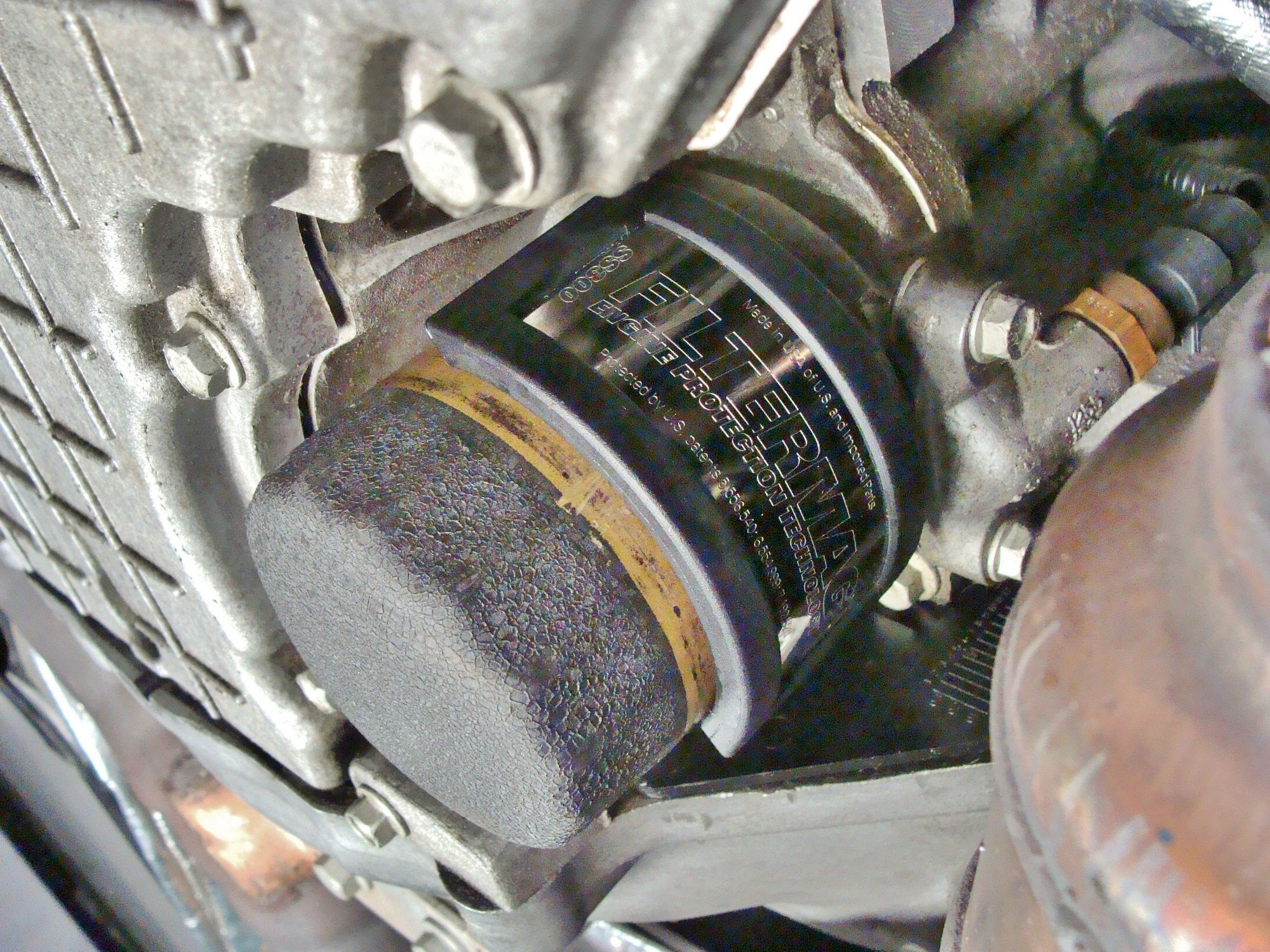

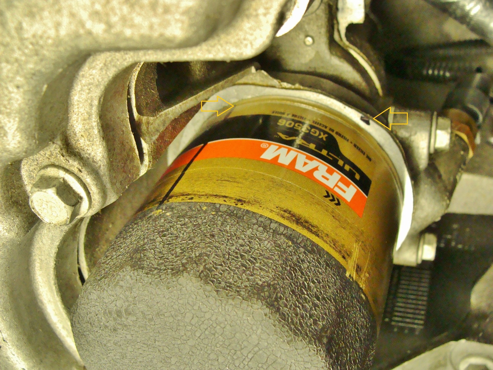

So the answer to the question asked here about how much does the filter rotate at 22ft lbs of torque is noted in the picture below, which is more than 3/4 turn but less than 1 full turn.
I used my inch lb wrench set at the highest setting which is 250" lbs & that converts as 21ft lbs.
I also this year added a Filtermag, won't see the results till spring of 2021, just curious to see what I find, my car has less than 11,000 miles, probably better to use when new, but I wanted to see how it performs. I also upgraded my drain plug to a Neodymium, a lot stronger than what I had.
