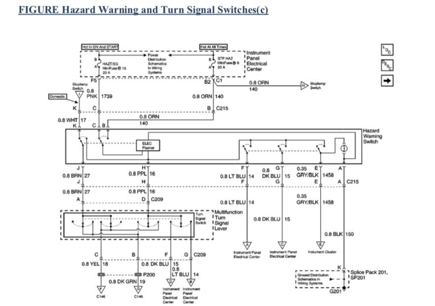

It's not terribly difficult. The turn signal switch part of the MFS takes the power wire in from the brake switch and the power wire in from the flasher. It switches those inputs to the correct output wires via a bunch of contacts, which gives the correct signal and brake light functions. The contacts for the signals on both sides and for the left rear brake lights are all OK. The contact for the right rear brake lights is bad.

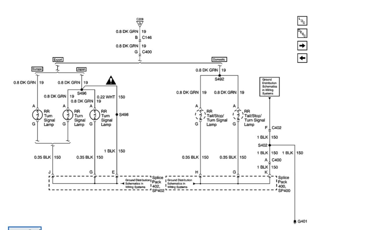

The signals comes from minfuse 8 through the stopswitch . You may have a problem along current loop 19 to the rear stop lamps .
Check the voltage at the B output of the multiturn signal level

Following the schematic rules out the hazard switch without spending any money....
