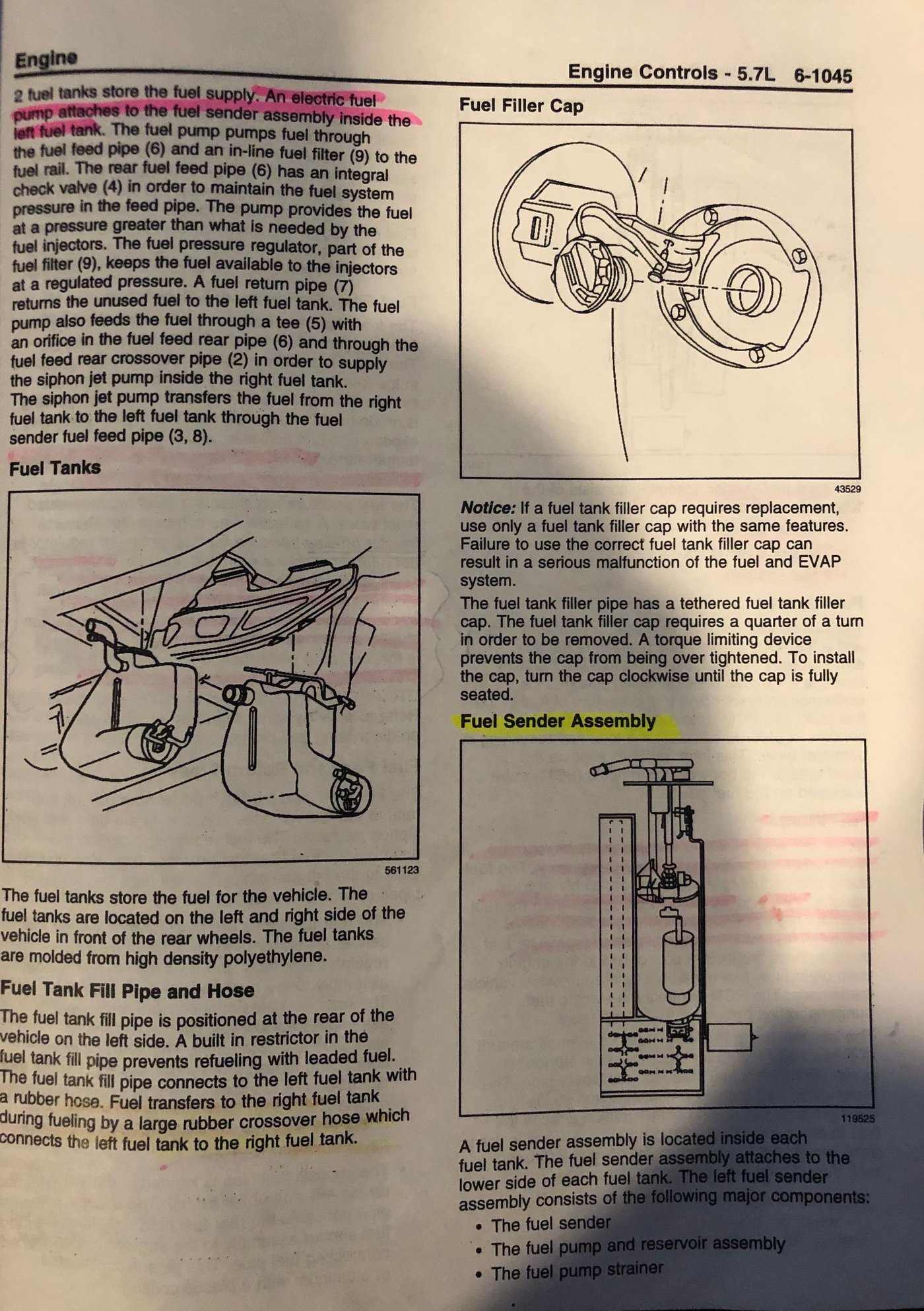

Originally Posted by Ulost86
Yeah we went over this the other day, you and I. He was unfamiliar with this fuel system as was I, and was going to research before going further, as was I. I don't seem to have the issues of a failing siphon pump so that kinda narrows it down to the check valve.
This was from my ‘01 FSM...yours should be basically the same !!
Old Jul 21, 2019 | 08:29 PM
  #45
Ulost86's Avatar
Ulost86
Joined: Jun 2019
Posts: 31
From: ND
I have a similar parts niche pulled up. This is where I'm getting my 10448899 part number that is now obsolete🤦 Like I stated earlier, I found two new ones. Only problem being is that one is followed up by -18 and the other -33. Not sure if there's a difference or not. Waiting for the company, White Racing Products, to email me back
