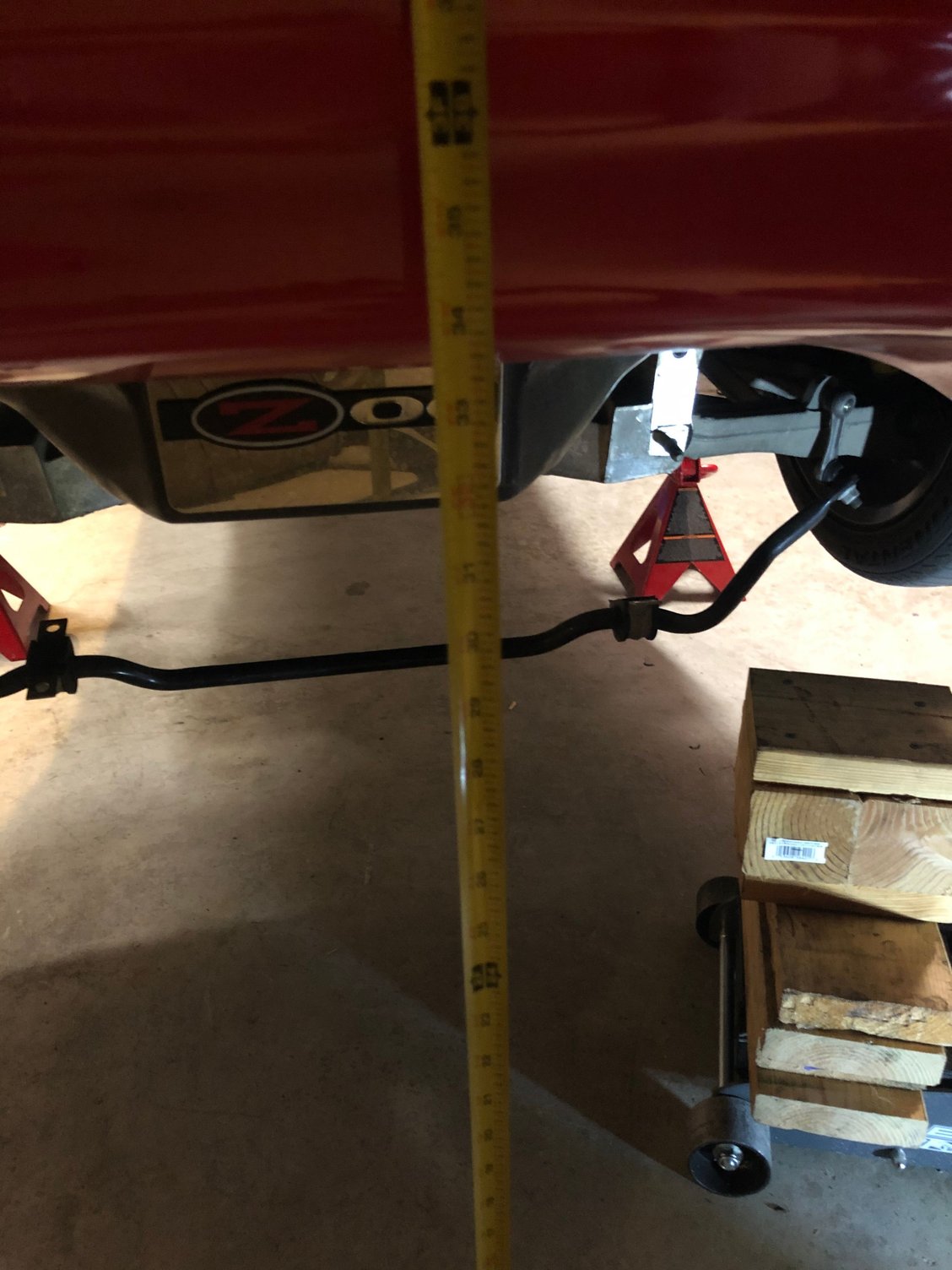

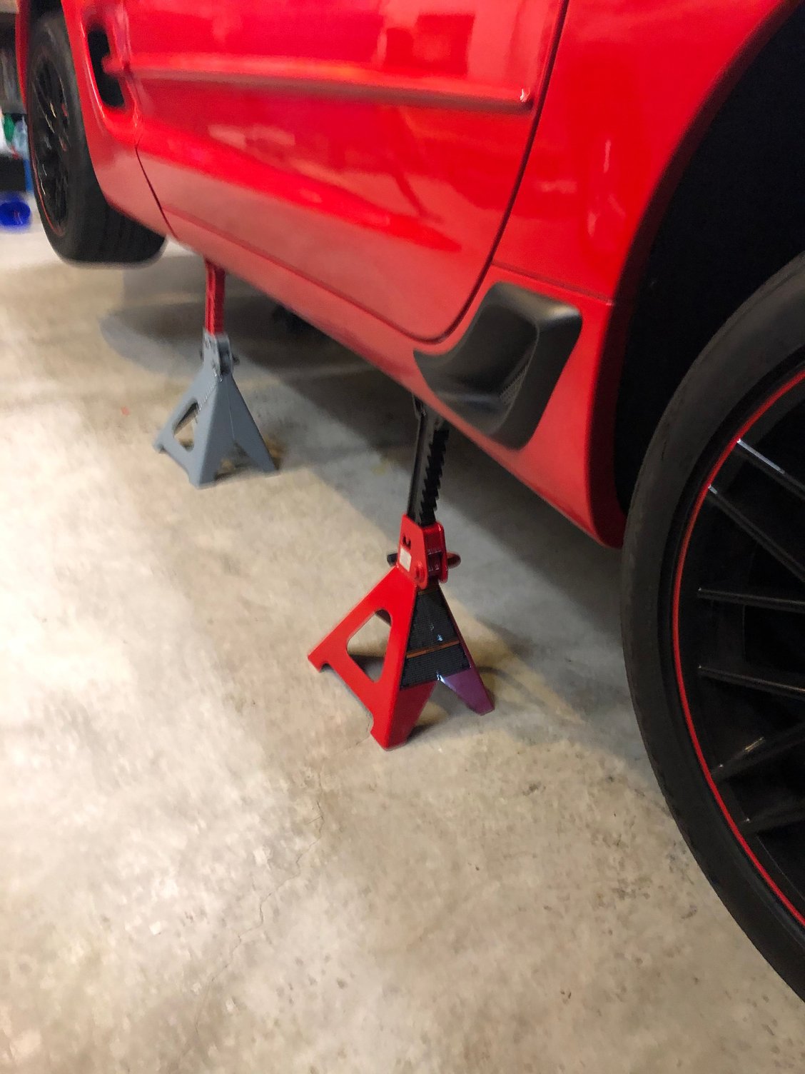

I just pulled my Ti exhaust while the car was on 6 ton stands. It was not comfortable, pleasant, nor something I would care to do again.

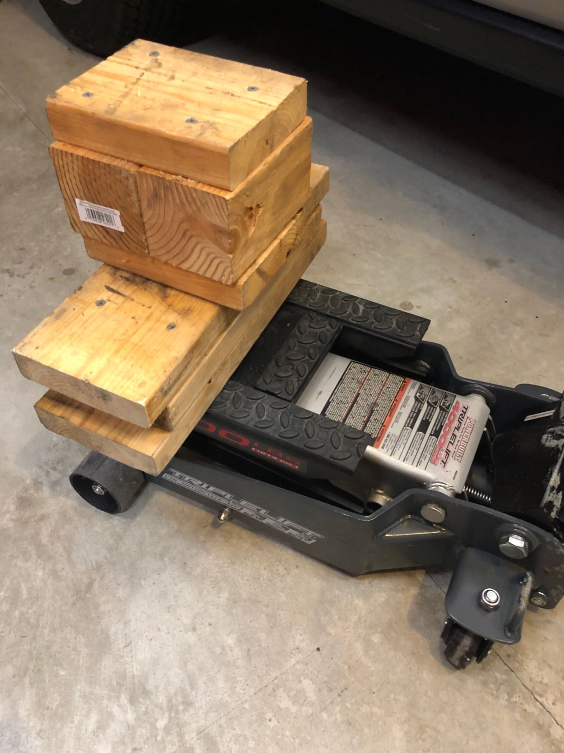

After inching the car up as high as I could get the 6 ton stands to go, I had to then use my wood blocks I had previously built to raise the car EVEN HIGHER when it came time to thread it out. As it sits safely on the stands it’s 34 inches at the rear bumper
I had to raise it another 4 inches on a triple lift floor jack with wood blocks I had previously built to get the required height.
I put a stand under the front cradle in case it started to tip on the 6 ton stands. But it didn’t feel real cozy, but it worked. If you are even remotely nervous about to GO RENT A LIFT OR PAY SOMEONE.
I had resigned to renting a lift until I got it up on the stands and said to myself “mama didn’t raise no bitch” and slowly and carefully went at it. So it’s certainly possible as others have said but not ideal.

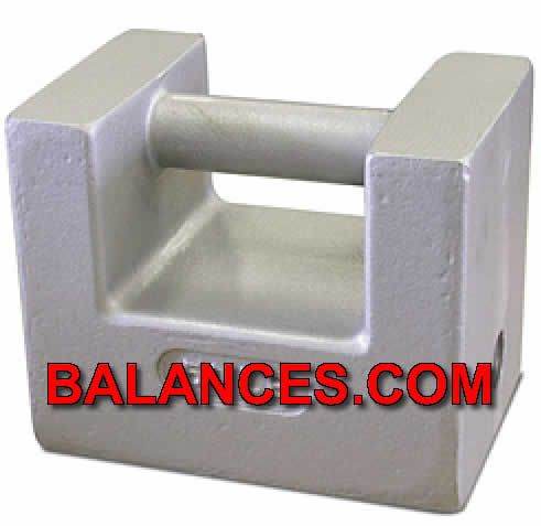

It's not the load rating of the stands, that makes this deal sketchy. It's that 99.9% of the stands out there are referred to as "axle stands", and as such, their "cradles" are rounded, so a car's rear axle can safely "nest" in it. If you're using "jacking pucks" inserted into the car's side lift points, then you want something that's flat, and will give the car stable support.
I consider myself somewhat lucky, in that respect, as my late father was in the scale business, and he acquired (4) 50 pound test weights. He originally used them for "ballast" in the car's trunk, during the winter. I now use them as "stands", and if I need to get the car higher than just the weights alone, I have a number of pieces of 2x10 wood, to place the weights on. They're stable as all get out, and it would take an earthquake, to knock the car off of them. Example pictured below.....

I agree with you 100% and recognized the same thing with the jack stands. I found actual hockey pucks with an eye bolt installed fit the concaved foot of the 6 ton stands perfectly, and it ends up having zero metal to metal contact. I'll snag a pic when I get home..

**** boys I done and do all my work on 2 ton MVP jack stands ALL THE WAY OUT with the hockey pucks installed. Pulled the engine 2 times (once from the front and once from the side but both times out of the top). Torque tube in and out about 5 times (along with full exhaust and rear cradle) brakes, full fluids change, oil changes. I guess Im just lucky lol.
