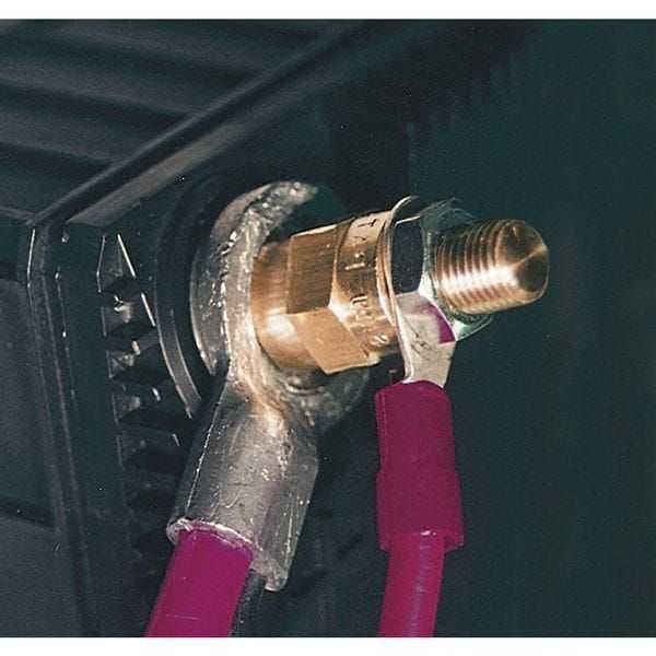

2000W amp and no upgrades to the electrical system? I would start there. Easy debug. Disconnect the amp and see if the problem goes away. Also I second the "check the grounds" comments above. On another car I had a bad engine ground that caused a large voltage drop.

This is the default terminals which seemed kind of shaky.
This is what I swapped it with so I could easily add a big 3 upgrade if needed. The terminals bite much better and the really snug down the main battery cable rings on both sides since the additional bolt really allows you to lock it down tight.
