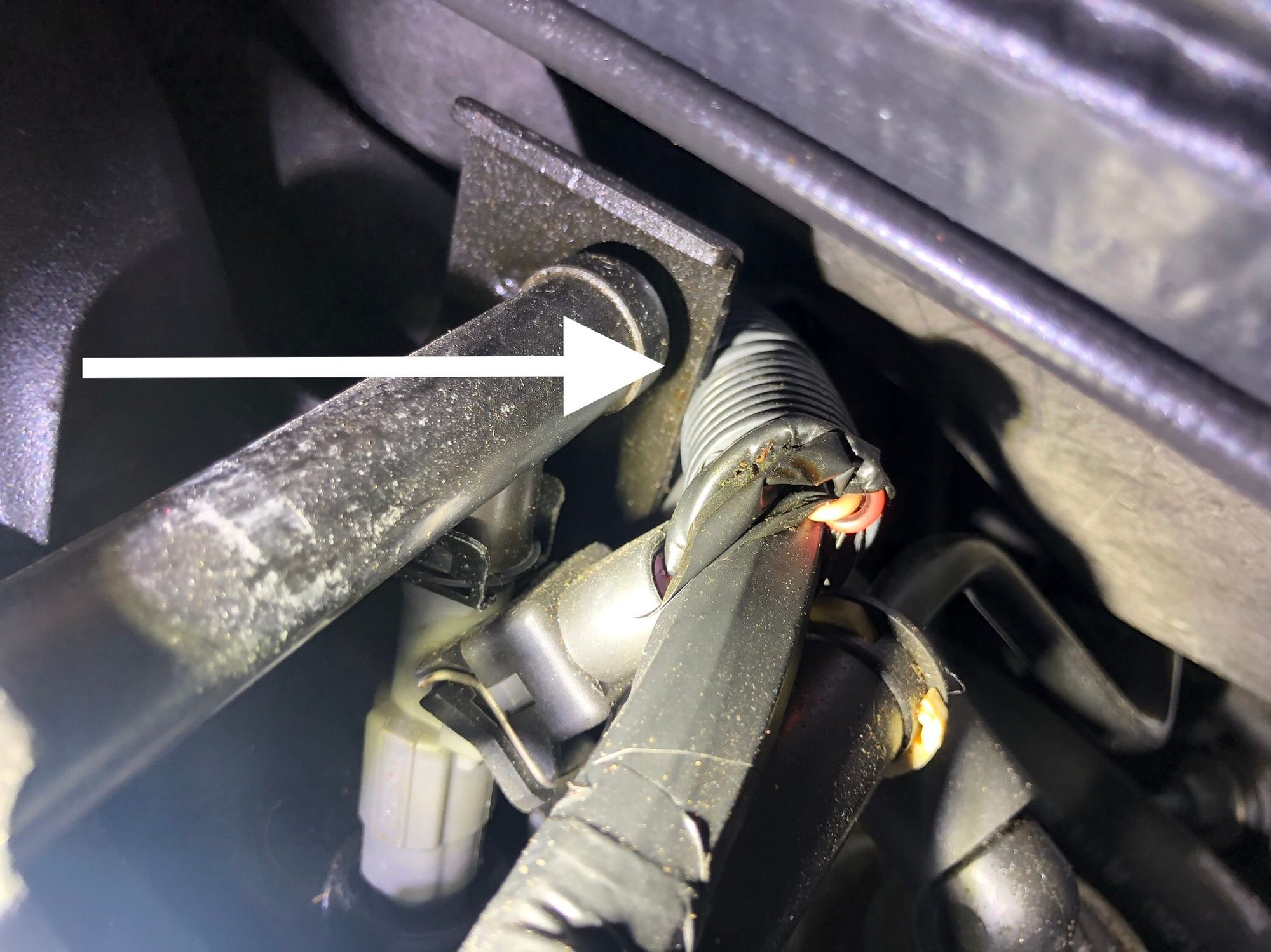

With the P1115 it’s either a bad ECT sensor or a wiring issue…it’s either an open or short to voltage in the wiring…with an open wire the PCM thinks the engine is cold and “giving it some choke” plainly speaking…most likely why you have to increase the RPM to 2500 to keep the car from stalling…the ECT is a simple 2 wire thermistor which has 5 volts on the signal wire when unplugged and the other wire is a ground….the sensor will pull that 5 volts to ground using the sensor and that is what the PCM is looking at to set the DTC…first follow the ECT wire harness up behind the alternator and then it joins a harness which then goes along side the left fuel rail and wraps around a metal bracket at the back of the fuel rail…chaffing does occur there so pull the harness away from the bracket and look for chaffed wires…if it looks OK remove the harness connector…you should see about -30 or so on the ECT gauge and 5 volts on the yellow wire…you should also remove the sensor and with an ohm meter check the resistance of the sensor in some water at different temperatures…if you get that far we will post the resistance vs. temperature chart for you !!..the pic shows the area of concern at the fuel rail.
