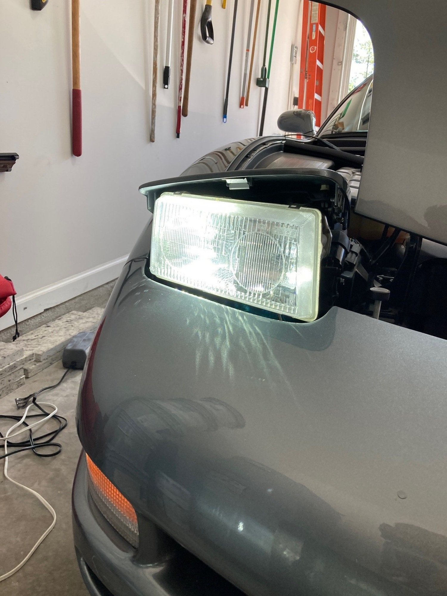

https://www.vette-lights.com/collect...-low-beam-leds
I put these inand they are huge improvement over stock.
Do you have pics of the actual bulbs? Wonder why it needs a resistor harness, too

Originally Posted by mrmce
do you have pics of the actual bulbs? Wonder why it needs a resistor harness, too
led

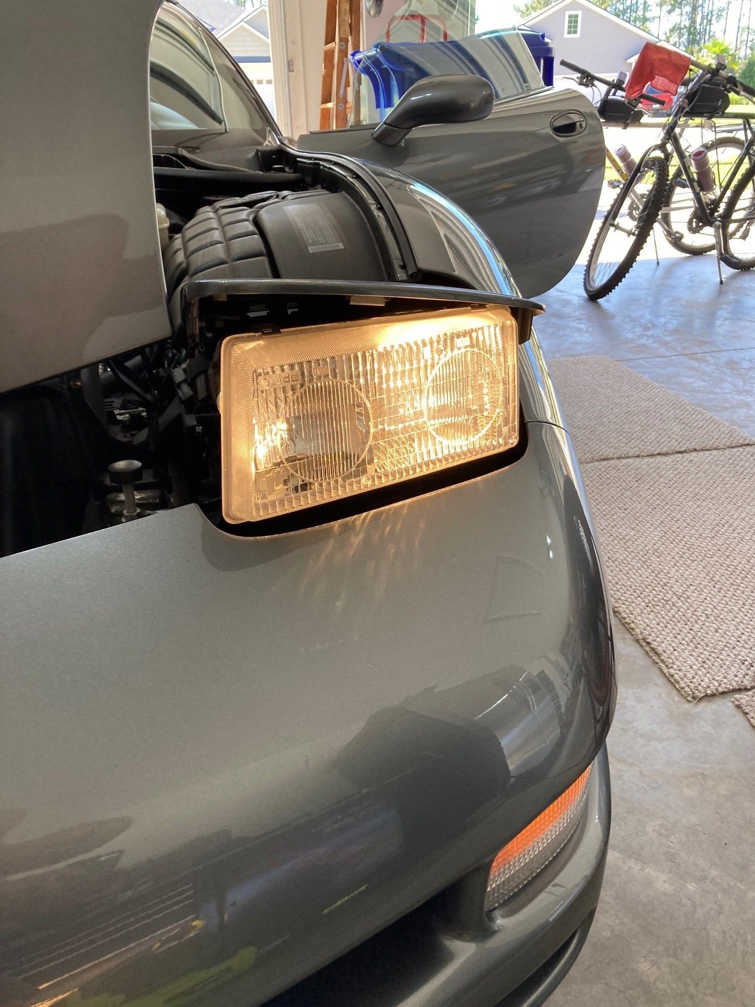

Default Halogen vs LED
led
Ok.... so you don't have pics of the actual bulbs? Curious why they don't show them on the site and how different they'd be if at all from the $30 sets on Amazon. Mine don't need external resistors and I don't have issues with closing.

I didn’t take pictures of them. These come with the ballast separate to keep the heat down.

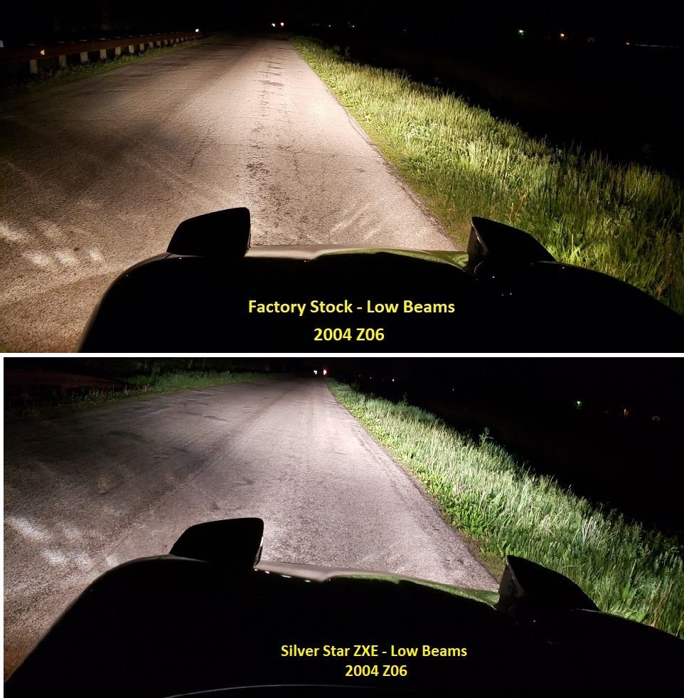

I did Silverstar zXe in both high and low and the 4eyeC5 kit. Results were pretty good for the cost. High beams are excellent and low beams are on par with my 2019 pickup w/projector lens. (I used a light meter from 6ft out to 100ft to verify)
