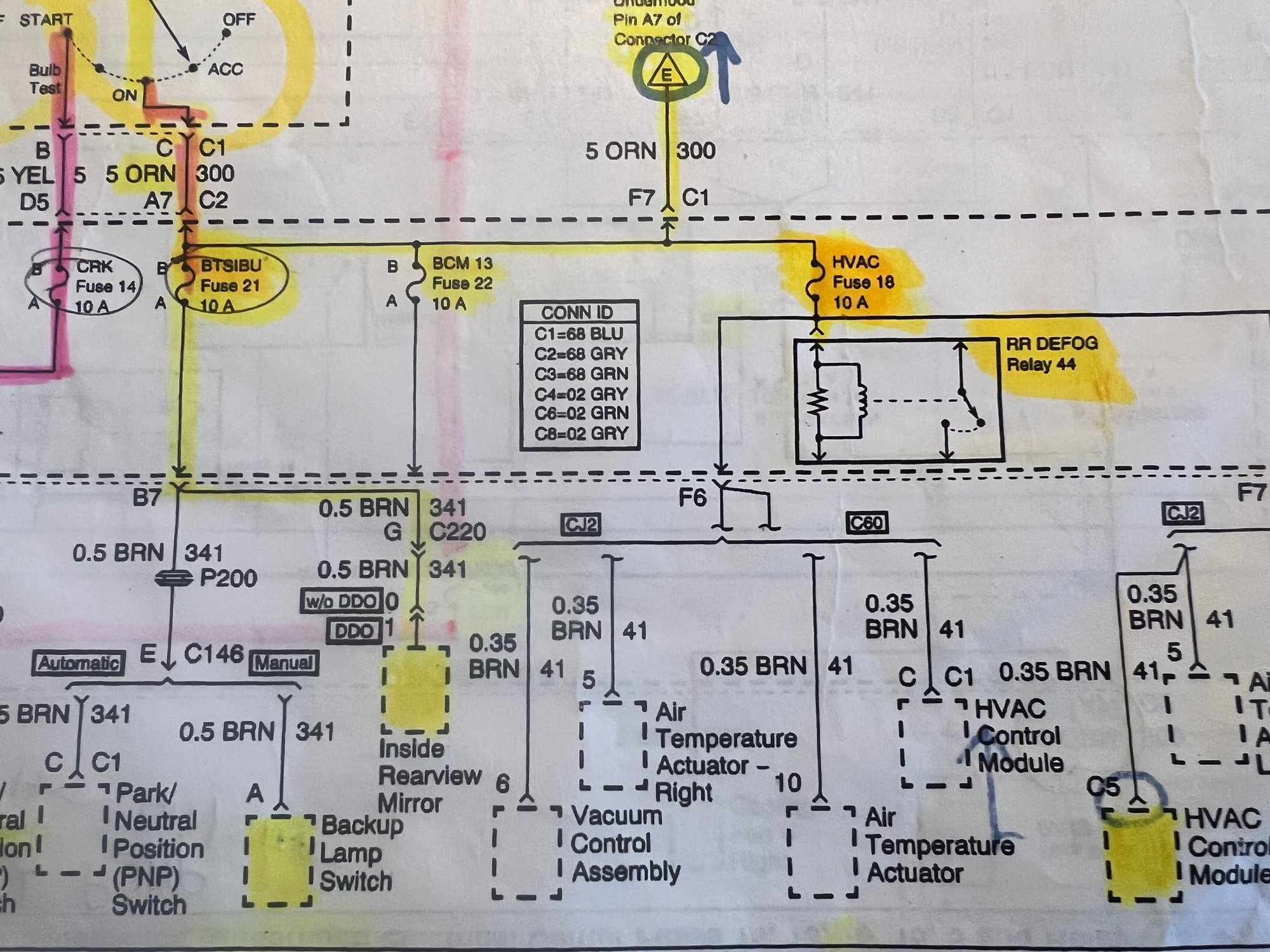

To answer question one sounds like an ignition switch issue…as in the picture the ignition switch orange wire feeds the HVAC module and a few other items…do you have a DVOM ??…I see you’re in central Florida…be glad to look at it for you if you want to make your way over to the west coast !!

Thanks so much for the reply and offer to help. I think you’re right. I should gain some experience with my multimeter and do some investigating. It could very well be both things.
