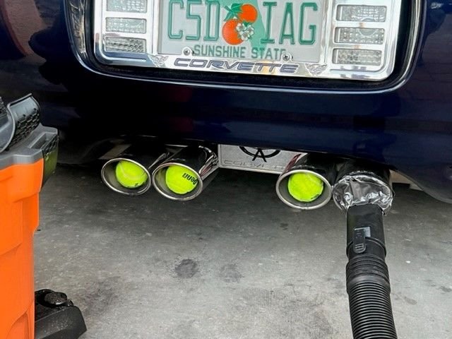

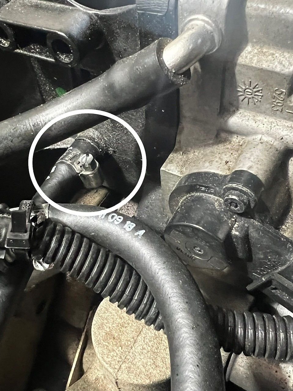

Casey, Do you have a scan tool or did you get these DTC's through the DIC ??...for your driveability issue I'd chase the P0151 which is a "C" or current code...you can have either a bad O2 sensor or wiring or something that is actually causing the O2 sensor "low voltage" or lean condition which means the engine computer is seeing less than 200mv on the O2 signal wire...this can also be a lean condition such as clogged injectors, exhaust leak, bad gas, a vacuum leak which MAY be the sound you are hearing...the sound would be more prevalent at idle when the throttle blade is closed and there is high engine vacuum then at wide open throttle when the vacuum is low...if you don't have a scan tool disconnect the PCV hose that is located behind the throttle body on the right side (see pic) and plug up the nipple coming off the manifold with a short piece of hose with the end plugged up...go for a ride and see what happens...there may be a big hole in the PCV hose...if you have a scan tool and can look at fuel trims we can go that route...I am moving this thread to Tech.

i got all the codes from the DIC, I will check the exhaust for leaks as it has been apart a few times and I didn't personally check to see if it was done correctly. I can disconnect and plug this PVC hose you have shown, but I'm not sure what I'm looking for when doing this. will this determine if that hose has a vacuum leak?.

after poking around, it looks like this is the pvc hose, its slightly different to the photo you have sent, probably due to year model of mine being older, should i just rip this out and plug it as you say. i have no scan tool handy, but could probably get one if it would help. cheers

I didn't know if you had a scan tool or not but if you did by plugging the PCV line to the manifold we can see if the fuel trims decrease denoting a vacuum leak...to check for an exhaust leak if you have a shop vac you can plug the hose into the other end so it blows air out and tape the hose to the exhaust (plug other 3 exhaust tips) and get a bottle with soapy water then turn the vac on and spray the suspected area…right cylinder bank in your case...I find this method works best !!...also remove the shop vac filter if you can too. Since you were playing with the exhaust system that would be the first place to look....also it really helps to own a scan tool to help diagnose issues with these cars !!

Just checking but, I am pretty sure C5 Diag meant that you could plug the PCV fitting TEMPORARLY just to see if it was the source of the noise. It almost sounded like you were just going to cap it off permentaly. You CAN NOT or should not run the engine very long without a properly functioning PCV system. Testing is fine.
Our early C5s (97-2000) have a weird PCV hose behind the intake manifold. It branches off into a Y fitting. That Y and the hose is well known that it will dry rot and CRACK, & split and make that weird noise, It can also cause a rough idle and LTFT issues.
