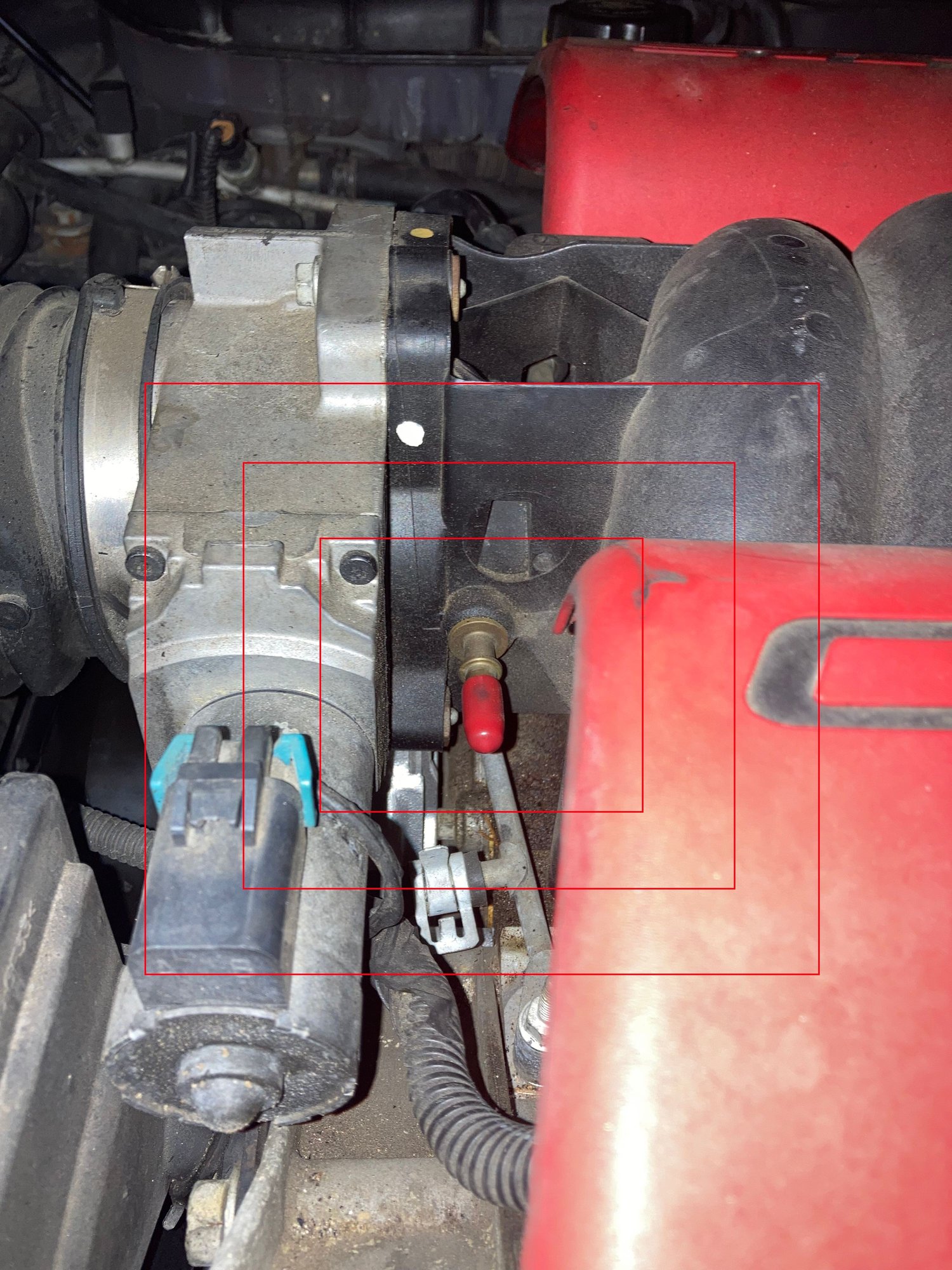

The red cover seems to be a temporary fix can anyone tell me where I get the actual part to replace this? What is that red part called that goes there?
Would this cause the jerking if it somehow slipped off again and its leaking?

That red cap is for the connection to the Evap Solenoid. The system was removed by the previous owner. Does your car have aftermarket headers? If not check to ensure the stock manifolds have a block off plate bolted on where the old flange for the EGR system bolted to the driver side manifold.

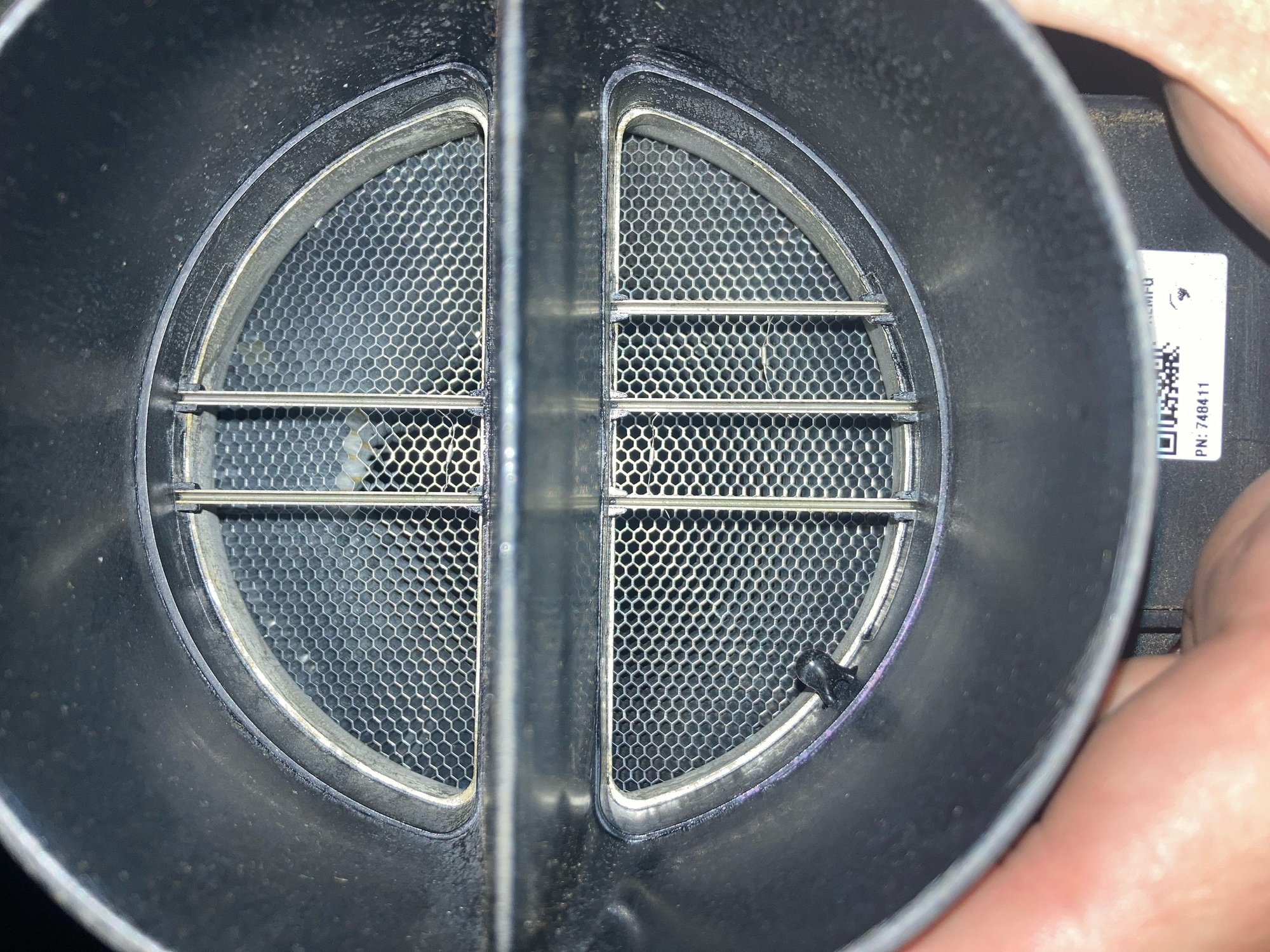

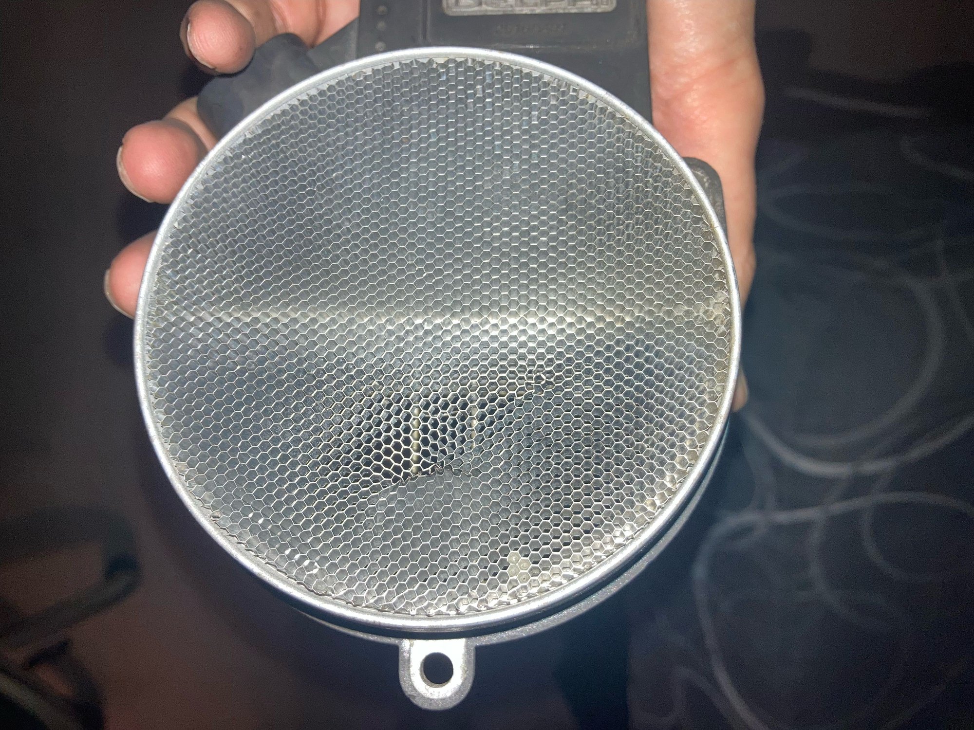

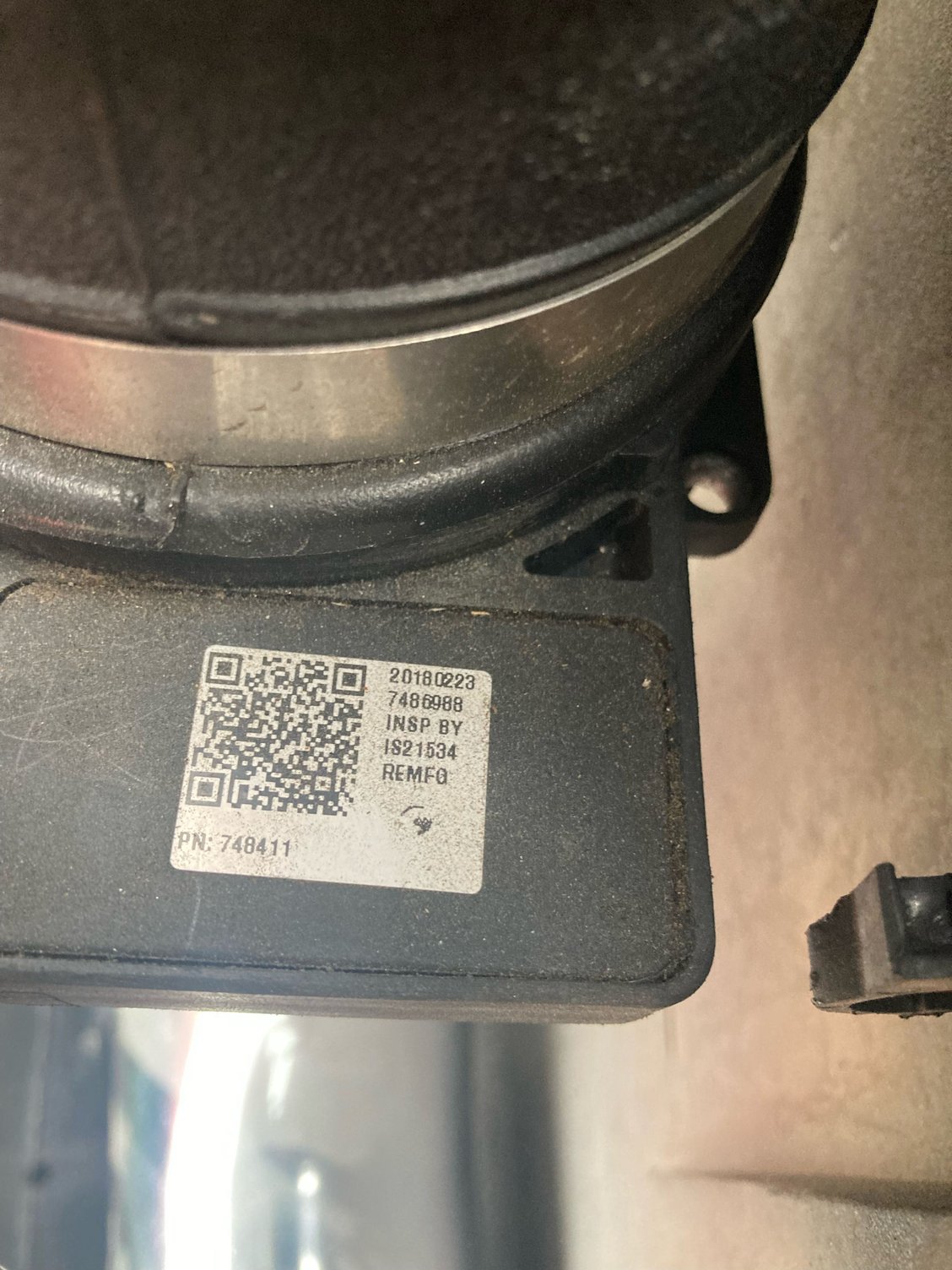

My Mass airflow sensor is possibly dirty, which explains why my car is jerking and hesitating. I bought a Delphi AF10043 for my 2001 Z06 it says 15821 on the sticker what does this mean.
The dephi AF10043 was $129.99
The blue streak was $84.99 is there any real difference between these two for the price difference.
The blue streak said 748411 on the label. The AF10043 has no P/N anywhere on it.
The P/N installed in my car is 748411, but when they ran the P/N at the auto parts store. They said this one was compatible with a 2001 Z06 corvette I just want to make sure.
I'm kind of hesitant to install it. Once you install a part. You cannot return it if it does not work.

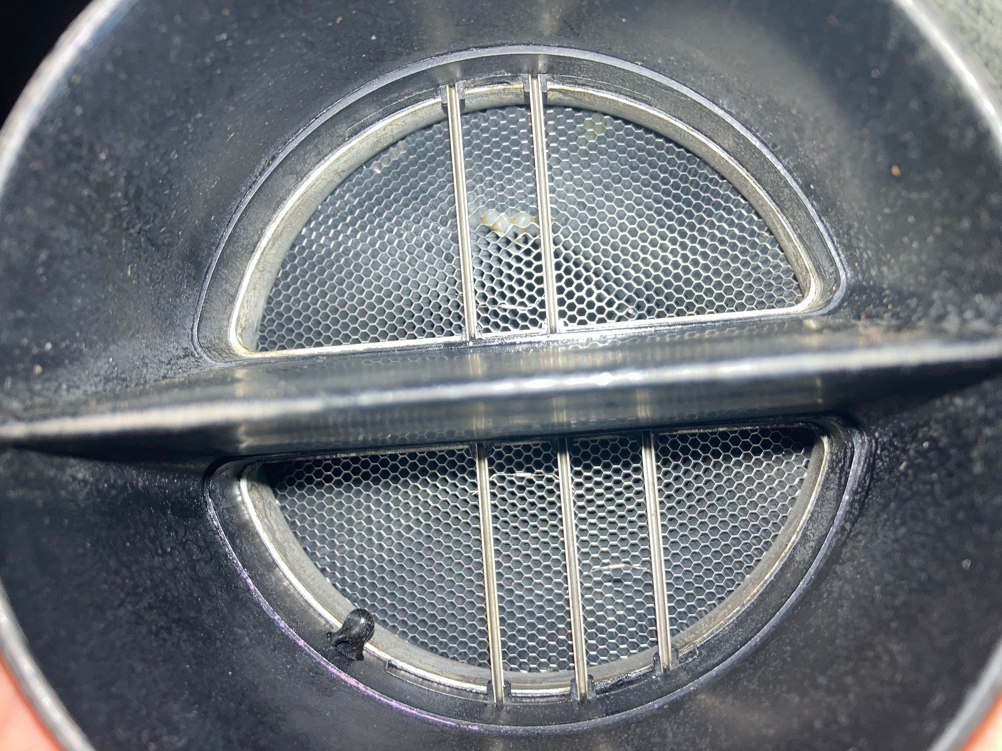

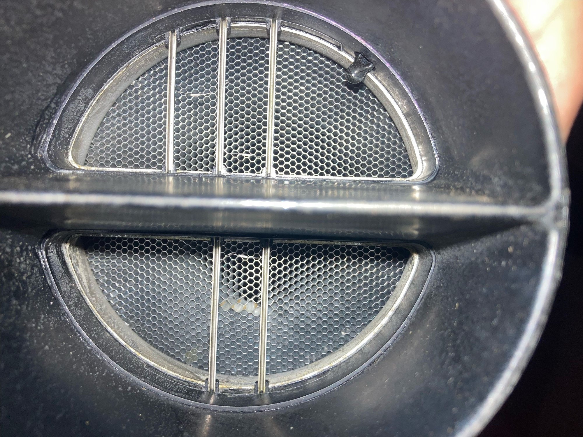

This right here is my current MAF that came with the car. Does this look okay or is it damaged?
I just put MAF sensor cleaner on it. I noticed when I removed it that somehow the honeycomb got damaged prior to removal. Is that honeycomb damage to substantial to be re-usable?

Leak between throttle body and air filter. The crimp clamps are a common culprit

This was exactly what it was. I put a new MAF sensor in, cleaned the filters, and re-secured all the clamps. Started the car and let it idle for 2-3 minutes before realizing I forgot to plug back in the MAF sensor cord. Oddly enough the car was drivable without the cord plugged in. It did not stall eventhough all youtube videos say it should die as soon as the cord is pulled. After 1 minute of driving and realizing it I stopped and plugged back in the MAF sensor cord.
