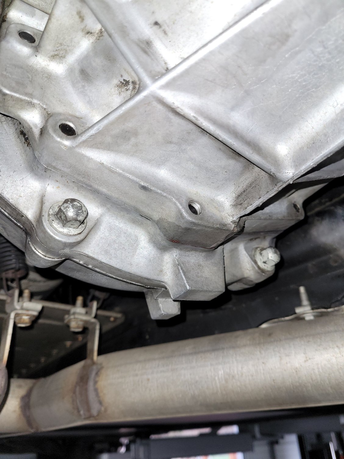

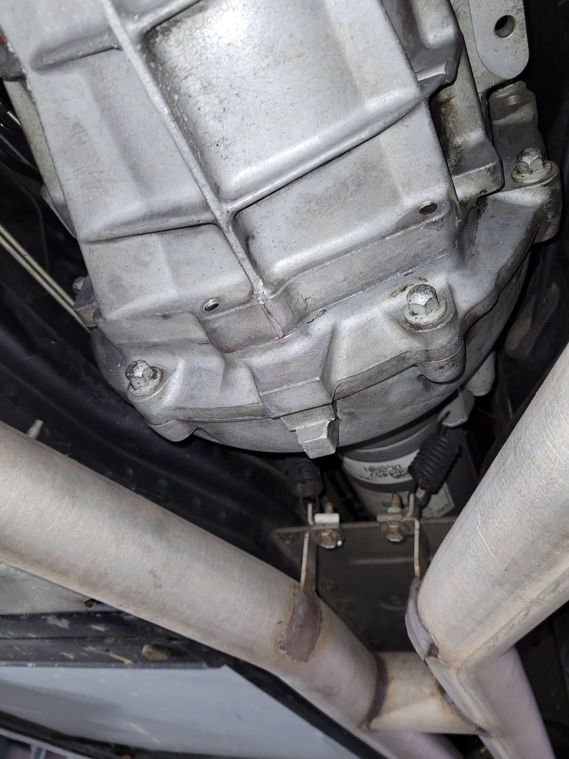

Hey all. Just picked up this 2002 z06. 73k miles. Got it on my lift. Noticed Trans had a very small leak turned into smudge all over the Trans case. Cleaned it all off, changed the fluid, and now 1 day later it's got a noticeable leak! Hasn't been started even, let alone driven.
See photos.
Can someone give me the rundown how to fix this?
I don't need to drop the transmission do I?
I have a lift in my shop.
I'm thinking drop the exhaust, remove the torque tube, then ???
TIA!!

It appears to be an input shaft seal leak however you cannot be certain until the transmission is separated from the torque tube. In order to remove the torque tube, you have to drop the entire driveline (torque tube, transmission, & differential). You should review the procedure in the service manual before embarking on this project. I've done this without a lift (not easy but manageable), with a lift the job is much easier.

It's either the input shaft leaking or the front plate leaking. Either one requires trans removal. You can get the plate off the front without scattering the whole transmission once it's out.

Thanks for the reply. im not sure, or an expert, but if it was the input shaft seal, i believe the leak would be coming from the joint forward of the leaking joint. either way, i have reviewed the info and the TT needs to come out, so the looks like the rear suspension cradle needs to be dropped. Good thing i have a lift. Not was i was hoping to do with my new old car! im thinking i will rebuild the TT while it's out, hopefully car does NOT need a new clutch
