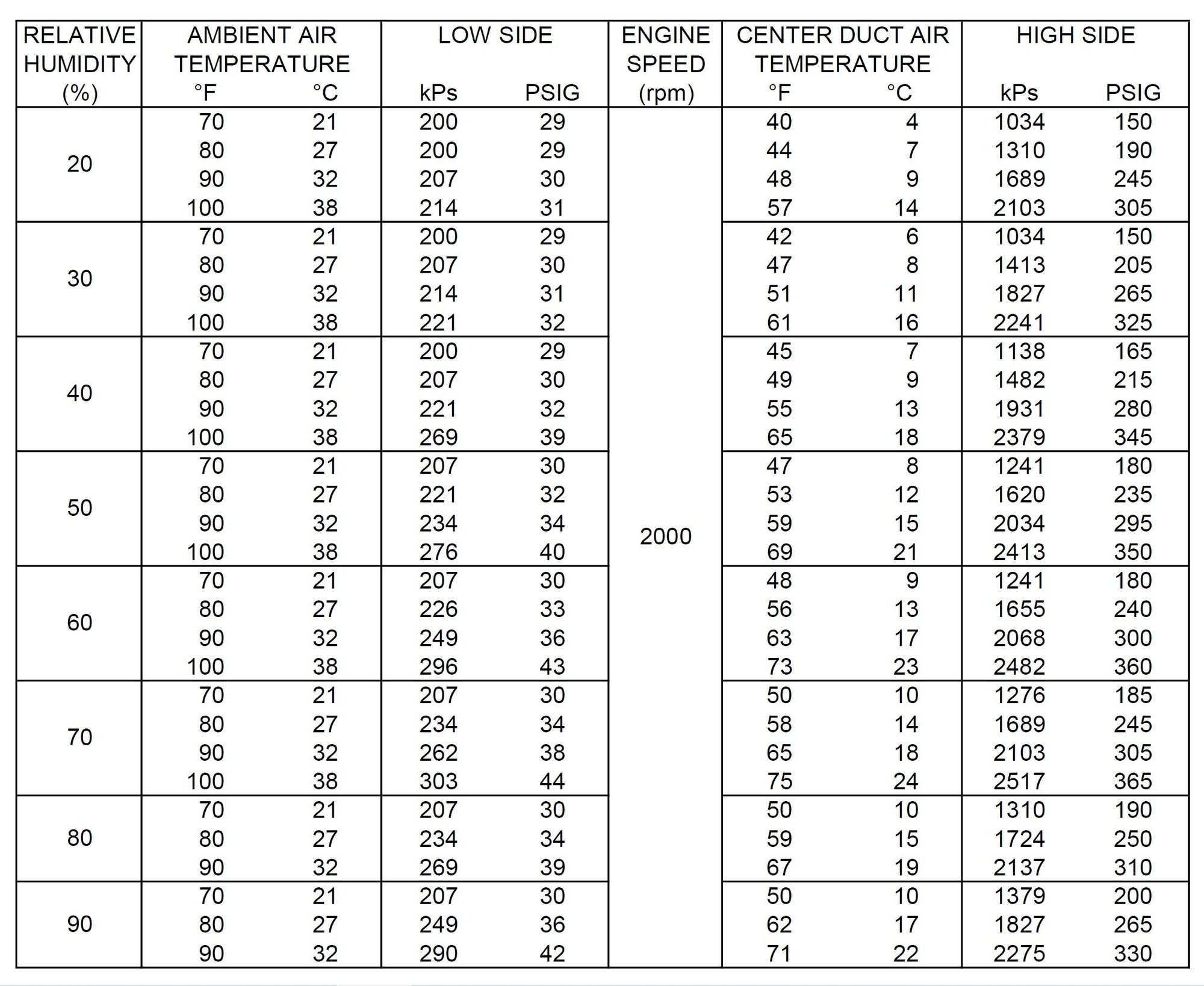

I don’t have one handy at the moment, but there are a number of charts that show exactly what center vent temperature you should be getting for the current environment you (well, the car) are experiencing. The charts do show specific conditions, such as windows down, max A/C (i.e. 60), 2000 RPM, etc.

This is a re-creation of an R134 pressure chart used several times on the forum -- I just redid it to be a bit more legible. 2000 RPM, windows down, temp. set to 60 or full cold, air inlet set to fresh, not recirculate.

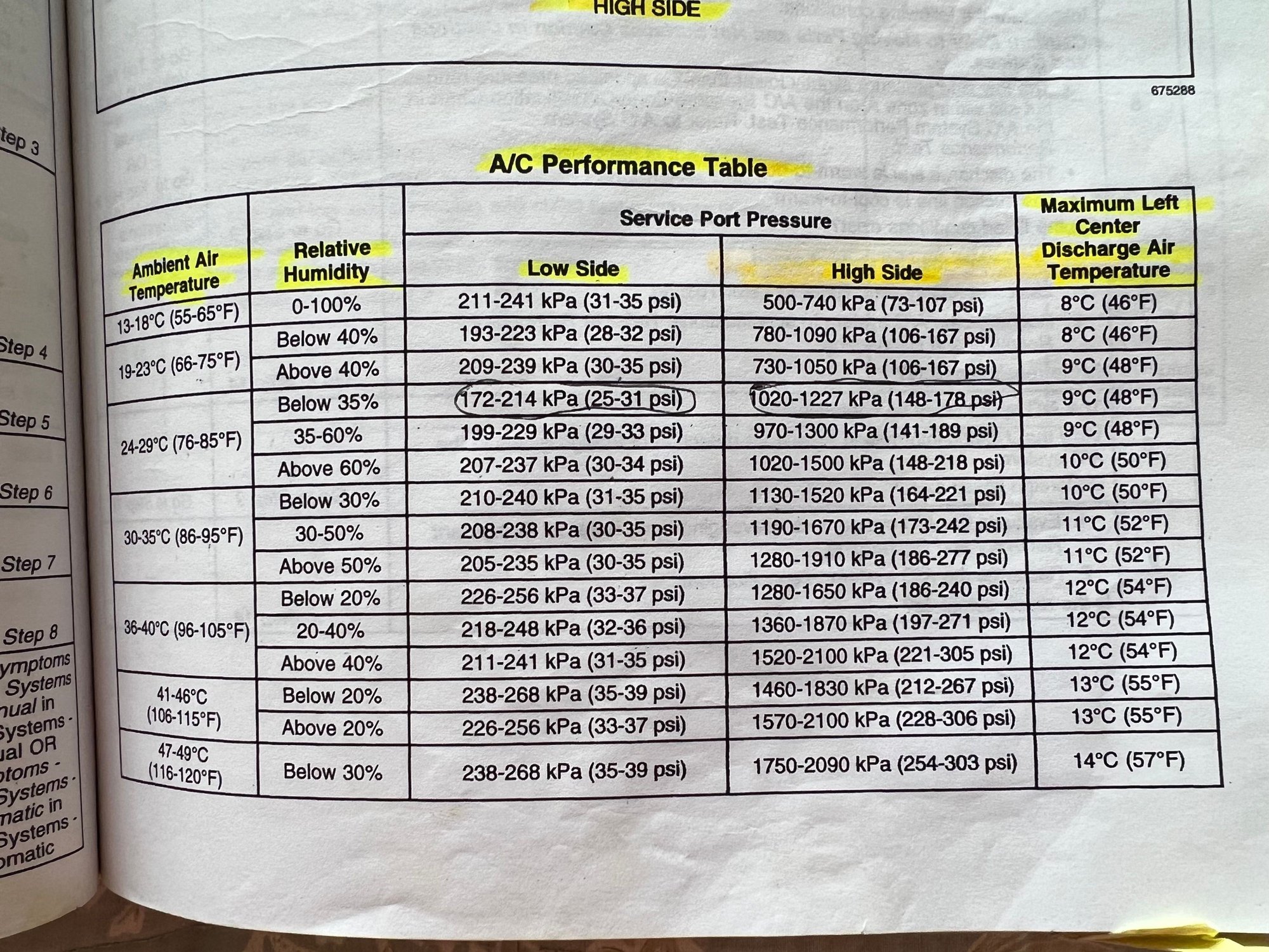

This is the FSM Performance Chart for an 01.

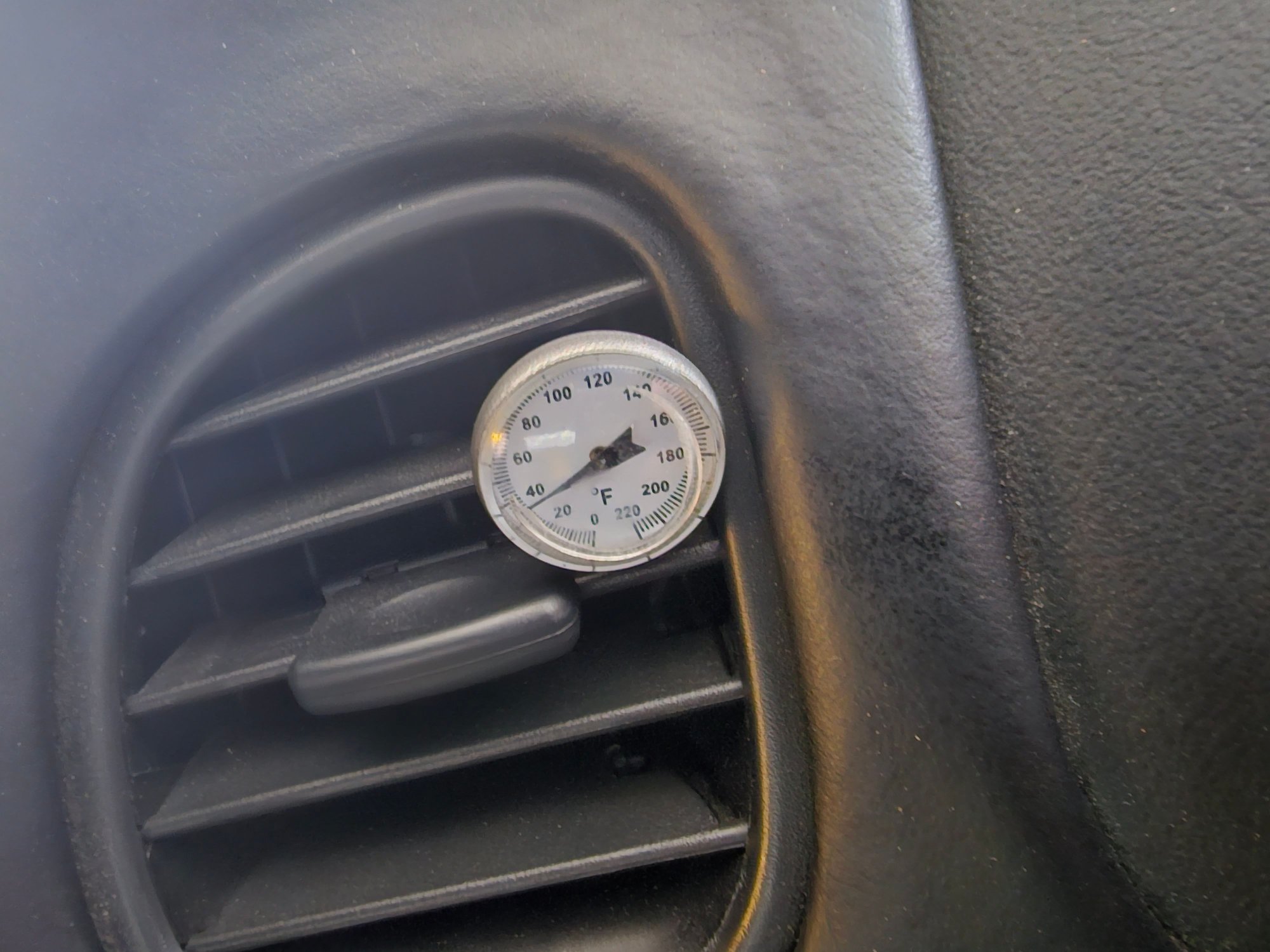

Thanks for the charts and the comparison values folks. I'm getting a vent thermometer in the next couple of days and will start checking what's coming out of each vent.
NOTE: Fixed my type-o from setting to 76 to 67. I agree 76 wouldn't do much to cool the car outside of exceptionally hot days.
