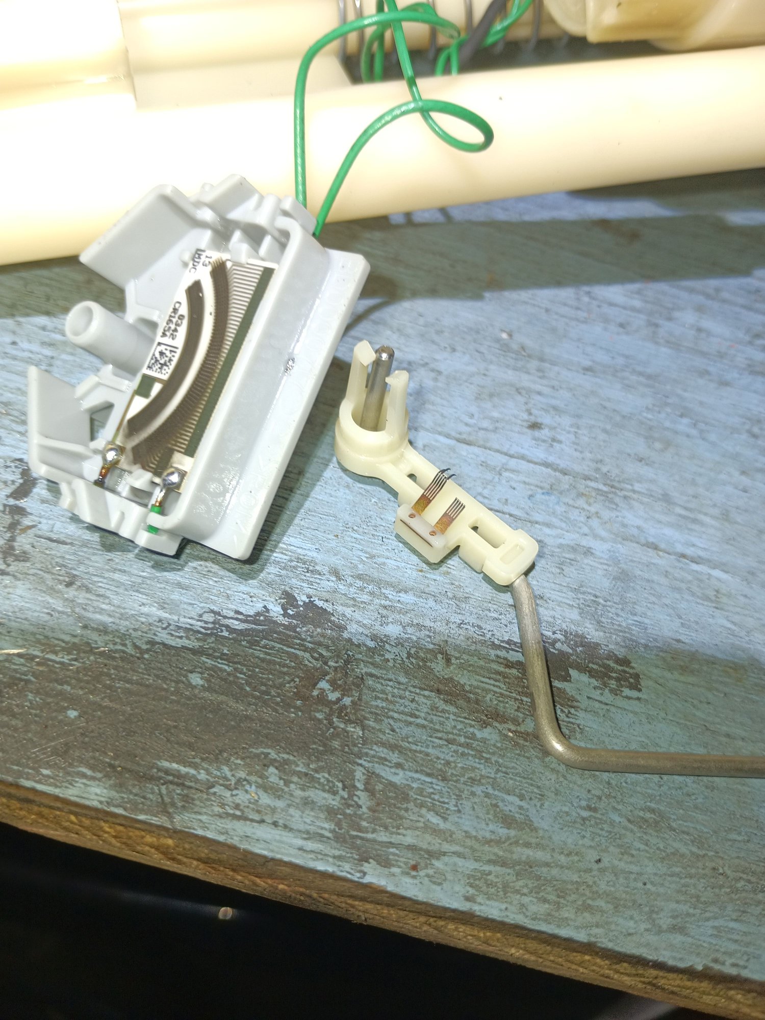

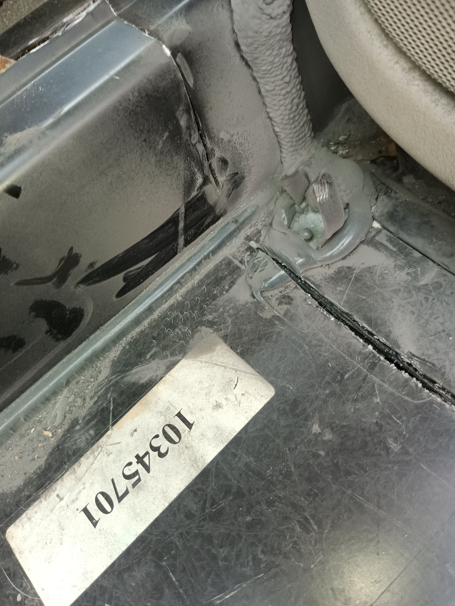

So just wanted to share this since I haven't seen anyone do this and I've read plenty of threads watched videos and even dropped the driver's fuel tank for sending unit replacement. After 2003 GM engineers came up with this fabulous location for sending units which conveniently they charge 1k -2k at the Stealership to replace.
I love my 2004 Vette but not that much and dropping one of the tanks is really a pain especially in an automatic.
I know these cars suffer from bad fuel level sending units and codes and erratic behavior of the fuel gauge. Techron and seafoam may work but if you have to go in there because it doesn't this may be worth a try.
You have to be very very very careful especially where the cross beam meets the tub of the hatch the tank is sometimes less than 1/4" away.
The great thing about this is once you do it to both sides you can access the units in a matter if minutes.
When cutting i used old scap plates of steel as a barrier between the cut and the tank.
Use a 4" cutting disc angle grinder for 90% of the cuts carefully. Use 1/8" drill bit to weaken the joint then finish with a oscillating tool to remove the panel.
Don't cut yourself like I did be careful with sharp edges and wear your PPE and have means of extinguishing nearby.
I will be fabricating a cover plate in galvanized steel that will be covering the area with 8 threaded bolts and structural adhesive.
The main reason this was done was to correct a P0268 code and a dancing fuel gauge.
This was inspired by many foreign vehicles that are designed to have access panels in the body for sending unit service. {Not like the folks at GM}

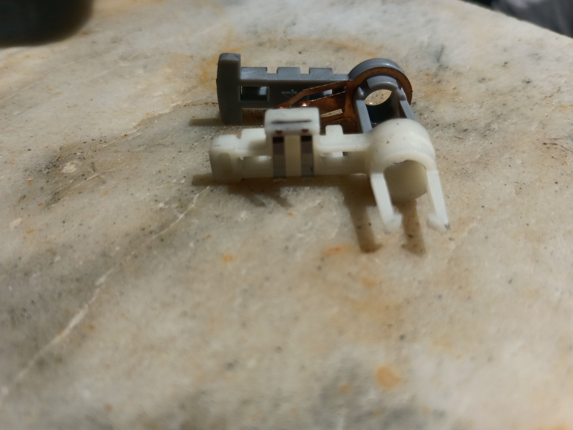

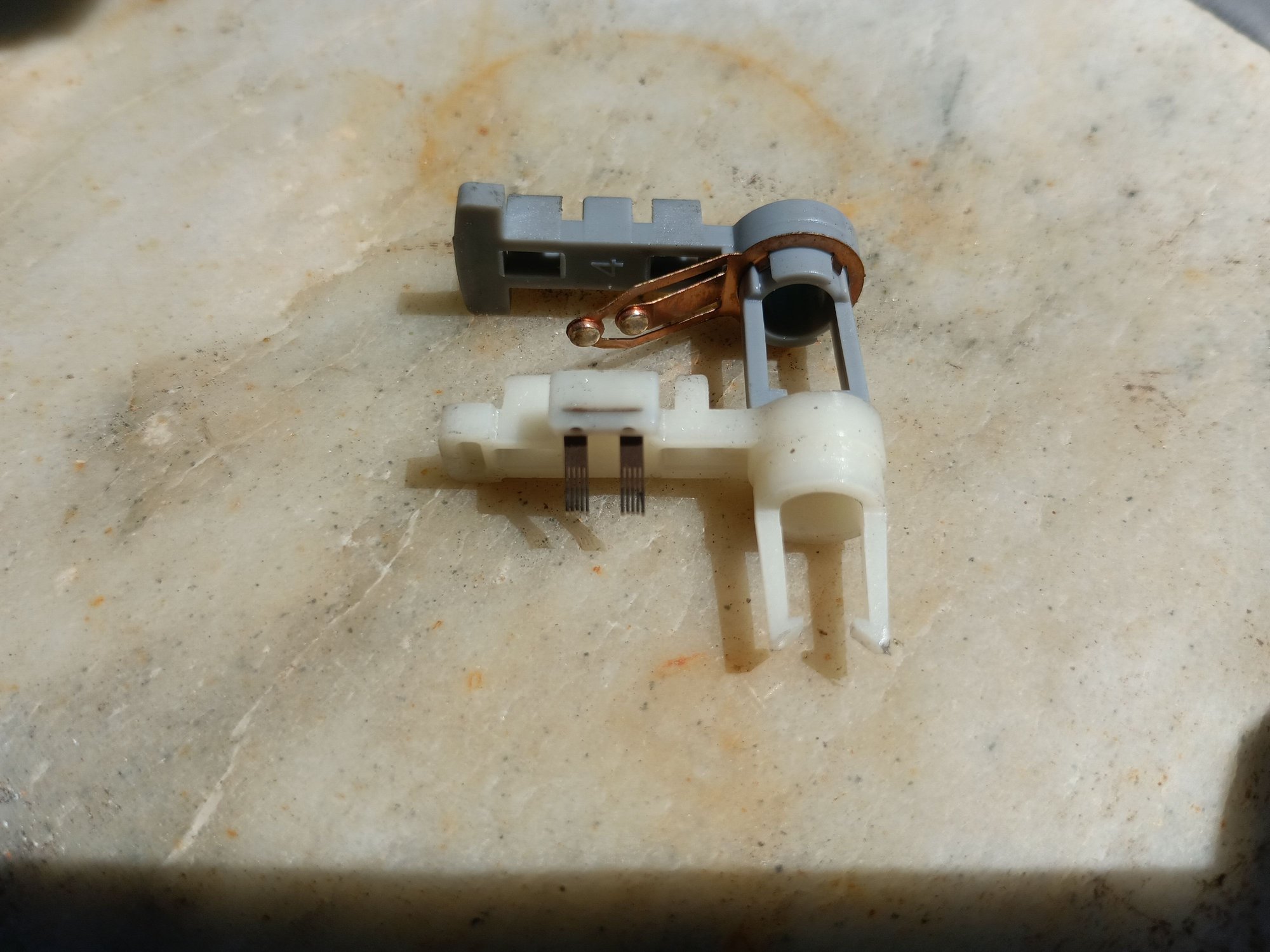

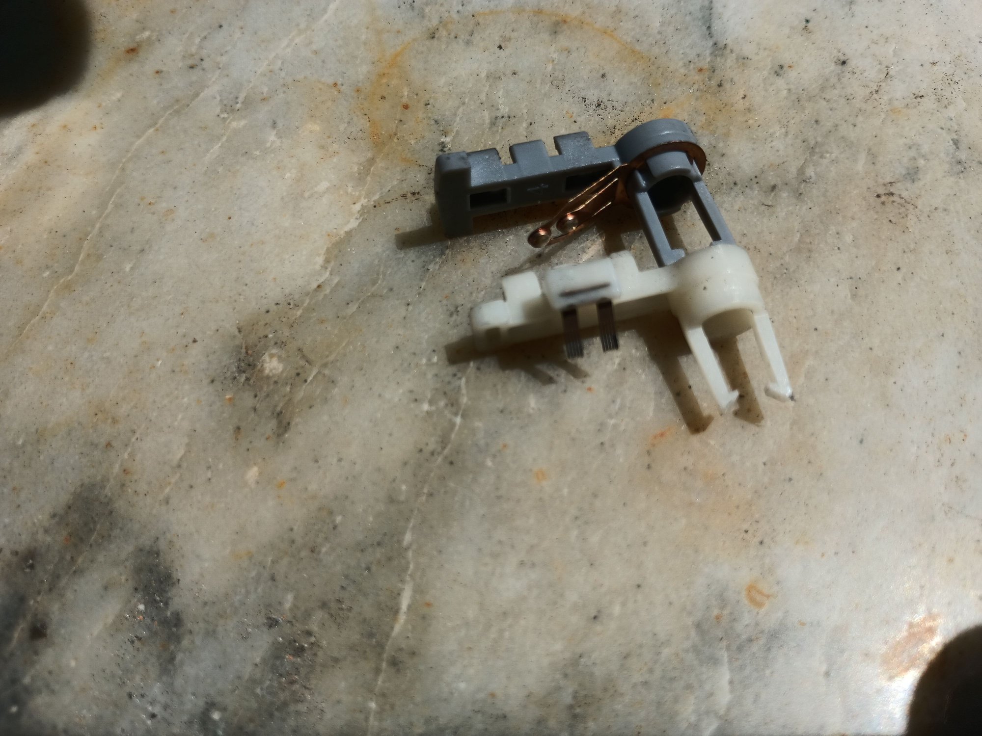

More pics. So the code issue is driven by damaged brushes on the sensing unit. My solution cost zero dollars to fix. It involved trimming the other brush bending them down further so that the shorter brushes now touch and curling the tips for a smooth glide. With the shorter brushes I noticed they would be out of range if the tank was full so I placed a little stopper so that the float arm would drain before the brushes were out of range on the upper side. On the empty range they had the opposite problem because they don't reach the lowest point but it doesn't affect the reading much. I went ahead and also created the access panel on the driver's side. So far so good 👍 I'll report back if there's any issues.
Enjoy..

I'm thankful my 03Z has pumps on the bottom. If I had the later fuel system, this MAY have been on my list to do.
How did you know where to locate the cuts?

There's a couple profiles on the hatch deck that I followed and then the other area by the beam I kinda figured based on what I saw through the passenger side wheel well inspection hole.

Absent a template, You can use the circles and lines cast into the fiberglass as a guide (Based on the pictures in this thread). You don't need precision, just careful shallow cutting to do it. When you're done, you can glass it back together. If I ever have to replace the pump, that's what I'll do, since I got the same estimate as you to drop both tanks and replace the pump/sending unit.
